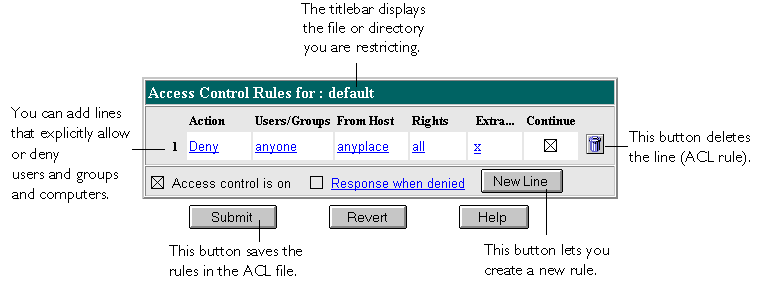

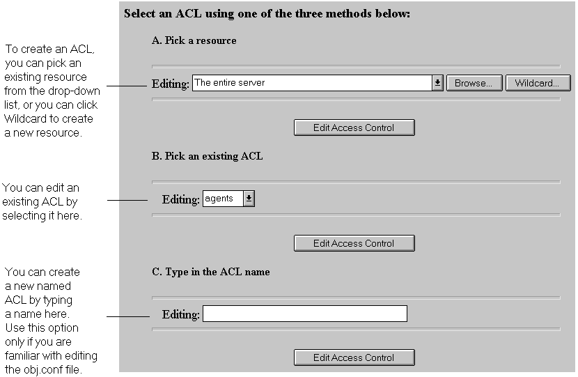

To create an access-control rule, do the following:
- Specify the part of your Compass Server (the resource) that you want to control. For example, you can select Entire Server to set up access control for your entire server.
- Click the Edit Access Control button. The right frame divides into two frames that you use to set the access control rules. If the resource you chose already has access control, the rules will appear in the top frame. The following figure briefly describes the form elements.
Figure 9.2 The ACL form contains links that, when clicked, display another form in the bottom frame (not shown).
- Click the New Line button. This adds a default ACL rule to the bottom row of the table. You can use the up and down arrows in the left column to move the rule, if needed.
- Select the action you want to apply to the rule by clicking the Deny link. The bottom frame displays a form where you can check if you want to deny or allow access to the users, groups, or hosts you'll specify in the following steps. Check the option you want, and then click Update.
- Specify User-Group authentication by clicking the "anyone" link listed under the Users/Groups column. The bottom frame displays a form for configuring User-Group authentication. By default, there is no authentication, meaning anyone can access the resource.
Check the options you want, and then click Update.
- Specify the computers you want to include in the rule by clicking the "anyplace" link. The bottom frame displays a form where you can enter wildcard patterns of host names or IP addresses to allow or deny.
- Specify the access rights you want to include in the rule by clicking the "all" link. Check the access rights in the bottom frame, and then click Update.
- If you are familiar with ACL files, you can enter a customized ACL entry by clicking X under the Extra column. This area is useful if you use the access control API to customize ACLs.
- Check Continue if you want the access-control rule to continue in a chain. This means the next line is evaluated before the server determines if the user is allowed access. When creating multiple lines in an access-control entry, it's best to work from the most general restrictions to the most specific ones.
- Repeat steps 4 through 10 for each rule you need. If you want the user to be redirected to another URL if their request is denied, check "Response when denied." Click the link to specify the URL for redirection.
- Click the Submit button to store the new access-control rules in the ACL file. If you click Revert, the server removes any changes you made to the rules from the time you first opened the two-frame window. Be cautious when using Revert because you can't restore your edits. In most cases, it's probably better to delete the rule lines individually.
