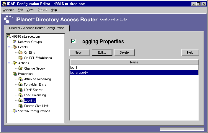

Access the iDAR Configuration Editor Console; see Accessing the iDAR Consoles.
In the navigation tree, expand the Properties node, and then select Logging.
Click New to define a new object.
In the Name field, type a name for the object. The name must be a unique alphanumeric string.

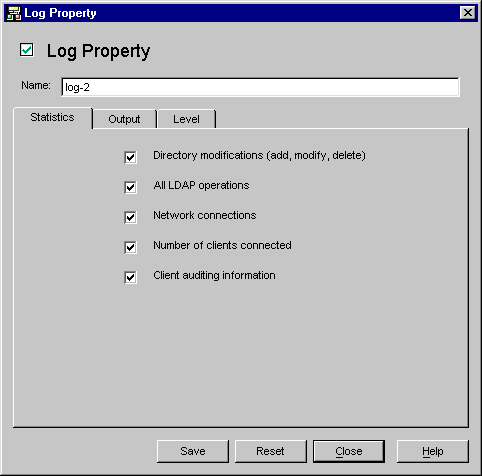

In the Statistics tab, specify the kind of information to be logged.
Select the Output tab and specify where log entries should be sent and whether to log audit traces.
- Check the boxes referring to the type of logging messages desired. By default none of the options are selected. Log messages are classified into the following groups: directory modifications, all LDAP operations, network connections, number of clients connected, and client auditing information.
- Directory modifications. Statistics about operations that write to the directory, like add, modify, and delete will be logged.
- All LDAP operations. Statistics about all LDAP operations will be logged.
- Network connections. Statistics about network connections will be logged.
- Number of clients connected. General statistics such as how many clients are connected will be logged.
- Client auditing information. Audit information such as the DN of client that just completed a bind/unbind will be logged.

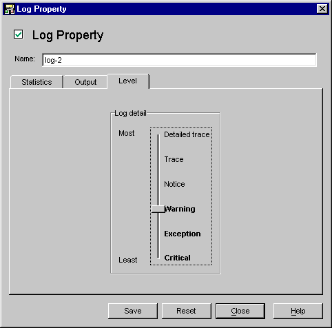

Select the Level tab and specify the log levelthe amount of logging detail desired.
- Log file. Displays options governing where iDAR will write its log entries.
- Write log entries to $(IDAR_ROOT)/logs/fwd.log. This is the default setting in which iDAR will write its log entries to the file $(IDAR_ROOT)/logs/fwd.log where $(IDAR_ROOT) is the directory under the server root where iDAR is installed, typically /usr/iplanet/servers/idar-<hostname> or \Program\Files\iPlanet\Servers\idar-<hostname>.
- Write log entries to. Specify an alternative file to which iDAR will direct its log entries. The file separator must follow UNIX conventions regardless of platform.
- Write logs to syslog daemon with facility. (UNIX only) Choose a syslog facility code that iDAR will use to log entries. This setting should only be chosen if this log property is to be used by iDAR server installed on a UNIX machine. Specifying this option for iDAR installed on a Windows NT system will make it inoperable. It is recommended that if you would like to specify values for this attribute, you should create separate log properties for Windows NT and UNIX.
- Audit File. Displays options governing where iDAR will write its audit log entries. For this feature to work, audit logging must be enabled by selecting the "Client auditing information" option in the Statistics tab.
- Write audit entries with other log entries. This is the default setting in which iDAR will write its audit log entries to the same output specified in the log file settings above.
- Write log entries to. Specify an alternative file to which iDAR will direct its audit log entries. The file separator should follow UNIX conventions regardless of platform.
- Write audits to syslog daemon with facility. (UNIX only) Choose a syslog facility code that iDAR will use to log audit entries. This setting should only be chosen if this log property is to be used by iDAR servers hosted on a UNIX machine. Specifying this option causes a Windows NT based iDAR to become inoperable. It is recommended that if you would like to specify values for this attribute, you should create separate Log Property objects for Windows NT and UNIX.

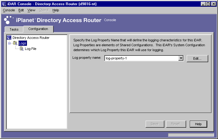

Access the iDAR Server Console; see Accessing the iDAR Consoles.
Select the Configuration tab, and then, in the navigation tree, select Logs.
In the "Log property name" drop-down list, select the property you want to use.
- The right pane shows information regarding the log property specified by the current system property.
Click Save to save your changes.
- To verify that you're using the correct property, click Edit and take a look at the configuration. If required, you can make any configuration changes.
Select the Tasks tab and restart the server; see Restarting iDAR.
- iDAR is now configured to log messages as defined in the configuration. The iDAR configuration is modified, and you are prompted to restart the server.
