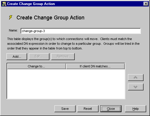

You can create objects for actions that needs to be executed when certain events occur. The instructions below explain how to create an action object for changing groups.To create an action object for a client to change from one group to another:
Access the iDAR Configuration Editor Console; see Accessing the iDAR Consoles.
In the navigation tree, expand the Actions node, and then, select Change Group.
Click New.
In the Name field, type a name for the object. The name must be a unique alphanumeric string.
In the Action tab, select the action to be performed when the event occurs (that is, when the event evaluates to TRUE).
Click Save to create the action object.
- Change Table. Displays a list of groups to which a client can change. For a change to occur, the client must match a DN expression associated with each group. To edit the DN expression associated with a particular group or "no change" entry, click the "If client DN matches" column in the table. The list is evaluated from top to bottom until a DN expression is matched. Therefore, it is important that the most general DN expression is at the bottom of the list so that all expressions will be evaluated.
- Regular expressions must be normalized, that is, there should be no spaces in between RDN components and the equal to (=) sign, all attribute names and values must be capitalized.
- You can use the following book as a reference on regular expressions: Mastering Regular Expressions, by Friedl and Oram, published by O'Reilly, ISBN: 1565922573.
- Add. Displays a menu for adding a group to which a client connection could potentially change. Group change entries can be of the following types: "Group change entry," or "No change entry."
- Group change entry. Displays a dialog for selecting a network group to which a client will change depending on whether or not the associated DN expression evaluates to TRUE.
- No change entry. Adds a row to the table indicating that NO change should occur if the associated DN expression evaluates to TRUE. This is useful in providing a "short circuit" of the evaluation of the change group list.
- Edit. Displays a dialog for editing the currently-selected entry in the table.
- Remove. Removes the currently-selected entry in the table.
Repeat Step 3 through Step 6 to create any additional objects.

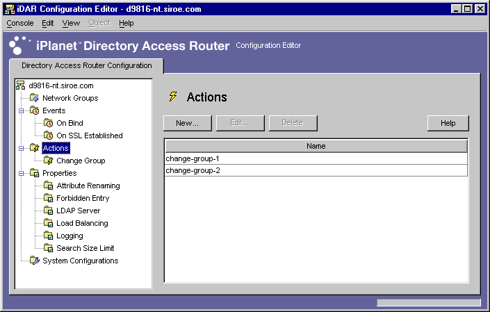

In the navigation tree, select Actions.
In the list, select the action object you want to modify and click Edit.
Make the required modifications.
Click Save to save your changes.
Repeat Step 3 through Step 5 to modify any additional objects.
- The iDAR configuration is modified, and you are prompted to restart the servers that rely on this configuration. Don't restart the servers yet. You can do this after you've completed all the configuration changes.
Restart the servers; see Restarting iDAR.

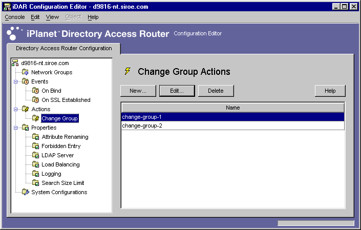

Deleting Action Objects
You can delete any unwanted action objects from the iDAR configuration. Before deleting an action object, make sure that it's not used in the configuration of any event objects.
In the list, select the action you want to delete and click Delete.
Repeat Step 3 and Step 4 to delete any additional objects.
- The name of the object you deleted is now removed from the list. The iDAR configuration is modified, and you are prompted to restart the servers that rely on this configuration. Don't restart the servers yet. You can do this after you've completed all the configuration changes.
