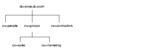

You can store different pieces of your directory tree in different databases, and then distribute these databases across multiple servers. Your directory tree contains branch points called nodes. These nodes can either be associated with databases or not. You create nodes using the Directory tab in the Directory Server Console, where you freely edit the entries that appear in your directory tree.A suffix is a node of your directory tree associated with a particular database. You create these special nodes using the Database tab on the Directory Server Console. For example, a simple directory tree might appear as follows:
The ou=people suffix and all the entries and nodes below it might be stored in one database, the ou=groups suffix on another database, and the ou=contractors suffix on yet another database.

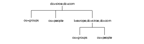

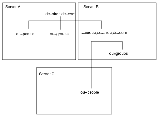

You can create both root and sub suffixes to organize the contents of your directory tree. A root suffix is the parent of a sub suffix. It can be part of a larger tree you have designed for your directory server. A sub suffix is a branch underneath a root suffix. The data for root and sub suffixes are contained by databases.Your directory might contain more than one root suffix. For example, an ISP might host several websites, one for siroe.com and one for i-zed.com. The ISP would create two root suffixes, one corresponding to the dc=siroe,dc=com naming context and one corresponding to the dc=i-zed,dc=com naming context. The directory tree appears as follows:

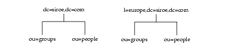

You can also create root suffixes to exclude portions of your directory tree from search operations. For example, siroe.com Corporation might want to exclude their European office from a search on the general siroe.com Corporation directory. To do this, they create two root suffixes. One root suffix corresponds to the general siroe.com Corporation directory tree, dc=siroe,dc=com, and one root suffix corresponds to the European branch of their directory tree, l=europe,dc=siroe,dc=com. From a client application's perspective, the directory tree looks as follows:
Searches performed by client applications on the dc=siroe,dc=com branch of siroe.com Corporation's directory will not return entries from the l=europe,dc=siroe,dc=com branch of the directory, as it is a separate root suffix.
If siroe.com Corporation decides that they want to include the entries in the European branch of their directory tree in general searches, they would make the European branch a sub suffix of the general branch. To do this, they create a root suffix siroe.com Corporation, dc=siroe,dc=com, and then create a sub suffix beneath it for their European directory entries, l=europe,dc=siroe,dc=com. From a client application's perspective, the directory tree would appear as follows:

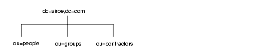

One database per suffix.
Multiple databases for one suffix.

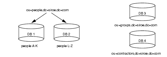

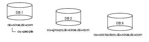

- The data for each suffix is contained in a separate database. For example, your directory tree appears as follows:
- You add three databases to store the data contained in your separate suffixes as follows:
- This division of the tree corresponds to three databases as follows:
- Database one contains the data for ou=people plus the data for dc=siroe,dc=com, so that clients can conduct searches based at dc=siroe,dc=com. Database two contains the data for ou=groups, and database three contains the data for ou=contractors.
- For example, suppose the number of entries in the ou=people branch of your directory tree is so large that you need two databases to store them. In this case, the data contained by ou=people could be distributed across two databases. This is illustrated as follows:
- Database one contains people with names from A-K and database two contains people with names from L-Z. Database three contains the ou=groups data, and database four contains the ou=contractors data.
- You need to use the custom distribution plug-in to distribute data from a single suffix across multiple databases. Contact iPlanet Professional Services for information on how to create distribution logic for your directory server. For more information about Professional Services, go to http://www.iplanet.com/services/l.

Adding Multiple Databases for a Single Suffix
You can distribute a single suffix across multiple databases. However, to distribute the suffix you need to create a custom distribution function to extend the directory. For more information on creating a custom distribution function, contact iPlanet Professional Services. For more information about Professional Services, go to http://www.iplanet.com/services/l.
Once iPlanet Professional Services has helped you create a custom distribution logic plug-in, you need to add it to your directory. The following procedures describe adding distribution logic to a suffix in your directory.
Adding the Custom Distribution Function to a Suffix
The distribution logic is a function declared in a suffix. This function is called for every operation reaching this suffix, including subtree search operations that start above the suffix. You can insert a distribution function into a suffix using both the console and the command line.For information about creating your own custom distribution logic, contact iPlanet Professional Services.

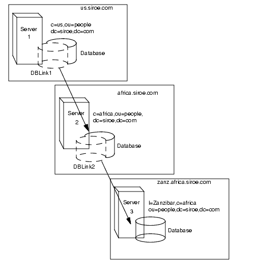

Creating and Maintaining Database Links
Chaining is a method by which a server contacts other servers on behalf of a client application and then returns the combined results. This method is implemented through the database link. A database link points to data stored remotely. When a client application requests data from a database link, the database link retrieves the data from the remote database and returns it to the client.The following sections describe how to create and configure a database link. For more general information about chaining, refer to "Designing the Directory Topology" in iPlanet Directory Server Deployment Guide.
You can create and configure a database link using Directory Server Console or the command line. The following sections describe the procedures for creating and maintaining a database link:

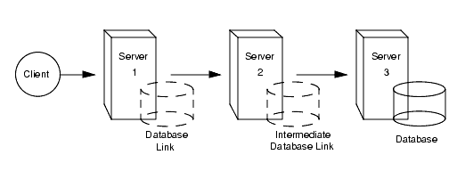

Chaining LDAP Controls
You can choose to not chain operation requests made by LDAP controls. By default, requests made by the following controls are forwarded to the remote server by the database link:
Managed DSA - This controls returns smart referrals as entries rather than following the referral. This allows you to change or delete the smart referral itself.
The following sections describe how to alter the controls that the database link forwards using the console and from command line.Loop detection - This control keeps track of the number of times the server chains with another server. When the count reaches a number you configure, a loop is detected and the client application is notified.
Server side sorting - This control sorts entries according to their attribute values.
- For more information about using this control, refer to "Detecting Loops".

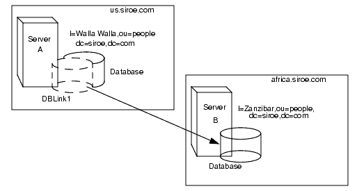

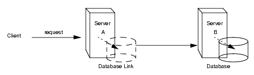

Creating a New Database Link
The basic configuration of your database link involves providing the following information:Suffix information. You create a suffix in your directory tree that is managed by the database link, not a regular database. This suffix corresponds to the suffix on the remote server that contains the data.
Bind credentials. When the database link binds to a remote server, it impersonates a user. You need to specify the DN and the credentials you want each database link to use to bind with remote servers.
LDAP URL. You provide the LDAP URL of the remote server to which the database link connects.
List of failover servers. You can provide a list of alternative servers for the database link to contact in the event of a failure. This configuration item is optional.
The following sections describe creating a new database link from the Directory Server Console as well as the command line.

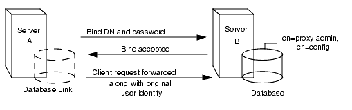

Providing Bind Credentials
For a request from a client application to be chained to a remote server, you can provide special bind credentials for the client application. This gives the remote server the proxied authorization rights needed to chain operations. If you do not specify bind credentials, the database link binds to the remote server as anonymous.Providing bind credentials involves the following steps:
On the remote server, you need to do the following:
For example, a client application sends a request to server A. Server A contains a database link that chains the request to a database on server B.
Create an administrative user for the database link.
On the server containing the database like, you need to do the following:
Provide proxy access rights for the administrative user created in step 1 on the subtree chained to by the database link.
- For information on adding entries, see "Creating Directory Entries," on page 43.
- For more information on configuring ACI's, refer to "Managing Access Control," on page 191.
Use ldapmodify to provide a user DN for the database link in the nsMultiplexorBindDN attribute of the cn=database_link_name,cn=chaining database,cn=plugins,cn=config entry.
The nsMultiplexorBindDN cannot be that of the Directory Manager.
Use ldapmodify to provide a user password for the database link in the nsMultiplexorCredentials attribute of the cn=database_link_name,cn=chaining database,cn=plugins,cn=config entry.
The database link on server A binds to server B using a special user as defined in the nsMultiplexorBindDN attribute and a user password as defined in the nsMultiplexorCredentials attribute. In this example, server A uses the following bind credentials:
nsMultiplexorBindDN: cn=proxy admin,cn=config
nsMultiplexorCredentials: secret
Server B must contain a user entry corresponding to the nsMultiplexorBindDN, and you must set the proxy authentication rights for this user. To set the proxy authorization right, you need to set the "proxy" ACI as you would any other ACI.

Database Link Configuration Example
Suppose you have a server within the us.siroe.com domain that contains the subtree l=Walla Walla,ou=people,dc=siroe,dc=com on a database and that you want to chain operation requests for l=Zanzibar,ou=people,dc=siroe,dc=com to a different server in the africa.siroe.com domain. This operation is illustrated in the following diagram:
First, use the ldapmodify command-line utility to add a database link to server A. Change to the directory containing the utility:
Solaris 9 platform
% cd /usr/iplanet/ds5/shared/bin Other platforms
% cd installDir/shared/bin
Then specify the configuration information for the database link:
- ldapmodify -a -h us.siroe.com -p port \
-D "cn=Directory Manager" -w password
dn: cn=DBLink1,cn=chaining database,cn=plugins,cn=config
objectclass: top
objectclass: extensibleObject
objectclass: nsBackendInstance
nsslapd-suffix: l=Zanzibar,ou=people,dc=siroe,dc=com
nsfarmserverurl: ldap://africa.siroe.com:389/
nsmultiplexorbinddn: cn=proxy admin,cn=config
nsmultiplexorcredentials: secret
cn: DBLink1dn: cn="l=Zanzibar,ou=people,dc=siroe,dc=com",cn=mapping tree,cn=config
objectclass: top
objectclass: nsMappingTree
nsslapd-state: backend
nsslapd-backend: DBLink1
nsslapd-parent-suffix: "ou=people,dc=siroe,dc=com"
cn: l=Zanzibar,ou=people,dc=siroe,dc=comIn the first section, the nsslapd-suffix attribute contains the suffix on server B that you want to chain to from server A. The nsFarmServerURL attribute contains the LDAP URL of server B.
The second section creates a new suffix, allowing the server to route requests made to the new database link. The cn attribute contains the same suffix specified in the nssalpd-suffix attribute of the database link. The nsslapd-backend attribute contains the name of the database link. The nsslapd-parent-suffix attribute specifies the parent of this new suffix, ou=people,dc=siroe,dc=com.
Next, you create an administrative user on server B as follows:
objectclass: person
objectclass: organizationalPerson
objectclass: inetOrgPerson
cn: proxy admin
sn: proxy admin
userPassword: secret
description: Entry for use by database links
Do not use the Directory Manager user as the proxy administrative user on the remote server. This creates a security hole.
Add the following proxy authorization ACI to the l=Zanzibar,
ou=people,dc=siroe,dc=com entry on server B:aci: (targetattr = "*")(version 3.0; acl "Proxied authorization for database links"; allow (proxy) userdn = "ldap:///cn=proxy admin,cn=config";)
This ACI gives the proxy admin user read-only access to the data contained on the remote server within the l=Zanzibar,ou=people,dc=siroe,dc=com subtree only.
Note When a user binds to a database link, the user's identity is sent to the remote server. Access controls are always evaluated on the remote server. For the user to successfully modify or write data to the remote server, you need to set up the correct access controls on the remote server. For more information about how access controls are evaluated in the context of chained operations, refer to "Database Links and Access Control Evaluation".

Advanced Feature: Configuring Cascading Chaining
You can configure your database link to point to another database link, creating a cascading chaining operation. A cascading chain occurs any time more than one hop is required to access all of the data in a directory tree.The section contains the following topics:
"Overview of Cascading Chaining"
"Configuring Cascading Chaining Defaults Using the Console"
"Configuring Cascading Chaining Using the Console"
"Configuring Cascading Chaining From the Command Line"
Cascading chaining occurs when more than one hop is required for the directory to process a client application's request.For example, consider the following scenario:
The client application sends a modify request to server one. Server one contains a database link that forwards the operation to server two, which contains another database link. The database link on server two forwards the operations to server three, which contains the data the clients wants to modify in a database. Two hops are required to access the piece of data the client want to modify.
During a normal operation request, a client binds to the server and then any ACIs applying to that client are evaluated. With cascading chaining, the client bind request is evaluated on server one, but the ACIs applying to the client are evaluated only after the request has been chained to the destination server, in the above example server two.

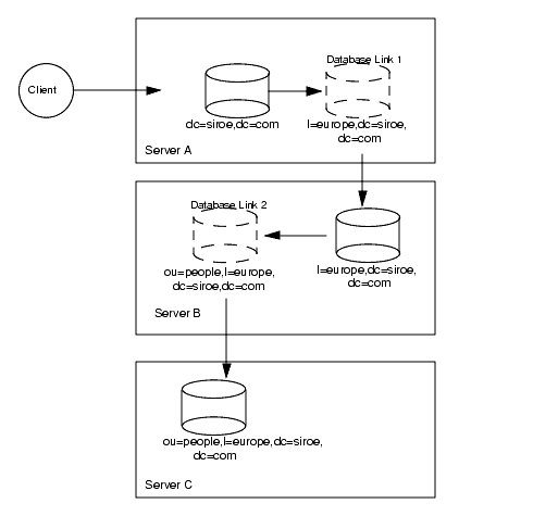

Consider the following example scenario. On server A, a directory tree is split as follows:
The root suffix dc=siroe,dc=com, the ou=people and ou=groups sub suffixes are stored on Server A. The l=europe,dc=siroe,dc=com and ou=groups suffixes are stored in on Server B, and the ou=people branch of the l=europe,dc=siroe,dc=com suffix is stored on Server C.
With cascading configured on servers A, B, and C, a client request targeted at the ou=people,l=europe,dc=siroe,dc=com entry would be routed by the directory as follows:
First the client binds to Server A and chains to Server B using Database Link 1. Then Server B chains to the target database on Server C using Database Link 2 to access the data in the ou=people,l=europe,dc=siroe,dc=com branch. Because at least two hops are required for the directory to service the client request, this is considered a cascading chain.

This section covers the following topics:Configuring the intermediate database link or links (in the example, server two) to transmit the Proxy Authorization Control.
Creating a proxy administrative user ACI on all intermediate database links. To do so, you will need to create a database on each server that contains an intermediate database link.
Enabling local ACI evaluation on all intermediate database links.
Creating client ACIs on all intermediate database links and the final destination database.
"Pointing to Another Database Link"
"Transmitting the Proxy Authorization Control"
"Creating the Proxy Administrative User ACI"
To create a cascading chain, the nsFarmServerURL attribute of one database link must contain the URL of the server containing another database link. For example, suppose the database link on the server called siroe1.com points to a database link on the server called africa.siroe.com. The cn=database_link_name,cn=chaining database, cn=plugins,cn=config entry of the database link on server one would contain the following:nsFarmServerURL: ldap://africa.siroe.com:389
By default, a database link does not transmit the Proxy Authorization Control. However, when one database link contacts another, this control is used to transmit information needed by the final destination server. The intermediate database link needs to transmit this control. To configure the database link to transmit the proxy authorization control, add the following to the cn=config,cn=chaining database,cn=plugins,cn=config entry of the intermediate database link:nsTransmittedControls: 2.16.840.1.113730.3.4.12
The OID value represents the Proxy Authorization Control. For more information about chaining LDAP controls, refer to "Chaining LDAP Controls".
You need to create an ACI on the server that contains the intermediate database link that checks the rights of the first database link before translating the request to another server. For example, if server two does not check the credentials of server one, then anyone could bind as anonymous and pass a proxy authorization control allowing them more administrative privileges than appropriate.To prevent this security hole, you need to create an ACI on the server which contains the intermediate database link. To create an ACI, you need to do the following:
Create a database, if one does not already exist, on the server containing the intermediate database link. This database will contain the admin user entry and the ACI. For information about creating a database, see "Creating Databases".
Create an entry that corresponds to the administrative user in the database.
Create an ACI for the administrative user that targets the appropriate suffix. This ensures the administrator has access only to the suffix of the database link. Add the following ACI to the administrative user's entry:
- aci: (targetattr = "*")(version 3.0; acl "Proxied authorization for database links"; allow (proxy) userdn = "ldap:///cn=proxy admin,cn=config";)
- This ACI is like the ACI you create on the remote server when configuring simple chaining.
Enabling Local ACI Evaluation
To confirm that the proxy administrative ACI is used, you need to enable evaluation of local ACIs on all intermediate database links involved in chaining. To do this, add the following attribute to the cn=database_link_name,cn=chaining database,cn=plugins,cn=config entry of each intermediate database link:Setting this attribute to on in the cn=default instance config,cn=chaining database,cn=plugins,cn=config entry means that all new database link instances will have the nsCheckLocalACI attribute set to on in their cn=database_link_name,cn=chaining database,cn=plugins,cn=config entry.
Creating Client ACIs
Because you have enabled local ACI evaluation, you need to create the appropriate client application ACIs on all intermediate database links as well as the final destination database.To do this on the intermediate database links, you first need to create a database that contains a suffix that represents a root suffix of the final destination suffix.
For example, if you are chaining a client request made to the c=africa,ou=people,dc=siroe,dc=com suffix on a remote server, all intermediate database links need to contain a database associated with the dc=siroe,dc=com suffix.
You then need to add any client ACIs to this superior suffix entry. For example, you might add the following
aci: (targetattr = "*")(version 3.0; acl "Client authentication for database link users"; allow (all) userdn = "ldap:///uid=* ,cn=config";)
This ACI allows client applications that have a uid in the cn=config entry of server one to perform any type of operation on the data below the ou=people,dc=siroe,dc=com suffix on server three.
Detecting Loops
An LDAP control included with Directory Server prevents loops. When first attempting to chain, the server sets this control to be the maximum number of hops, or chaining connections, allowed. Each subsequent server decrements the count. If a server receives a count of 0 it determines that a loop has been detected and notifies the client application.The number of hops allowed is defined using the nsHopLimit attribute. If not specified, the default value is 10.
To use the control, add the following OID to the nsTransmittedControl attribute in the cn=config,cn=chaining database,cn=plugins,cn=config entry:
nsTransmittedControl: 1.3.6.1.4.1.1466.29539.12
If the control is not present in the configuration file of each database link, loop detection will not be implemented.
Summary of Cascading Chaining Configuration Attributes
The following table describes the attributes used to configure intermediate database links in a cascading chain:
Cascading Chaining Configuration Example
To create a cascading chain involving three servers as in the diagram below, you have to configure the chaining components on all three servers. This section describes the configuration steps for creating a cascading chain involving three servers and is divided into the following sections:
"Configuring Server One"
First, use the ldapmodify command-line utility to add a database link to server one. Change to the directory containing the utility:
Solaris 9 platform
Then specify the configuration information for the database link, DBLink1, on server one as follows:
- ldapmodify -a -h host -p port -D "cn=Directory Manager" -w password
objectclass: top
nsslapd-suffix: l=Zanzibar,c=africa,ou=people,dc=siroe,dc=com
nsmultiplexorbinddn: cn=server1 proxy admin,cn=config
cn: DBLink1
nsCheckLocalACI:offcn="l=Zanzibar,c=africa,ou=people,dc=siroe,dc=com",cn=mapping tree,cn=config
objectclass=nsMappingTree
nsslapd-state=backend
nsslapd-backend=DBLink1
cn: l=Zanzibar,c=africa,ou=people,dc=siroe,dc=comThe first section creates the entry associated with DBLink1. The second section creates a new suffix, allowing the server to direct requests made to the database link to the correct server. You do not need to configure the nsCheckLocalACI attribute to check local ACIs, as this is only required on the database link, DBLink2, on server two.
Since you want to implement loop detection, you need to specify the OID of the loop detection control in the nsTransmittedControl attribute stored in cn=config,cn=chaining database,cn=plugins,cn=config entry on server one. You specify the OID as follows:
dn: cn=config,cn=chaining database,cn=plugins,cn=config
changeType: modify
add: nsTransmittedControl
nsTransmittedControl: 1.3.6.1.4.1.1466.29539.12As the nsTransmittedControl attribute is usually configured by default with the loop detection control OID 1.3.6.1.4.1.1466.29539.12 value, it is wise to check beforehand whether or not it already exists. If it does exist you do not need to perform this configuration step.
Configuring Server Two
Next, you create a proxy administrative user on server two. This administrative user will be used to allow server one to bind and authenticate to server two. Bear in mind that it is useful to choose a proxy administrative user name which is specific to server one as it is the proxy administrative user which will allow server one to bind to server two. You create the proxy administrative user as follows:dn: cn=server1 proxy admin,cn=config
objectclass: person
cn: server1 proxy admin
sn: server1 proxy admin
Do not use the Directory Manager or Administrator ID user as the proxy administrative user on the remote server. This creates a security hole.
Next, you configure the database link, DBLink2, on server two. Using ldapmodify, specify the configuration information for DBLink2 as follows:
dn: cn=DBLink2,cn=chaining database,cn=plugins,cn=config
objectclass: top
nsfarmserverurl: ldap://zanz.africa.siroe.com:389/
nsmultiplexorbinddn: cn=server2 proxy admin,cn=config
cn: DBLink2
nsCheckLocalACI:ondn: cn="l=Zanzibar,c=africa,ou=people,dc=siroe,dc=com",cn=mapping tree,cn=config
objectclass: top
nsslapd-backend: DBLink2
nsslapd-parent-suffix:"c=africa,ou=people,dc=siroe,dc=com"
cn: l=Zanzibar,c=africa,ou=people,dc=siroe,dc=comSince database link DBLink2 is the intermediate database link in your cascading chaining configuration, you need to set the nsCheckLocalACI to on, to allow the server to check whether or not it should allow the client and proxy administrative user access to the database link.
The database link on server two must be configured to transmit the proxy authorization control and the loop detection control. To implement the proxy authorization control and the loop detection control you need to specify both corresponding OIDs. Add the following information to the cn=config,cn=chaining database, cn=plugins,cn=config entry on server two:
changeType: modify
nsTransmittedControl: 2.16.840.1.113730.3.4.12
nsTransmittedControl: 1.3.6.1.4.1.1466.29539.12where nsTransmittedControl: 2.16.840.1.113730.3.4.12 is the OID for Proxy Authorization control and nsTransmittedControl: 1.3.6.1.4.1.1466.29539.12 is the OID for the loop detection control.
Again, remember to check beforehand whether or not the loop detection control is already configured, and adapt the above command accordingly.
The next step is to configure your ACIs. On server two you need to ensure that a suffix exists above the there is an existing suffix above the l=Zanzibar,c=africa,ou=people,dc=siroe,dc=com suffix to allow you to:
add the database link suffix
Both ACIs will be placed on the database that contains the c=africa,ou=people,dc=siroe,dc=com suffix.add a local proxy authorization ACI that will be used to allow server one to connect using the proxy authorization administrative user that will be created on server two, and
add a local client ACI that allows the client operation to succeed on server two, so that it can be forwarded to server three. This local ACI is needed because you have turned local ACI checking on for the DBLink2 database link.
Add the local proxy authorization ACI to the c=africa,ou=people,dc=siroe,dc=coml entry:
aci:(targetattr="*")(target="l=Zanzibar,c=africa,ou=people,
dc=siroe,dc=com")(version 3.0; acl "Proxied authorization for database links"; allow (proxy) userdn = "ldap:///cn=server1 proxy admin,cn=config";)Then add the local client ACI that will allow the client operation to succeed on server two given that ACI checking is turned on. This ACI is the same as the ACI you will create on the destination server to provide access to the l=Zanzibar,c=africa,ou=people,dc=siroe,dc=com branch. You may decide that you want all users within c=us,ou=people,dc=siroe,dc=com to have update access to the entries in l=Zanzibar,c=africa,ou=people,dc=siroe,dc=com on server three. The following ACI is the ACI you would need to create on the c=africa,ou=people,dc=siroe,dc=com suffix on server two to allow this:
dc=siroe,dc=com")(version 3.0; acl "Client authorization for database links"; allow (all) userdn = "ldap:///uid=*,c=us,ou=people,dc=siroe,dc=com";)This ACI allows clients that have a uid in c=us,ou=people,dc=siroe,dc=com on server one to perform any type of operation on the l=Zanzibar,c=africa,ou=people,dc=siroe,dc=com suffix tree on server three. Should you have users on server two under a different suffix that will require additional rights on server three, you may need to add additional client ACIs on server two.
Configuring Server Three
The final configuration step in our cascading chaining example is to configure server three. First, you create an administrative user on server three for server two to use for proxy authorization:dn: cn=server2 proxy admin,cn=config
objectclass: person
cn: server2 proxy admin
sn: server2 proxy admin
description: Entry for use by database linksThen you need to add the same local proxy authorization ACI to server three as you did on server two. Add the following proxy authorization ACI to the l=Zanzibar,ou=people,dc=siroe,dc=com entry:
aci: (targetattr = "*")(version 3.0; acl "Proxied authorization for database links"; allow (proxy) userdn = "ldap:///cn=server2 proxy admin,cn=config";)
This ACI gives the server2 proxy admin read-only access to the data contained on the remote server, server three, within the l=Zanzibar,ou=people,dc=siroe,dc=com subtree only.
You then need to create an local client ACI on the l=Zanzibar,ou=people,dc=siroe,dc=com subtree that corresponds to the original client application. Use the same ACI as the one you created for the client on server two:
aci: (targetattr = "*")(target="l=Zanzibar,c=africa,ou=people,dc=siroe,dc=com")(versio n 3.0; acl "Client authentication for database link users"; allow (all) userdn = "ldap:///uid=*,c=us,ou=people,dc=siroe,dc=com";)
Once you have completed all these steps your cascading chaining configuration is set up. This cascading configuration will allow you to bind to server one and modify information in the l=Zanzibar,c=africa,ou=people,dc=siroe,dc=com branch on server three. Depending on your security needs you may or may not want to provide more detailed access control.
