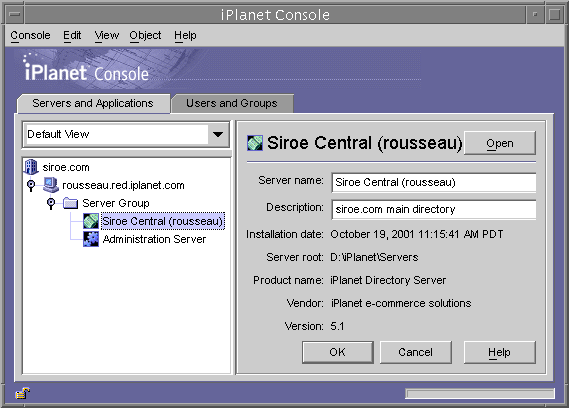

Log in using the bind DN and password of a user with sufficient access permissions for the operations you want to perform. For example, use cn=Directory Manager, and the appropriate password.
- The Console login window is displayed. Or, if your configuration directory (the directory that contains the o=NetscapeRoot suffix) is stored in a separate instance of Directory Server, a window is displayed requesting the administrator user DN, password, and the URL of the Admin Server for that directory server.
Navigate through the tree in the left-hand pane to find the machine hosting your Directory Server and click on its name or icon to display its general properties.
- The iPlanet Console is displayed.
- To edit the name and description of your directory server, click the Edit button. Enter the new name and description in the text boxes. The name will appear in the tree on the left, as shown in the following figure.
Figure 1-1    The iPlanet Console ![]()
- Click OK to set the new name and description.
Double-click the name of your Directory Server in the tree or click the Open button to display the Directory Server Console for managing this directory server.

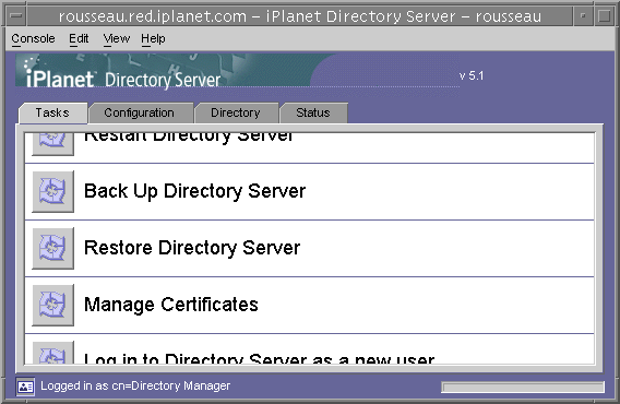

Tasks Tab
The Tasks tab is the first interface visible when opening the Directory Server Console. It contains buttons for all of the major administrative tasks such as starting or stopping the Directory Server as shown in the following figure. To view all of the tasks and their buttons, you may need to resize the console window.
Figure 1-2    Tasks Tab of the Directory Server Console ![]()
You must be logged in as a user with directory manager rights in order to perform these tasks. If you try to perform a task with insufficient rights, the console will prompt you for the DN and password of a directory manager.

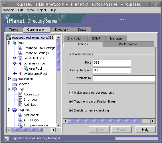

Configration Tab
The Configuration tab of the Directory Server Console provides interfaces and dialogs to view and modify all directory settings such as those for databases, suffixes, replication, schema, logs, and plug-ins. These dialogs are only available or will only take effect if you are logged in as a user with directory manager rights.The left side of this tab contains a tree of all configuration functions and the right-hand side displays the interface specific to managing each function. These interfaces often contain other tabs, dialogs or pop-up windows. For example, the following figure shows the general settings for the entire directory.
Figure 1-3    Configuration Tab of the Directory Server Console ![]()
When you select a configurable item in the left-hand tree, the current settings for that item will appear in one or more tabs in the right-hand pane. Depending on the setting, some changes will take effect immediately when saved, and others not until the server is restarted. For the explanation and behavior of these settings, please refer to the chapter in this guide that describes each functionality.
Unsaved changes in a tab are signalled by a red mark next to the tab name. Unsaved changes will remain on the tab even if you configure another item or change to one of the other major tabs. The Save and Reset buttons apply to all tabs of a given configurable item, but do not affect the unsaved settings of other items.
Most text fields will only allow you to enter values that have the correct syntax for the setting. By default, the label of the setting and the value that you type will be highlighted in red until its syntax is correct. The Save button will be diabled until all settings have valid syntax. You may choose italic font for highlighting incorrect values, or no highlighting at all, from the Misc. tab of the Edit > Preferences dialog.

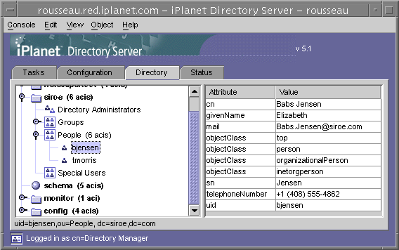

Directory Tab
The Directory Tab of the console displays the directory entries as a tree for easy navigation. In this tab, all entries and the attributes they contain can be browsed, displayed and edited.
Figure 1-4    Directory Tab of the Directory Server Console ![]()
If the bind DN given during the login has sufficient access rights, the configuration entries are viewed as normal entries and may be modified directly. However, you should always use the dialogs available through the Configuration Tab to change the configuration settings safely.
Several options are available through the View menu to change the layout and contents of the Directory Tab. New layout options include viewing all entries in a single tree, including leaf entries, and also displaying attributes in the right-hand pane. The default is to view leaf entries on the right and not in the left-hand tree.
The View>Display options enable ACI counts, role counts, and inactivation state icons for all entries in the directory tree. In the previous figure, ACI counts and leaf entries are displayed in the left-hand tree, and attribute values for the selected entry are displayed in the right-hand pane.

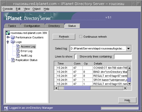

Status Tab
The status tab displays server statistics and log messages. The tree on the left lists all status items, and when selected, the contents of each is displayed in the right-hand pane. For example, the following figure shows a table of log entries.
Figure 1-5    Status Tab of the Directory Server Console ![]()

To modify the port or secure port on which either a user or a configuration directory listens for incoming requests:If you have other iPlanet Servers installed that point to the configuration or user directory, you need to update those servers to point to the new port number.
On the Directory Server Console, select the Configuration tab and then select the top entry in the navigation tree in the left pane.
Select the Settings tab in the right pane.
Enter the port number you want the server to use for non-SSL communications in the "Port" text box.
Enter the port number you want the server to use for SSL communications in the Encrypted Port text box.
Click Save and then restart the server.
- The encrypted port number that you specify must not be the same port number as you are using for normal LDAP communications. The default value is 636.
- See "Starting and Stopping the Directory Server" for information.
