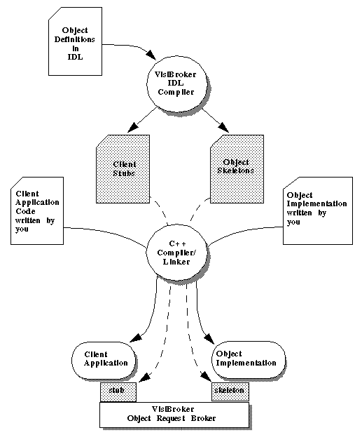

This section outlines the development process (illustrated in Figure 2.1). Details are provided later in the chapter. Following are the steps for developing applications using ISB for C++. File names and commands listed here refer to files in the sample application; replace them as appropriate for your application.
Create an IDL file to define interfaces (SendMsg.idl).
  1. Compile the IDL file to generate client and server support files:
    c:\msdev\projects\msg> orbeline -c cpp -h hpp -S tie SendMsg.idl
  2. Implement the service interface (HelloImpl.cpp).
  3. Implement the object server application (MsgService.cpp).
  4. Implement the client application (MsgClient.cpp)
  5. Build everything:
    prompt> cd c:\msdev\projects\msg
    c:\msdev\projects\msg> nmake
  6. Start the object server:
    c:\msdev\projects\msg> start MsgService
  7. Run the client application:
    c:\msdev\projects\msg> MsgClient
Figure 2.1    Developing the sample application.
