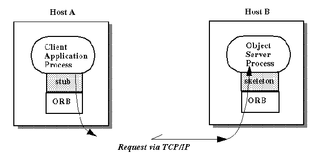

Client and Server on Different Hosts
If the ORB determines that the requested object implementation resides on a remote host, a TCP/IP connection will be established between the client and object server. The ORB will instantiate a proxy object for your client to use. All methods invoked on the proxy object will be packaged as requests and sent to the server on the remote host. The server on the remote host will unpack the request, invoke the desired method, and send the results back to the client.
Figure 3.1    Client and Server processes on different hosts.

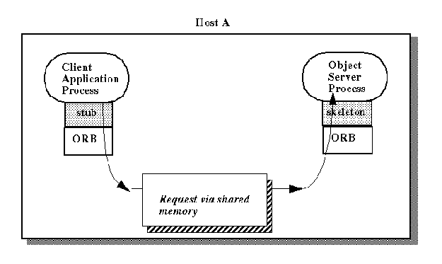

Client and Server on the Same Host
If the ORB determines that the requested object implementation resides on the local host, a connection will be established between the client and object server using shared memory only if both the client and server are multithreaded. The ORB will instantiate a proxy object for your client to use. All methods invoked on the proxy object will be packaged as requests and sent to the server using shared memory.
Figure 3.2    Client and Server processes on the same host.

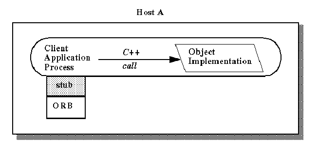

Client and Server in a Single Process
The previous discussions have assumed that object implementations have taken the form of a server process. While this is often the case, a client application and the object implementation can both be packaged inside a single process. When a client application binds to a service in this scenario, the ORB returns a pointer to the object implementation. That pointer will be widened to the object type used by the client application. All methods invoked on the client's object are called directly as C++ virtual functions on the object implementation. The ORB is involved only during the bind process.
Figure 3.3    Client and object implementation in the same process.
