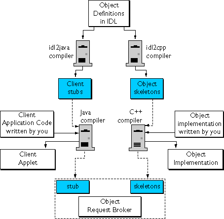

Java clients created with ISB for Java can communicate with services developed with ISB for C++, a separate product. Use the same IDL code you used to develop your Java application as input to the ISB IDL compiler supplied with ISB for C++. Then use the resulting C++ skeletons to develop the service implementation. Also, services written using ISB for Java will work with clients written using ISB for C++. In fact, a service written using ISB for Java will work with any CORBA-compliant client; a client written using ISB for Java will work with any CORBA-compliant service.
Figure 1.3    Creating a client with ISB for Java and a service with ISB for C++.
