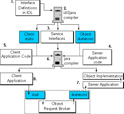

idl2java to generate the client stub code and service skeleton code.
javac to compile the service interface, server application, and client application (or applet).

Following are the steps to develop this sample application. Defining Interfaces in IDL

Running the idl2java Compiler
The ISB for Java IDL compiler is named idl2java and, as its name implies, generates Java code from a file of IDL specifications. The following command compiles the SendMsg.idl file.
c:\projects\msg> idl2java -no_tie -no_comments SendMsg.idl

Writing a Server Application
The server application (also called an object server) creates, activates, and registers services, making them available to clients. In this sample application, the server application is named MsgService. Many of the files used to implement MsgService are contained in the SendMsg package generated by the idl2java compiler. The MsgService.java file presented here is not generated. Normally you, the programmer, would create this file. This file provides a main method that does the following:
