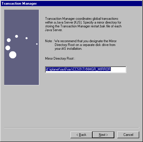

Create a Mirror Directory for Transaction Manager
The default disk drive is where you are installing the iPlanet Application Server. It is recommended that you specify a path on a separate disk drive. This is only needed if you are planning to use global transactions.

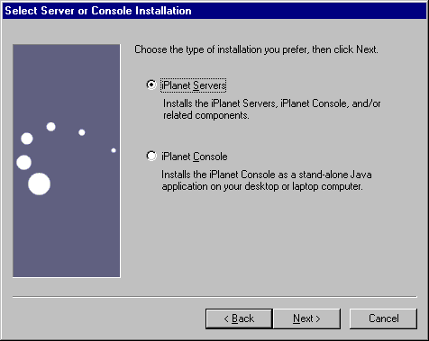

Accept the default to select iPlanet Servers.

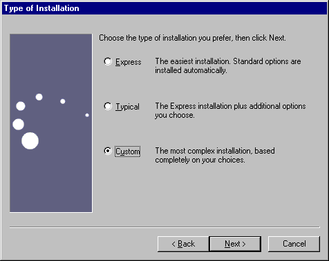

Accept the default Typical installation, or select Express or Custom. (These steps detail a Custom installation.)

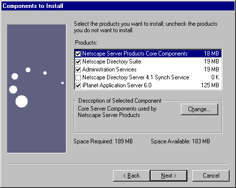

- Choosing iPlanet Servers installs the Netscape Server Products Core Components, Netscape Directory Suites, and Administration Services with the iPlanet Application Server.
- The iPlanet Console is an administration console. Select it only to install as a stand-alone application.

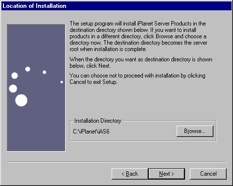

Select the installation directory.
Accept default selections.
- The default directory is c:\iPlanet\iAS6. If you do not have 200MB available on this drive for the installation of iPlanet Application Server, browse to select a different drive. Do not use a directory name that includes spaces.

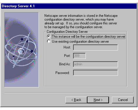

Accept the default "This instance will be the configuration directory server."
- Do not select the Netscape Directory Server 4.1 Synch Service, even though it is listed.

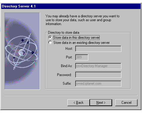

Accept the default "Store data in this directory server" if you did not select an existing Directory Server in the previous step.
- If you will be use another directory server (local or remote) to store the iPlanet Application Server configuration information, select "Use existing configuration directory server" and enter those settings.

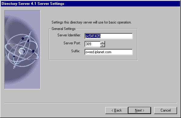

Accept the default Directory Server settings.
- If you want to use an existing directory server, select "Store data to existing Directory Server" and enter its settings.

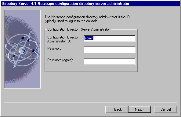

Enter the Administrator ID and password for the configuration directory server administrator.

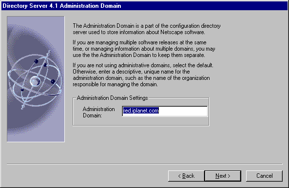

Accept the default, or enter a unique name for the Administration Domain.

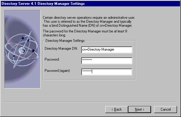

Enter the Directory Manager Distinguished Name (DN) and a password of at least eight characters.

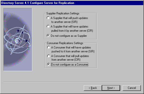

Accept the default supplier and consumer replication settings.
- The default value for the Distinguished Name is cn=Directory Manager. For more information about Directory Manager DN, see page 126.

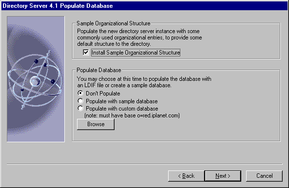

Accept the default to populate the directory server with commonly used entries. These are provided to help you get started running iPlanet Application Server. Populate the database by selecting the appropriate radio button.
- For more information about consumer and supplier replication, see Netscape Directory Server documentation:

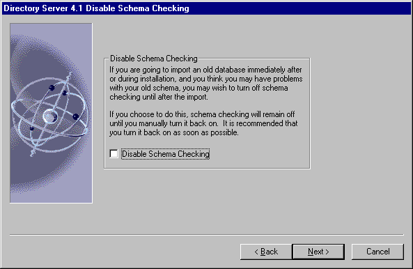

Accept the default, or disable schema checking.
- For more information about populating the database, see Netscape Directory Server documentation:

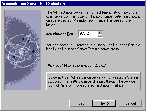

Configuring the Administration Server

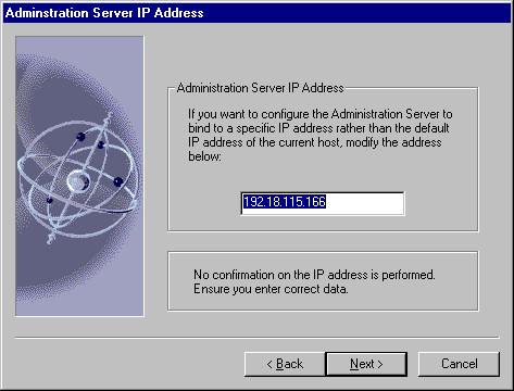

Accept the default or enter a specific IP address to bind to your Administration Server.
Accept the default port number for the Administration Server.

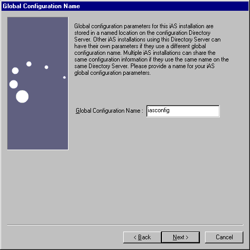

Accept the default, or enter a unique global configuration name for this installation of iPlanet Application Server.
- Netscape Console requires this port number to administer the Directory Server. For more information about the Administration Server, see page 126.

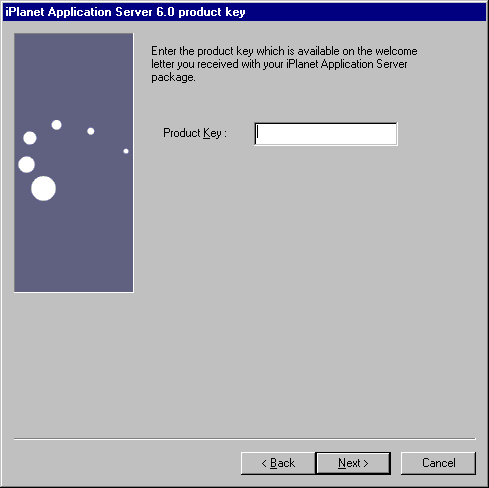

Enter the NT product key for iPlanet Application Server.
- The name you assign is stored on the configuration Directory Server, under the o=iPlanetRoot tree, along with the global configuration names of any other iPlanet Application Server installations.

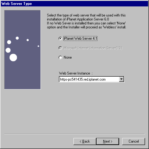

Select the web server you want to use.
- In case of multiple instances of iPlanet Web Server (iWS), select the instance you wish to use.
Note If you are using a web server other than IIS or iWS, you must enter the doc and cgi-bin directories.
See "Web Server, "page 127, to learn more about web servers and webless installation.

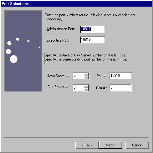

Enter the number of Java Servers (KJS) and C++ Servers (KCS) used to process applications.
Enter the port numbers for the Administrative Server (KAS), the Executive Server (KXS), the Java Servers (KJS), and C++ Servers (KCS).
- The default values are 1; increase these values to handle high processing loads.
- You can also adjust the values after installation using the Administration Tool. See the iPlanet Application Server Administrator's Guide for more information.

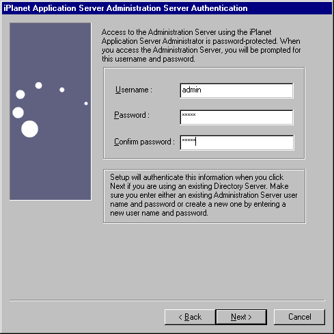

Enter the Administration Server username and password.

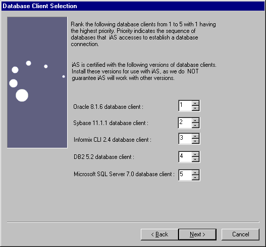

Rank the installed databases in order of connection priority.
- The installation program lists all supported database clients. The clients are allow your applications to connect to your database back ends. Rank the clients according to connection priority, whether you've installed them yet or not. Client software can be added after installation. Sample applications are configured for the highest priority database. See "Database, "page 128, to learn more.

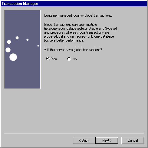

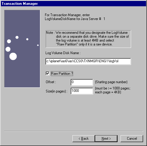

Configuring Transaction Manager
Specify if the server will have global transactions.
If you specified "Yes" to global transactions, enter the mirror directory path where the transaction manager restart.bak file for each KJS engine process gets stored.
Accept the default, or enter the log volume disk name where the transaction manager log file is to be stored for each Java Server.
- The default location is the disk drive on which you are installing iPlanet Application Server. It is recommended that you specify a path on a separate disk drive.
- It is recommended that you specify a path on a separate disk drive. Indicate if the specified disk name is a raw partition.
- If the log volume is a raw partition, indicate Offset (starting page number) and Size (number of pages) in the raw partition. Make sure the size allocated for the log file is greater than 4 MB; the file should be greater than or equal to 1000 pages, at a size of roughly 4 KB per page. See "Raw Partitions," page 129, for more information.

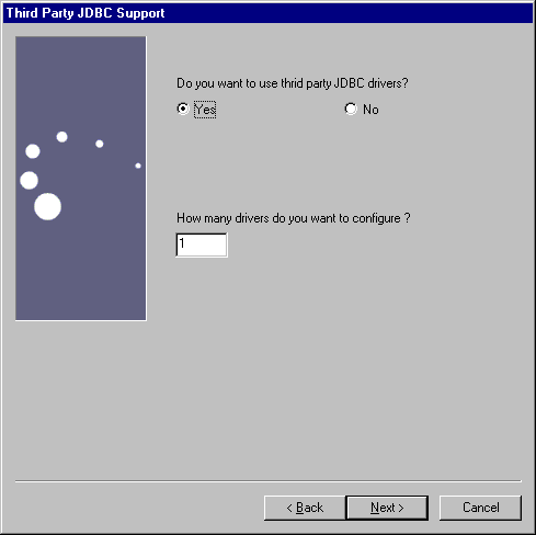

Configuring Third Party JDBC Drivers
Enter whether or not you will use third party JDBC drivers. If you answer yes, type in how many drivers will be configured.
For more information about Third Party JDBC Driver Support, see page 130.
You will need to enter the following information for each third party JDBC driver you will use. Format your entries as shown in the examples.
Note For typical Classnames and CLASSPATHS, see Third Party JDBC Driver Support, page 130. After installation you must register the datasource files for the third party JDBC drivers. The above reference also explains registration.

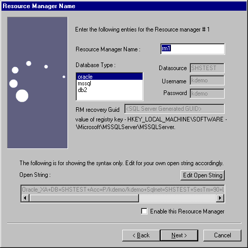

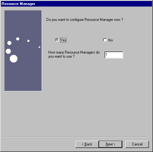

Indicate whether or not you want to configure the Resource Manager, and specify the number of Resource Managers you will use.
For more information about the Resource Manager, see page 140.
Accept the defaults or enter new information for each Resource Manager.
See "Open String Information,"page 141, to learn more.

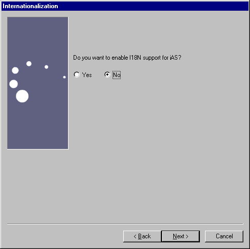

Specify whether or not you want to enable I18N support.
- Enabling I18N support allows multi-lingual applications to be deployed to iPlanet Application Server.

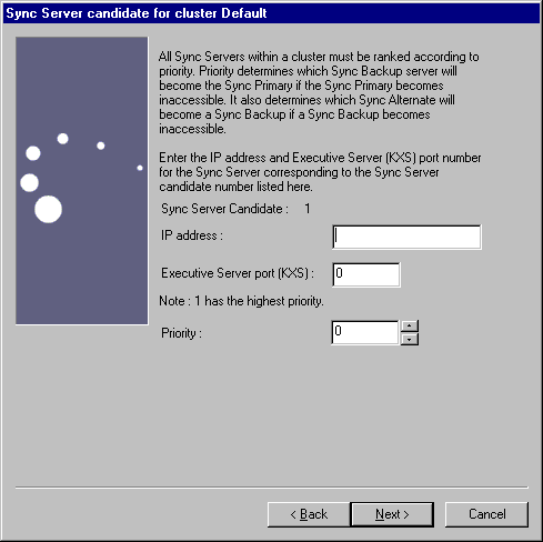

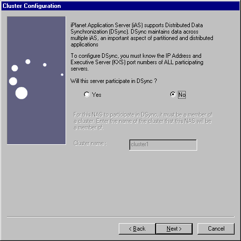

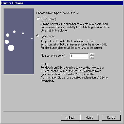

Accept the default, or select "Yes" if you intend to synchronize session and state information across multiple servers for failover and fault tolerance. Then enter the name of the cluster that this instance of iPlanet Application Server participates in.
Indicate if you are currently installing a Sync Server or a Sync Local. Then enter the total number of Sync Servers that you plan to have in the cluster.
- For more information about "Clusters and Data Synchronization,"see page 142.
A Sync Local server uses data synchronization services, but is not eligible to become a Sync Primary or the Sync Backup Server.
If you selected Sync Server in the previous step, enter information for each Sync Server in the cluster. Then choose which Sync Server has the highest priority for taking over as Sync Primary, and rate all other servers in order of priority.

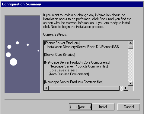

Review the summary provided by the installation program of the configuration you have selected.
The installation program confirms when all of the iPlanet Application Server files have been copied to your computer. Select OK on the final dialog to reboot your computer, allowing the new settings to take effect.

Before running the iPlanet Application Server uninstall program, make sure that Directory Server is running.
During the uninstall process, you are prompted to provide a user name and password with administrator access to the configuration directory. Enter the user name and password given during installation. Another user name and password can be entered, if it has administrator privileges to the configuration Directory Server.
The following directories remain after you uninstall iPlanet Application Server:
iPlanet Application Server root directory
After uninstalling iPlanet Application Server, decide if you want to remove these directories, particularly the custom and APPS directories, which may contain applications you've developed, and files you wish to keep.Any custom directories you created under the iPlanet Application Server directory
Click the Uninstall icon in the iPlanet Application Server 6.0 program group.
Choose the components and subcomponents you wish to uninstall.
When prompted, enter a user name and password with administrator access to the configuration Directory Server. If you do not know, or do not want to use the user name and password given during installation, enter another user name and password having administrator privileges on the configuration Directory Server.
Enter the configuration Directory Server information.
