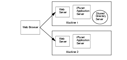

If your Web Server runs on a different machine than the iPlanet Application Server, you perform what is referred to as a "webless" installation. After performing a webless installation, you must remember to install the Web Connector plugin on the Web Server in your configuration after you finish installing iPlanet Application Server.

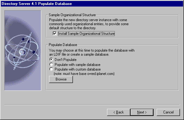

Accept the default to populate the directory server with commonly used entries. These are provided to help you get started running iPlanet Application Server. Populate the database by selecting the appropriate radio button.
- A server that holds a replica that is copied to a replica on a different server is called a supplier. A server that holds a replica that is copied from a different server is called a consumer. For more information on replication concepts, see iPlanet Directory Server Deployment Guide.
- http://docs.iplanet.com/docs/manuals/directory.html#dirserver
It is recommended that you keep the default; enable schema checking.

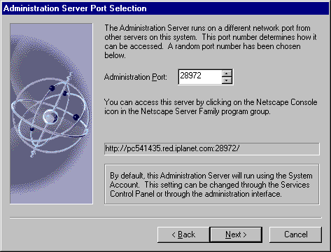

Accept the default or enter a specific IP address to bind to your Administration Server.
Accept the default port number for the Administration Server.
- Be sure to enter the IP address carefully as no verification is performed.

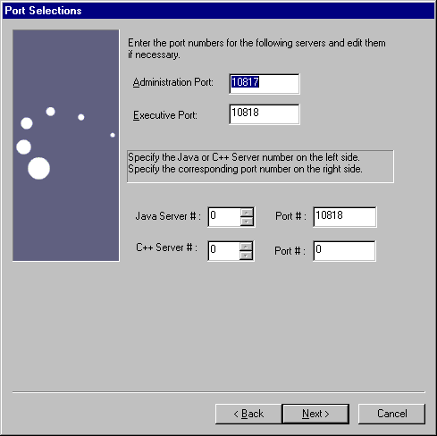

To Configure the iPlanet Application Servers
For iPlanet Application Server installation that have more than one server, enter the number of Java Servers (KJS) and C++ Servers (KCS) to use to process applications.
All port numbers you specify for listener ports must be within the acceptable range (1 to 65535), and must be unique (not used by any other applications on your system).
Enter the port numbers for the Administrative Server (KAS), the Executive Server (KXS), the Java Servers (KJS), and C++ Servers (KCS).
- The default values are 1; increase these values to handle high processing loads. You can also adjust the values after installation using the Administration Tool. See the iPlanet Application Server Administrator's Guide for more information.

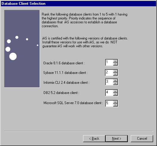

The installation program lists all supported database clients. The clients are allow your applications to connect to your database back ends. Rank the clients according to connection priority, whether you've installed them yet or not. Client software can be added after installation. Sample applications are configured for the highest priority database.
Rank the installed database clients in order of connection priority.

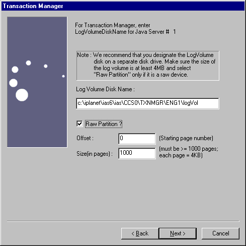

To Configure the Transaction Manager
Specify whether or not to enable global transactions.
If you specified "Yes" to global transactions, enter the mirror directory path where the transaction manager restart.bak file for each KJS engine process gets stored.
Accept the default, or enter the log volume disk name where the Transaction Manager log file is to be stored for each Java Server.
- It is recommended that you specify a path on a separate disk drive by changing the default, which is on the installation disk drive.
- It is recommended that you specify a path on a separate disk drive. Indicate if the specified disk name is a raw partition.
- If the log volume is a raw partition, indicate Offset (starting page number) and Size (number of pages) in the raw partition. Make sure the size allocated for the log file is greater than 4 MB; the file should be greater than or equal to 1000 pages, at a size of roughly 4 KB per page.

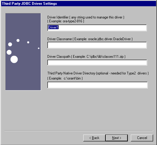

To Configure Third Party JDBC Drivers
On the Third Party JDBC Support panel, enter whether or not you are using third party JDBC drivers.
If you answer yes, enter the number of drivers you want to configure before clicking Next.
For each third party JDBC driver, enter the driver's identifier, classname, and classpath; formatting each entry as shown in the wizard's examples.
Note After installation you must register the data source files for the third party JDBC drivers. The above reference also explains registration.

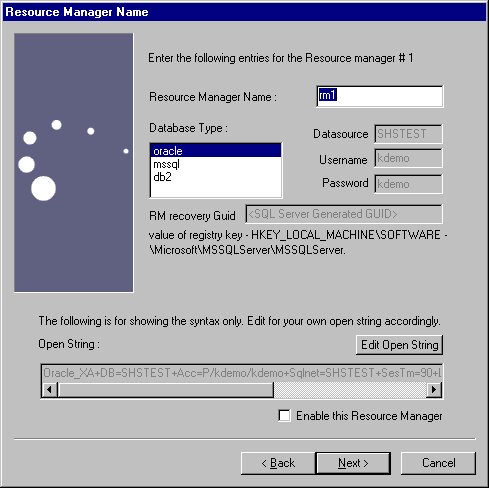

To Configure the Resource Manager
Indicate whether or not you want to configure any Resource Managers at this point in the installation. If you do, specify the number of Resource Managers you will use.
Accept the defaults or enter new information for each Resource Manager.

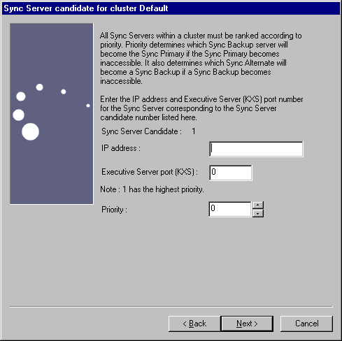

Select "Yes" if you intend to synchronize session and state information across multiple servers for failover and fault tolerance.
Enter the name of the cluster that this instance of iPlanet Application Server participates in.
Click on Sync Server or Synch Local to indicate whether this iPlanet Application Server is a synchronization server (Sync. Server) or a local server (Sync Local.)
Enter the total number of synchronization servers that you plan to have in this cluster.
If this server is a synchronization server (you selected Sync Server in the previous step) enter its IP address, Executive Server (KXS) port number, and its priority number for taking over as the primary synchronization server.
- A Sync Local server uses data synchronization services, but is not eligible to become a Sync Primary or the Sync Backup Server.

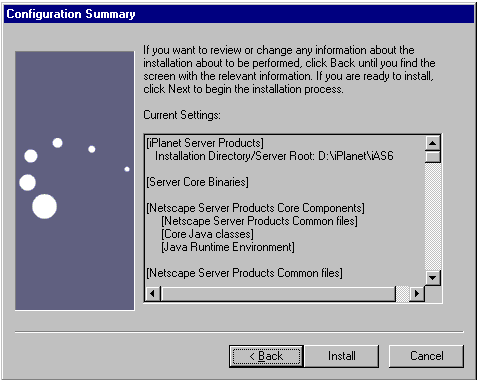

Scroll down the Current Settings list to verify your settings. Click Back to return to a previous panel to make corrections, otherwise click Install.
The installation program notifies you when all of the iPlanet Application Server files are in place. Select OK on the final dialog to reboot your computer, so that the new settings can take effect.

Installing iPlanet Application Server Clusters
A simple cluster configuration is demonstrated in the instructions on the iPlanet Developer's Web site. This simplistic cluster configuration is not representative of a true production configuration, but is sufficient to demonstrate the behavior of the iPlanet Application Server.The configuration consists of two machines that each have a Web server instance and an iPlanet Application Server instance installed. One machine also has a Directory Server instance that is used by the application servers on both machines, as shown in the following illustration.
Figure 4-1    A simple iPlanet Application Server cluster configuration
In this simple cluster, configuration data is stored in the directory server on the first machine. When the second application server is installed, it uses the same directory server for configuration information. It's preferable to use the same data tree in the directory server, so that the same configuration information can be shared between all servers and Web connectors.
During installation of the second application server, you must enter the same value for the cluster name and global configuration name as specified during the first application server installation.
In this example, the Web servers are on the same machine as the iPlanet Application Servers. If the Web servers were housed on a separate tier of machines, then you would enter the same global configuration name and cluster name during the Web connector installation.
To Install iPlanet Application Server Clusters
See the instructions for installing and verifying the simple cluster in Figure 4-1, on the Windows NT platform at: http://developer.iplanet.com/appserver/samples/cluster/docs/nt-cluster.html
