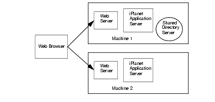

Configuring iPlanet Application Server Clusters
A simple cluster configuration is demonstrated in the instructions on the iPlanet Developer's Web site. This simplistic cluster configuration is not representative of a true production configuration, but is sufficient to demonstrate the behavior of the iPlanet Application Server.
The configuration consists of two machines that each have a Web server instance and an iPlanet Application Server instance installed. One machine also has a Directory Server instance that is used by the application servers on both machines, as shown in the following illustration.
Figure 3-1    A simple iPlanet Application Server cluster configuration
In this simple cluster, configuration data is stored in the directory server on the first machine. When the second application server is installed, it uses the same directory server for configuration information. It's preferable to use the same data tree in the directory server, so that the same configuration information can be shared between all servers and Web connectors.
During installation of the second application server, you must enter the same value for the cluster name and global configuration name as specified during the first application server installation.
In this example, the Web servers are on the same machine as the iPlanet Application Servers. If the Web servers were housed on a separate tier of machines, then you would enter the same global configuration name and cluster name during the Web connector installation.
Note This is not a production configuration. If it were a production configuration, it would most likely have the Web servers on separate machines and a second Directory Server configured to act as a backup for the first Directory Server. For information on how to set up the iPlanet Directory Servers for replication and failover, see the iPlanet Directory Server Installation Guide at: http://docs.iplanet.com
To Install iPlanet Application Server Clusters
  1. Follow instructions for installing and verifying the simple cluster on the Solaris platform, shown in Figure 3-1 at: http://developer.iplanet.com/appserver/samples/cluster/docs/unix-cluster.html
