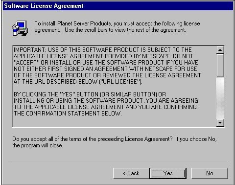

Thoroughly read and understand the licensing information before installing, and accept the license agreement. See Figure 2-2.
Figure 2-2    Software License Agreement ![]()

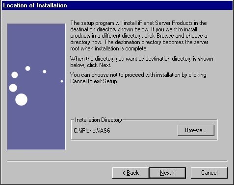

Choose your installation directory, then click Next. See Figure 2-3.
Figure 2-3    Location of Installation ![]()
Note You must install the iPlanet Application Server Enterprise Connector for CICS in the same directory as where you installed iPlanet Application Server and UIF.
Click Next to continue.

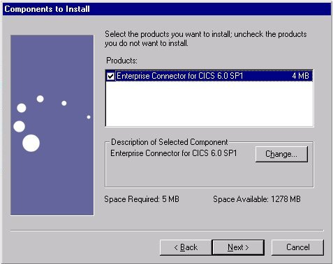

- Select the Enterprise Connector for CICS 6.0 check box. See Figure 2-4.
Figure 2-4    Components to Install ![]()

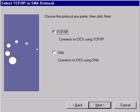

Choose the protocol you prefer, either TCP/IP or SNA protocol, by selecting the appropriate button, and then click Next. See Figure 2-5.
Note See Chapter 3 "Installing the Mainframe Component" for a description of alternatives to connect the CICS connector to the mainframe.
Figure 2-5    Select TCP/IP or SNA Protocol ![]()
- Continue with Step 10 if you selected TCP/IP protocol or continue with Step 11 if you selected the SNA protocol.

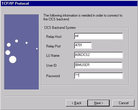

Type in your CICS Backend System definition for TCP/IP and click Next.
- The Configuration Summary shown in Figure 2-8 is displayed.
Figure 2-6    TCP/IP Protocol ![]()

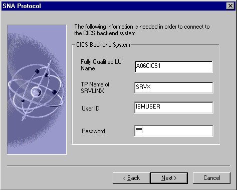

Enter the CICS Backend System information for APPC and click Next.
Figure 2-7    SNA Protocol ![]()

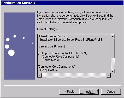

Review the configuration summary and click install if the information is correct.
Figure 2-8    Configuration Summary ![]()
Click Install if the information is correct.

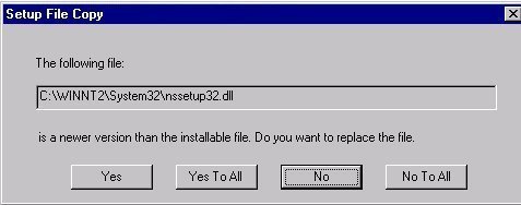

(Optional) Figure 2-9 displays the possible warning window(s) that can appear if the installer detects that the iAS Enterprise Connector for CICS is already installed. Choose Yes to overwrite the existing adapter type and all sample data source definitions shipped with the CICS connector. User defined data sources are not overwritten. Select No if you are simply adding another iPlanet Application Server instance to an existing cluster.
- Confirm your decision.
Figure 2-9    Setup File Copy ![]()

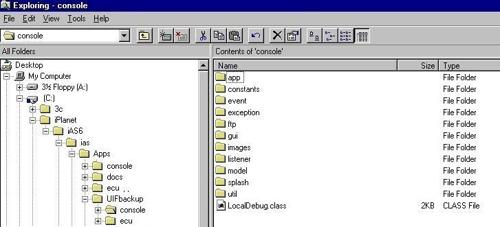

"> ICU libraries
Uncompress the icu-NT.zip under the <iAS InstallDir>\ias\APPS\bin directory.
- This places the following directories under the <iAS InstallDir>\ias\APPS\bin directory:

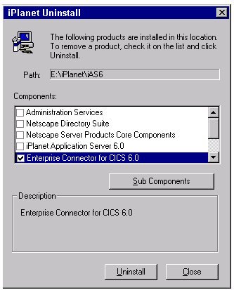

Select Start > Programs - iPlanet Application Server 6.0 > Uninstaller.
- The iPlanet Uninstall window appears. See Figure 2-10.
Figure 2-10    iPlanet Uninstall ![]()
Deselect all components for iAS except Enterprise Connector for CICS 6.0.
- The uninstaller checks for dependencies between subcomponents and the main component. If you try to deselect a component and its subcomponent are toggled on, a warning message appears.

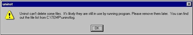

Click OK to complete the uninstallation procedure.
- The Enterprise Connector for CICS 6.0 has been uninstalled. Some files may remain. Check for these files at the location listed and manually remove them.

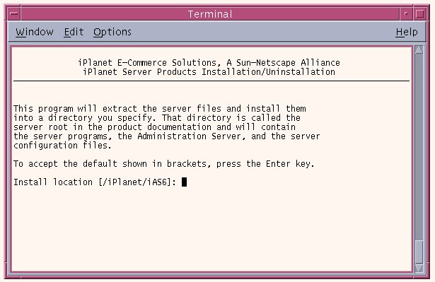

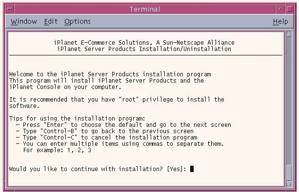

Figure 2-12 is displayed. Either press enter or type Yes to continue.
- Follow the instructions of the installation program. During installation, press the following key sequences for:
- CTRL+B to back up to the previous screen.
- CTRL+C to cancel the installation program. This results in an incomplete installation. To install again, rerun the installation program from the beginning.
Figure 2-12    Welcome ![]()

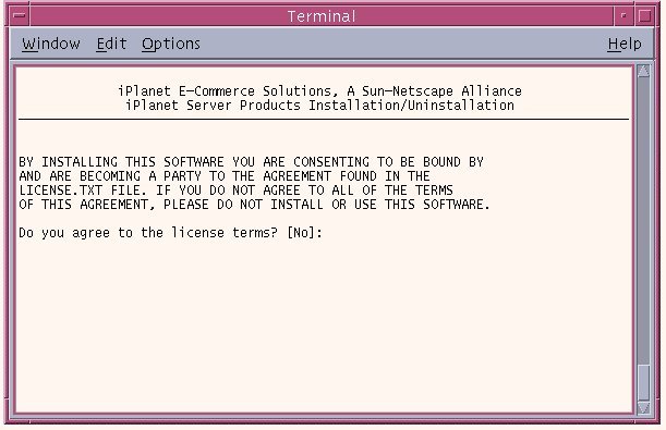

Enter Yes and the License message appears. See Figure 2-13.
Figure 2-13    License ![]()
Thoroughly read and understand the licensing information before installing and then enter Yes.

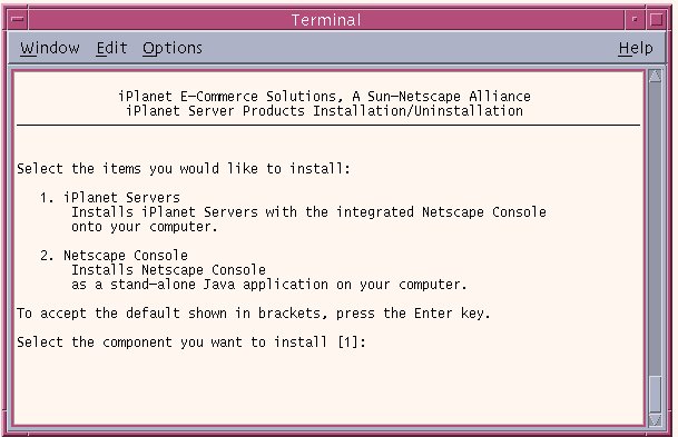

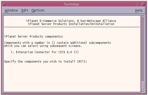

- The Selection message appears. See Figure 2-14.
Figure 2-14    Selection ![]()
Press Enter.
Note The iAS must already be resident on your system. You must perform this step to proceed with the connector installation.

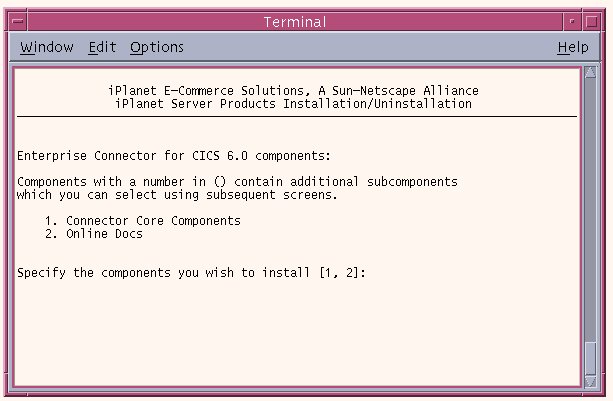

- The Components message appears. See Figure 2-16.
Figure 2-16    Components ![]()
Press Enter.

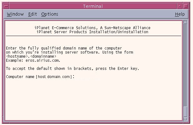

- The Domain Name message appears. See Figure 2-18.
Figure 2-18    Domain Name ![]()
Click Enter to accept the default or enter another name <host.domain.com>.

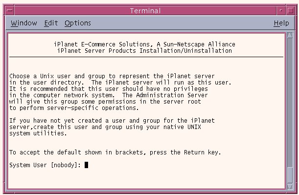

- The System User message appears. See Figure 2-19.
Figure 2-19    System User ![]()
Enter in a System User, or accept the default shown in brackets, and press Enter.

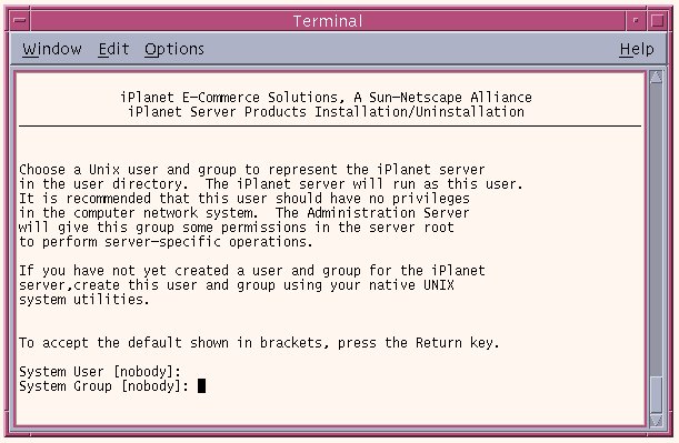

- The System Group message appears. See Figure 2-20.
Figure 2-20    System Group ![]()
Enter in a System Group, or accept the default shown in brackets, and press Enter.

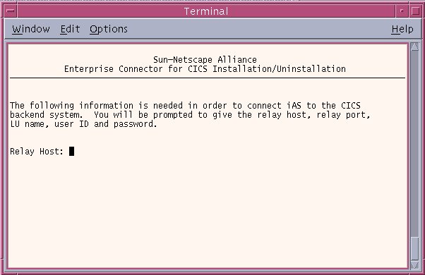

- The Relay Host message appears. See Figure 2-21.
Figure 2-21    Relay Host ![]()
Note The following steps are concerned with information from the mainframe.
Type in the Mainframe TCP/IP Host name and press Enter.

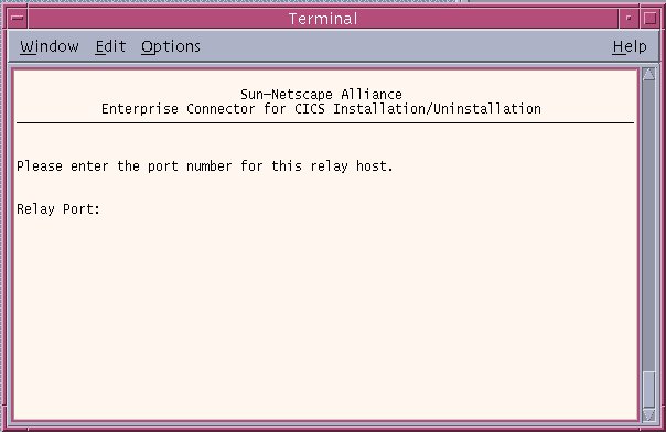

- The Relay Port message appears. See Figure 2-22.
Figure 2-22    Relay Port ![]()
Type in the Relay Port, and press Enter.
Note The Relay Port number is the same as the Port number in Table 3-8.

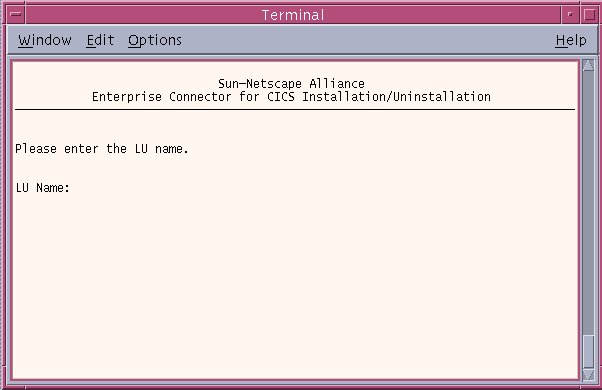

- The LU (logical unit) message appears. See Figure 2-23.
Figure 2-23    Logical Unit ![]()
Enter the LU name and press Enter.
- The LU name is the VTAM application LU name for CICS. The LU name must be upper case.

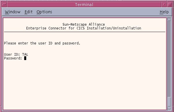

- The User ID and Password screen appears. See Figure 2-24.
Figure 2-24    User ID and Password ![]()
Type in the User ID and Password, and press Enter.
- This must be a valid User ID and Password pair as defined in the CICS backend and both names must be upper case.

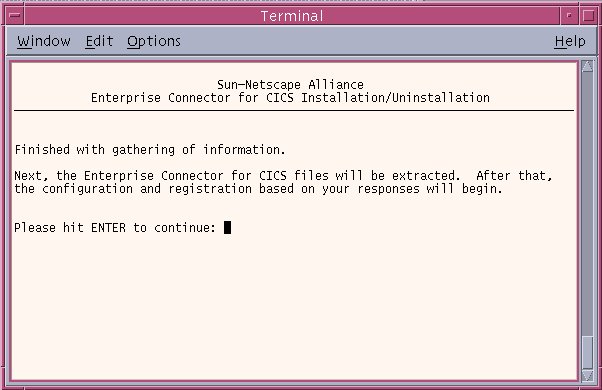

- The final installation screen appears. See Figure 2-25.
Figure 2-25    Final Installation Screen ![]()
Press Enter to continue.
- A Work-in-Progress screen will appear as the connector and related files are installed. When finished, you will be instructed to restart all iAS engines before running any sample application.

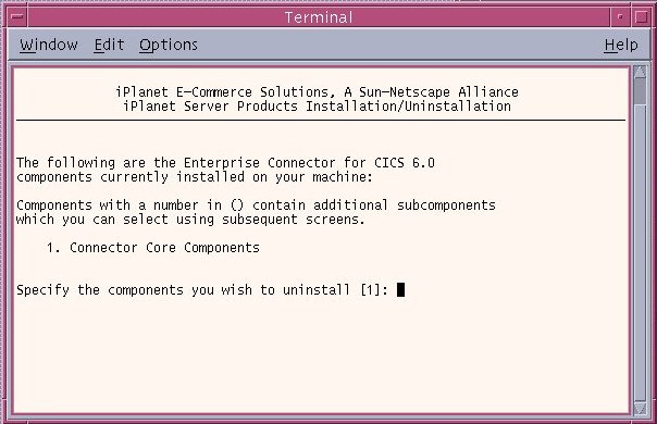

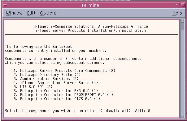

- A list of uninstall component options appears. See Figure 2-26.
Figure 2-26    Uninstall Component Options ![]()
Select the specific product components you want to uninstall and click Enter.

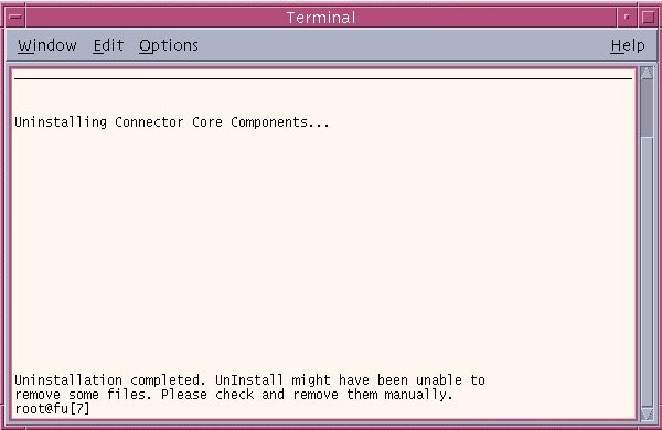

- The Uninstalling message appears. See Figure 2-28.
Figure 2-28    Uninstalling ![]()
- The Enterprise Connector for CICS 6.1 has been uninstalled. Some files may remain. Check for these files and manually remove them.

To Uninstall a Connector on Windows NT
If you want to uninstall a connector from a Windows NT machine that has more than one connector installed, perform the following tasks.
Uninstall the connector. Refer to Chapter 2 in the Administrator's Guide.
- During the uninstallation procedure the connector files shown in the right pane, see Figure 2-29, are removed from the iPlanet/iAS6/ias directory and moved to the UIFbackup/console directory. The connector files need to be copied back to their original location.
Figure 2-29    Uninstalling Connector ![]()
Copy the console specific directories, the top level directory and the connector specific directories to the ias/Apps/console for the following folders:
All the other directories, with all their included files, and the LocalDebug.class should be copied back.
Copy the following connector files to the console directory:
To Uninstall a Connector on Solaris
If you want to uninstall a connector from a Solaris machine that has more than one connector installed, perform the following tasks.
Copy the console specific directories, the top level directory and the connector specific directories to the ias/APPS/console for the following folders:
- During the uninstallation procedure the connector files are removed from the iPlanet/iAS6/ias directory and moved to the UIFbackup/console directory. The connector files need to be copied back to their original location.
