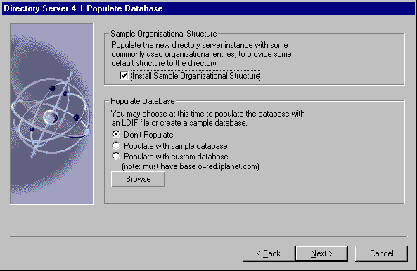

Choose to populate the database by selecting the appropriate radio button.
- These sample entries are provided to help you to start running iPlanet Application Server.
Click Next to enable schema checking. We recommended that you keep the default.
- If you have a custom database, select the Populate with custom database option > click Browse. Enter the full path and filename of a file in LDIF format to populate the directory with the custom database.

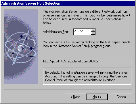

Click Next to accept the default port number for the Administration Server.
Accept the default, or enter a unique global configuration name for this installation of iPlanet Application Server.
- The iPlanet Administration Console requires this port number to administer the Directory Server.

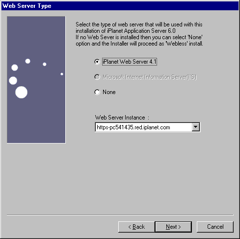

Select the Web Server type and instance that you have installed and running.
- The product key is in the Welcome letter you received with the product and is required before installation can continue.
- In case of multiple instances of iPlanet Web Server, select one to associate with iPlanet Application Server.
Note If you are using a Web Server other than IIS or iPlanet Web Server, you must enter the doc and cgi-bin directories.
To use the Apache Web Server, you must configure iPlanet Application Server to work with either the iPlanet Web Server or Microsoft Internet Information Server during installation. After installing the iPlanet Application Server, install and configure the Apache Web Server.
Make sure to set the registry key permissions for the \SOFTWARE\iPlanet key to Full Control for all options.
- For more information on how to install and configure the Apache Web Server, see "Configuring Apache Web Server"

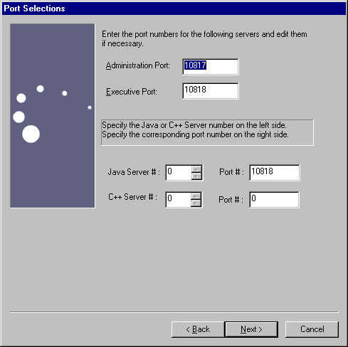

Enter the port numbers for the Administrative Server (KAS), the Executive Server (KXS), the Java Servers (KJS), and C++ Servers (KCS).
Next up are panels that enable you to configure database clients.![]()
Enter the iPlanet Application Server administrator's username and password.
- All port numbers you specify for listener ports must be within the acceptable range (1 to 65535), and must be unique (not used by any other applications on your system).
Note If the port number is already in use, the service does not start up when you run iPlanet Application Server.
- Enter the number of Java Servers (KJS) and C++ Servers (KCS) to use to process applications.
- The default values are 1; increase these values to handle high processing loads. You can also adjust the values after installation using the Administration Tool. See the iPlanet Application Server Administrator's Guide for more information.

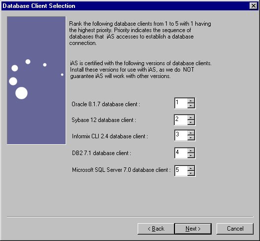

To Set the Database Client Priority
- Rank the installed database clients in order of connection priority.
- The installation program lists all supported database clients. The clients allow your applications to connect to your database back ends. Rank the clients according to connection priority, whether you've installed them yet or not. Client software can be added after installation. Sample applications are configured for the highest priority database.

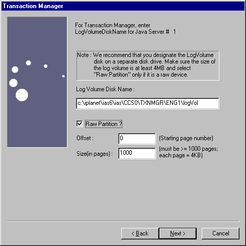

To Configure the Transaction Manager
Specify whether or not to enable global transactions.
If you specified "Yes" to global transactions, enter the mirror directory path where the transaction manager restart.bak file for each KJS engine process gets stored.
- Accept the default, or enter the log volume disk name where the Transaction Manager log file is to be stored for each Java Server.
- We recommended that you specify a path on a separate disk drive. Indicate if the specified disk name is a raw partition by checking the box next to Raw Partition?.
- Enter the path to the raw partition using the syntax: \\.\F:, where F is the drive letter.
- If the log volume is a raw partition, indicate Offset (starting page number) and Size (number of pages) in the raw partition. Make sure the size allocated for the log file is greater than 4 MB; the file should be greater than or equal to 1000 pages, at a size of roughly 4 KB per page.

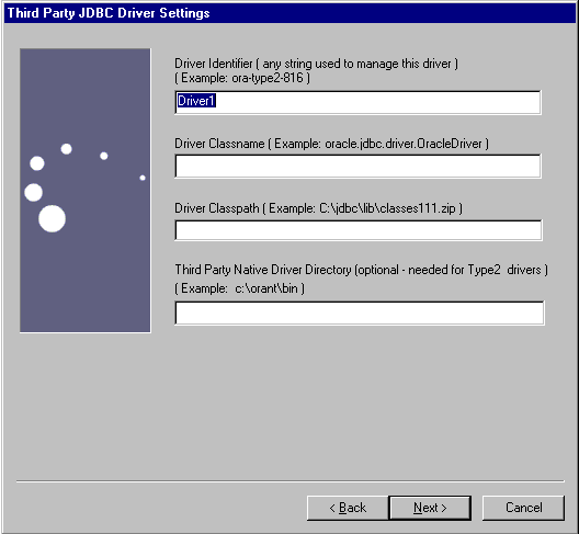

To Configure Third Party JDBC Drivers
Enter whether or not you are using third party JDBC drivers on the Third Party JDBC Support panel.
For each third party JDBC driver, enter the driver's identifier, classname, and classpath; formatting each entry as shown in the wizard's examples.
- If you answer yes, enter the number of drivers you want to configure before clicking Next.
Note PointBase database server and its third party JDBC driver is automatically registered with the Administration Server. It also populates the sample databases of e-Store, J2EEGuide, Database, and Bank sample applications.
After installation you must register the datasource for the third party JDBC drivers. For more information, see "Configuring JDBC Datasources for Your Applications".

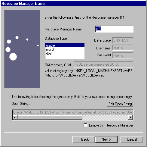

To Configure the Resource Manager
Indicate whether or not you want to configure any Resource Managers at this point in the installation. If you do, specify the number of Resource Managers you will use.
Next up are configuration options for setting up iPlanet Application Server clusters.
Accept the defaults or enter new information for each Resource Manager.
- Configure one resource manager for each database back end that you want to connect to. Resource manager lets you connect to a database back end for global transactions. For more information on configuring the Resource Manager, see "Configuring the Resource Manager".

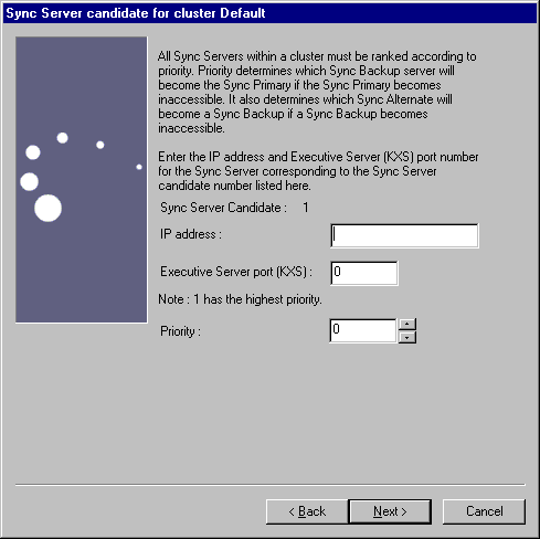

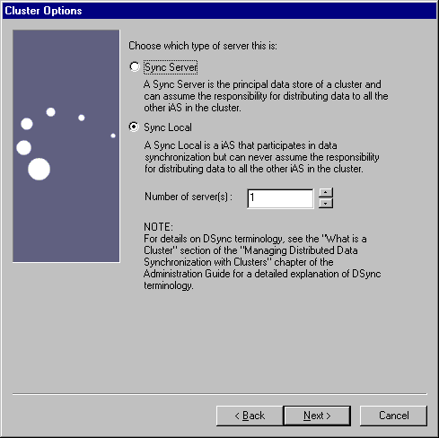

Select "Yes" if you intend to synchronize session and state information across multiple servers for failover and fault tolerance.
Enter the name of the cluster that this instance of iPlanet Application Server participates in.
Click on Sync Server or Synch Local to indicate whether this iPlanet Application Server is a synchronization server (Sync. Server) or a local server (Sync Local.)
Enter the total number of synchronization servers that you plan to have in this cluster.
If this server is a synchronization server (you selected Sync Server in the previous step) enter its IP address, Executive Server (KXS) port number, and its priority number for taking over as the primary synchronization server.
- A Sync Local server uses data synchronization services, but is not eligible to become a Sync Primary or the Sync Backup Server.

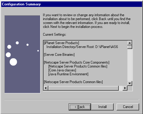

Click Install to complete the installation process.
- For more information on setting up sync servers, backups etc., see "Configuring Clusters and Data Synchronization".
- Additional instructions for installing and verifying a simple cluster on the Windows platform are available at: http://developer.iplanet.com/appserver/samples/cluster/docs/nt-cluster.html
- You can scroll down the Current Settings list to verify your settings. Click Back to return to a previous panel to make corrections.
- The installation program notifies you when all of the iPlanet Application Server files are in place. Select OK on the final dialog to reboot your computer, so that the new settings can take effect.
