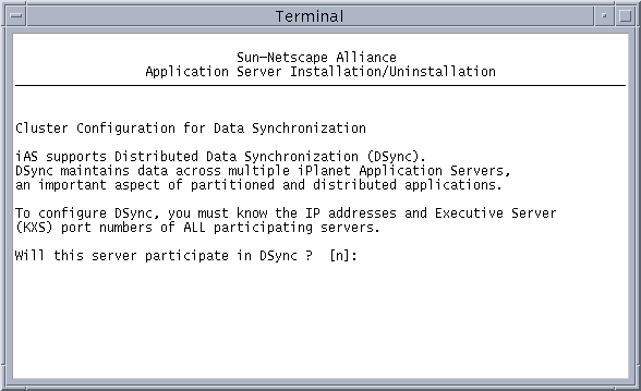

To Configure Clusters for Data Synchronization
Note You can configure your database connections effectively after installation by running the database setup tool, db_setup.sh, which is found in: <iASInstallDir>/bin.

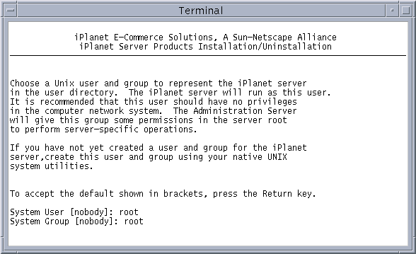

Enter the system user and system group names.
- You should have already set up this user and group prior to running the installation program. Typically, this user and group should be the same as that which installed the web server.
- Specify a user that has no privileges elsewhere on the system to avoid access to restricted servers, such as the configuration Directory Server.

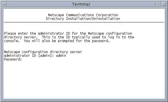

Assign the Administrator ID and password for the Configuration Directory Server.
- To enter a different name, type in the name and press Enter.
Press Enter to accept default username as admin, or type in a username and press Enter.

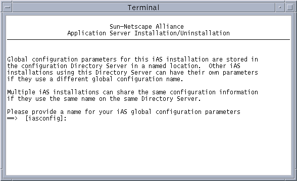

Press Enter to accept the default global configuration name or type a unique name for this installation of iPlanet Application Server.
- Depending on the configuration you are currently installing you may or may not want the locally installed Directory Server to be the instance which connects to iPlanet Application Server.
Enter the product key.
- This name is stored on the configuration Directory Server, under the o=NetscapeRoot tree, along with global configuration names of any other iPlanet Application Server installations.

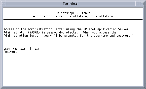

Enter the username and password to use for the iPlanet Application Server Administration Tool.
- If you intend to use more than one C++ server, enter the number and their default port number(s).
- All C++ port numbers are listener ports and must be within the acceptable range of 1025 to 32768. Port numbers must be unique (not used by any other services on your system).
Note Record the username and password. After installation, you'll need them to register iPlanet Application Server with the iPlanet Application Server Administration Tool.

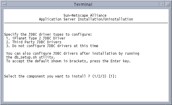

iPlanet Application Server supports iPlanet Type 2 JDBC drivers and third party JDBC database drivers.
To Configure Database Connectivity
This section includes procedures on setting up the database clients, Third party JDBC drivers, the Transaction Manager, and the Resource Manager.
Press Enter to install iPlanet Type 2 JDBC drivers by default, or 2 to install Third Party JDBC drivers, or enter 3 for none.
- We recommend that you use the third party JDBC drivers, since the proprietary iPlanet Type 2 JDBC drivers are to be deprecated in the next major release.
To Set Up Third Party JDBC Drivers
Enter the number of Third Party JDBC drivers you need.
For each Third Party JDBC driver, enter the driver name, driver class name, and driver CLASSPATH. Follow the formats in the wizard examples. For more details, see "Preparing to Configure Third Party JDBC Drivers".
- The Third Party Native Driver Directory is required for Type 2 drivers only.
Note PointBase database server and its third party JDBC driver is automatically registered with the Administration Server. It also populates the sample databases of e-Store, J2EEGuide, Database, and Bank sample applications.
After installation you must register the datasource for the third party JDBC drivers. For more information, see "Configuring JDBC Datasources for Your Applications".

- To configure others, type a unique resource identifier, the database type to associate it with, as well as, the database server name, administrative user name and password.

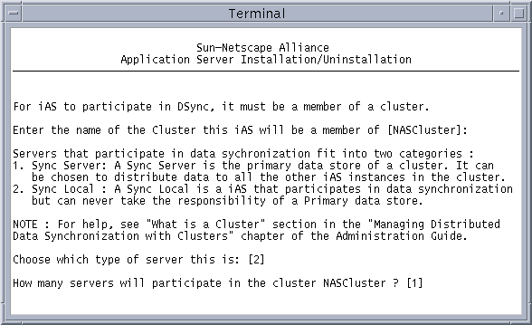

Enter y and press Enter to set this iPlanet Application Server instance to participate in data synchronization. The default is no (n).
This completes the configuration of your iPlanet Application Server installation. Continue with the next few steps to extract the packages and complete the installation.
If you answered yes in the previous screen, you are asked to:
- This sets up the synchronization of session and state information across multiple servers for failover and fault tolerance.
Enter the name of the cluster to which this instance of iPlanet Application Server belongs. The cluster may already exist, or this may be the first server assigned to the cluster.
Indicate if this iPlanet Application Server instance is to be a Sync Local or Sync Server instance.

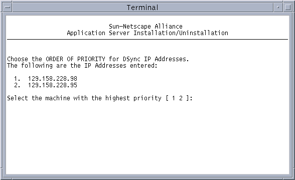

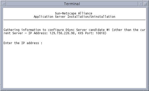

Enter the IP addresses and port numbers for each installation of iPlanet Application Server in the cluster. The IP address of the machine you are installing on is added by default (if it's a Sync Server).
- A Sync Local server uses data synchronization services, but is not eligible to become a Sync Primary or the Sync Backup Server. For more information on Sync Servers and Sync Local, see "Configuring Clusters and Data Synchronization"
Enter the priority for each Sync Server. Start with the highest priority Sync Server in the cluster. This is the first server to take over if Sync Primary fails. Enter each Sync Server's priority until all are ranked.
- These IP addresses and port numbers must match across installations for the cluster to function properly.

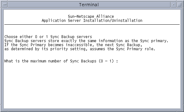

Specify the number of Sync Backup servers that should be active while the cluster is running.

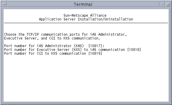

Use Custom Installation to assign different port numbers.
Store configuration data on the primary directory server in "iasconfig1", "iasconfig2", and so forth.Set up different home directories for each instance, like:

Enter the port numbers for KAS, KXS, KJS, KCS, etc.
