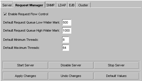

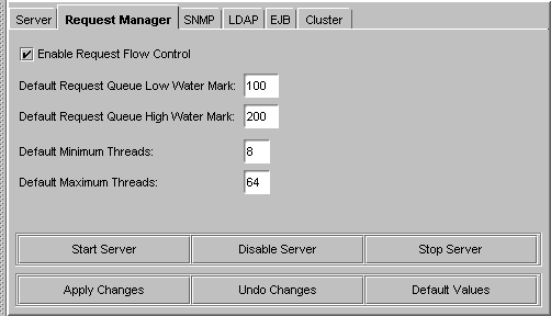

To Control Request Flow at Server Level
To control the flow of requests at the server level, perform the following tasks:
  1. On the iASAT toolbar, click General to open the General window.
  2. In the left pane of the General window, select the server in which you want to control request flow.
  3. Click the Request Manager tab from the right pane of the General window.
  4. Mark the Enable Request Flow Control checkbox to enable flow control.
  5. In the Request Queue Low Water Mark text box specify the number of requests that should be available in the queue, which will trigger request logging.
    This number is only applicable after the maximum number of requests in the queue has been reached. See the next step.
  6. In the Request Queue High Water Mark text box specify the maximum number of requests for the queue.
    When this number is reached no more user's requests will be accepted until the request queue reduces to the number specified as the low watermark.
  7. Click Apply Changes to save your changes.

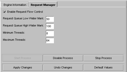

To Control Request Flow at Process Level
You can also customize the request flow for a process. Note that the numbers you specify for a process will be accepted as default for that process. The process level setting overrides the server level setting
To adjust the request flow for a process, perform the following tasks:
  2. In the left pane of the General window, select the server for which you want to control request flow. Expand the server to view its processes.
    Note You can expand a server in the hierarchical tree only when it is running.
  3. Click the Request Manager tab in the right pane of the General window.
  4. Click the Enable Request Flow Control checkbox to enable flow control.
  5. In the Request Queue Low Water Mark text box enter the number of requests in the queue in which logging will resume.
  6. In the Request Queue High Water Mark text box enter the maximum number of requests for the queue.
    These setting override the default settings at the server level.
    Note Settings that are specified at process level override those set at the server level.

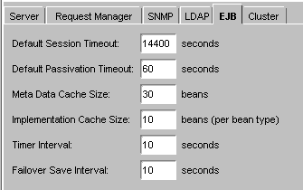

To Specify EJB Container Parameters for Run Time
iPlanet Application Server provides an EJB container that enables you to build distributed applications using your own EJB components, and components from other suppliers. When you configure iPlanet Application Server for your enterprise, you must set the EJB container's declarative parameters. These parameters determine, for example, session timeout when an EJB is removed after being inactive for a specified number of seconds. Set these parameters using the editor in iASAT.
To access the editor, perform the following tasks:
  2. In the right pane of the General window, click the EJB tab to open the EJB container declarative parameters editor.
    The following window appears:
    The editor allows you to set the following values:
    • Default Session Timeout
      If an EJB is not accessed for the specified number of seconds, it is removed. This applies to stateful session EJBs.
    • Default Passivation Timeout
      Time (in seconds) that elapses before the state of the EJB is written to disk. This value must be less than the session timeout value.
    • Metadata Cache Size
      The metadata cache for EJBs, whose value is in number of EJBs.
    • Implementation Cache Size
      Maximum cache size is in number of EJBs.
    • Timer Interval
      How frequently (in seconds) the EJB pool checks to see if it should passivate or remove an EJB.
    • Failover Save Interval
      How frequently (in seconds) the EJB state is saved. If the server fails, the last saved state of the EJB can be restored. Data saved is available to all engines in a cluster. This value is set on a per server basis and applies to EJBs that were deployed with Failover option enabled (on the General tab of the Deployment Tool EJB descriptor editor).
  3. Click Apply Changes to save your changes.
  4. Restart iPlanet Application Server for the changes to take effect.

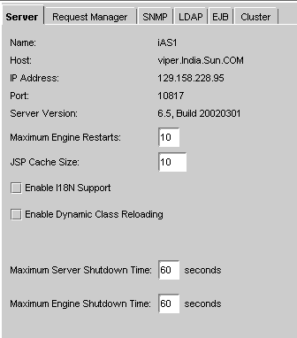

To Specify Maximum Number of Engine Restarts
When a process, such as Executive Server (KXS), Java Server (KJS), C++ Server (KCS) or Corba Executive Server (CXS) fails, the Administrative Server restarts it. You can set the restart option to either increase or decrease the number of times that a process is restarted. Fault tolerance and application availability are increased when all processes are running smoothly.
To adjust the restart option of the Administrative Server, perform the following tasks:
  2. In the left pane of the General window, select the iPlanet Application Server instance whose Administrative Server restart option you want to adjust.
  3. Open the Server tab from the right pane of the General window.
  4. Specify the new restart value in the Maximum Engine Restarts text field.
  5. Click Apply Changes to save your changes.
To Enable Internationalization Support
You can enable iPlanet Application Server to support applications in languages belonging to different geographic locations.
To enable internationalization, perform the following tasks:
  2. In the left pane of the General window, select the iPlanet Application Server instance for which you want to enable internationalization.
  3. Click the Server tab in the right pane of the General window.
  4. Mark the Enable I18N Support check box.
    Note You must stop and restart the server for your changes to take affect. See "Performing Administrative Tasks Using iPlanet Registry Editor" for information.
To Cache JavaServer Pages (JSP)
You can specify the number of JSP pages that are cached by each KJS engine for each iPlanet Application Server instance. Caching JSPs optimizes application response time.
To set the JSP caching value of the Administrative Server, perform the following tasks:
  2. In the left pane of the General window, select the iPlanet Application Server instance for which you want to set the JSP caching value.
  3. Click the Server tab from the right pane of the General window.
  4. Specify the JSP Cache Size in the text field. The cache size is set on a per-page basis.
To Specify Maximum Server and Engine Shutdown Time
You can set shutdown values of the Administrative Server for both iPlanet Application Server and engine processes. For example, if you set a 60 seconds engine shutdown time, application tasks being processed are allowed 60 seconds for completion. No new requests are accepted after this period has elapsed. Specifying a shutdown value avoids a "hard" shutdown that will return errors to the client.
To set the server and engine shutdown time of the Administrative Server, perform the following tasks:
  2. In the left pane of the General window, select the iPlanet Application Server instance whose shutdown time you want to specify.
    Specify a Maximum Server Shutdown Time.
    The Maximum Server Shutdown Time is the maximum time taken to shut down iPlanet Application Server. After this time, any engines that are still running are killed. The server typically shuts down quickly unless it is heavily loaded.
  4. Enter a Maximum Engine Shutdown Time.
    The Maximum Engine Shutdown Time is the maximum time that iPlanet Application Server will wait for an engine to shut down. After this time, the engine will be killed, and the next engine(s) will be shutdown.

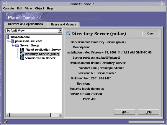

  1. Start iPlanet Console (on the machine in which the backup Directory Server is installed).
    On Windows systems, you can do this by opening the Start menu, and choosing Programs>iPlanet Server Products>iPlanet Console 6.5.
    On both Windows and Solaris systems, navigate to the <iASInstallDir> path, and type startconsole at the command line prompt.
  2. Select Directory Server, as shown in the following figure:
Figure 6-1
iPlanet Console screen
  1. Click Open to access the iPlanet Directory Server configuration screen.
  2. Click Configuration.

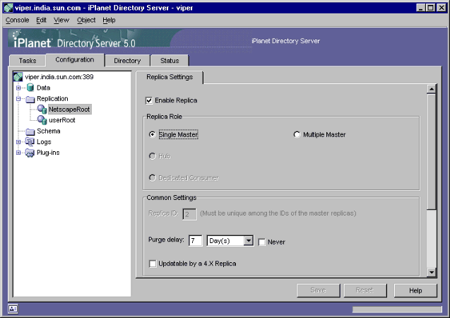

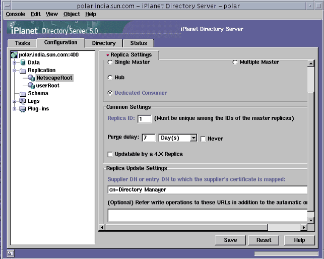

  1. Select Replication in the left pane.
  2. Expand Replication and select NetscapeRoot in the left pane.
    The following dialog appears.
Figure 6-3    Setting up backup directory server
  1. Select Enable Replica.
  2. Select Dedicated Consumer, to set this directory server to be the backup directory server.
  3. Enter a Replica ID number. This can be a number between 1 and 255.
  4. Enter the number of days after which entries will expire in the backup directory server.
    Select Never if you do not want to keep the entries made by the supplier.
  5. Enter a valid Distinguished Name in the Supplier DN text field, for example, cn=Directory Manager.
    If the supplier directory server is running a 4.x version of iPlanet Directory Server, enable the Updatable by a 4.X Replica. You will have to make additional settings in the Legacy Consumer Settings tab.
  6. Click Save to commit your modifications.
    This sets up your backup directory server. Next you have to configure the primary directory server, or the supplier, to send updates to the consumer you have just setup.

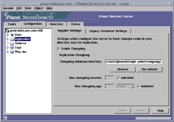

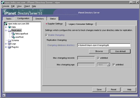

  3. Select Replication in the left pane.
    The following dialog appears:
Figure 6-4
Primary directory server
  1. Click Enable Changelog.
    You must select this option to proceed with the replication agreement procedure.
  2. Choose a directory to store the change log data.
    This is the directory where all the changes made to the directory server's settings are logged. Specify the changelog directory in the Changelog database directory text field. Click Browse to locate a directory, or click Use default to set the default changelog directory.
    The default directory is set to iASInstallDir/slapd-machine_name/changelogdb.
  3. Click Save to commit the changes you have made.
  4. Expand Replication and select NetscapeRoot in the left pane.
Figure 6-5
Setting up primary directory server
  2. Select Single Master, to set this directory server to be the primary directory server (supplier).
    To configure multiple supplier directory servers to a consumer, each holding the same subtree, select the Multiple Master option. For more information on configuring multi-master replication, see iPlanet Directory Server documentation.

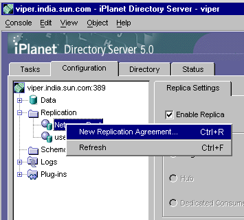

To Create Replication Agreement
Follow these steps to create the Replication Agreement between the two directory servers.
  1. From the primary directory server's console, right-click NetscapeRoot > New Replication Agreement...
Figure 6-6    Replication Agreement configuration

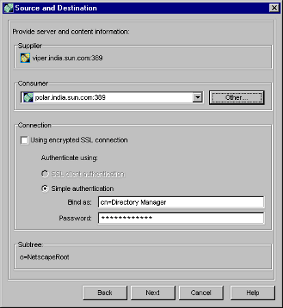

  2. Enter the URL of the backup (consumer) directory server alongwith your authentication credentials.
Figure 6-7
Specify the consumer and user credentials
    1. In the Consumer text field, enter the hostname of the machine on which the backup Directory Server is installed.
    2. Click Other. The Consumer Server Information popup window opens, as shown in the following figure:
    3. In the Host name text field, provide the host name of the machine on which the backup Directory Server is installed.
      In the Port text field, provide the Port Number, if it is different from the primary Directory Server machine's port number.
    4. Click OK to confirm. You can now see the consumer name in the Source and Destination window.
    5. Select Simple authentication for simple and direct authentication.
      Note If you want a higher level of security, you can choose encrypted SSL connection. If you choose this option, the user will be authenticated through a Secure Socket Layer (SSL) process. You will need to specify the subject DN of the certificate server. For more information, see iPlanet Directory Server documentation.
    6. Provide a valid Distinguished Name in the Bind As text field, which the primary server will use to bind to the backup directory server.
    7. In the Password text field, provide the password that you used during iPlanet Application Server installation.
      Note You can have multiple instances of iPlanet Application Server on a Solaris system. Ensure that the password you provide pertains to the iPlanet Application Server instance for which you are configuring a backup Directory Server.

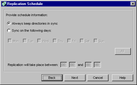

  1. Select the replication schedule you need.
Figure 6-8
Specify replication schedule
    • Select Always keep directories in sync, to keep the data current in both Directory Servers.
    • Select Sync on the following days if you want to schedule the data synchronization between the primary and backup Directory Servers. Data replication will occur during the period you specify on the selected days of the week.
    • Click All if you want to schedule data synchronization on all days of the week.

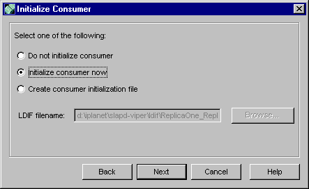

  1. Select the method you would like to use to initiate the connection to the consumer.
Figure 6-9    Consumer initialization options
    • Select Do not initialize consumer to stop replication at this point. If you choose this option, data is not replicated in the backup Directory Server.
    • Select the Initialize consumer now radio button. This option initializes the backup Directory Server immediately. The backup Directory Server is ready for replication.
    • Select Create consumer initialization file if you want to write the data to a file. Select a .ldif file for storing the data, which can be copied to the backup Directory Server later. See "Using LDIF to Add Entries to Directory Server", for more information.

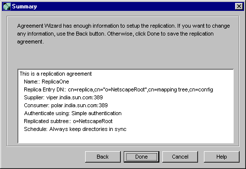

  1. The summary screen displays the values you have chosen.
  2. Click Done to complete the replication agreement procedure. Click Back if you want to make any changes.
    If you had selected initialize consumer now option in the Initialize Consumer screen, the backup directory server will now be updated by the primary directory server.
    Note Now you need to replicate cn=iasRoot. Follow the steps in "To Create Replication Agreement" to add this node as well to the replication scheme.
  3. You will get a confirmation message when the replication completes successfully.
    You can see the entries of the primary directory server in the backup, after replication completes.

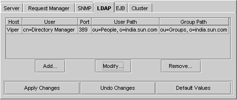

To Configure the Backup Directory Server in iASAT
Once the backup Directory Server is installed and replicated, you need to modify the primary Directory Server configuration to include the name and port number of the backup Directory Server, in iASAT. You can do this by performing the following tasks:
  2. Select the iPlanet Application Server instance for which you want to configure a backup Directory Server.

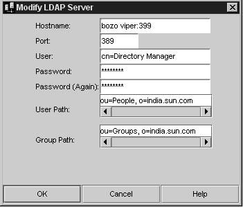

  3. Open the LDAP tab from the right pane of the General window. The following window appears:
Directory Server(s) associated with your iPlanet Application Server instance appears in this window.
  1. Select the primary Directory Server and click Modify. The following dialog box appears:
  2. In the Hostname field, insert a space after the existing hostname and enter the name of the machine on which the backup Directory Server is installed (as shown in the figure given above). If the port number of the backup Directory Server machine is different, insert a colon (:) next to the hostname and specify the port number, for example, bozo viper:399
    You need to specify the port number only if it is different from the port number of the host.
  3. Click OK to close the window.
  4. Click Apply Changes to register the changes in iASAT.
  5. You need to stop and start iPlanet Application Server for the change to take effect.
The backup Directory Server is now configured. Note that you must always have at least one Directory Server configured to work with iPlanet Application Server.
Note To remove a Directory Server, select the required Directory Server in the right pane of the General window in iASAT, and click Remove.

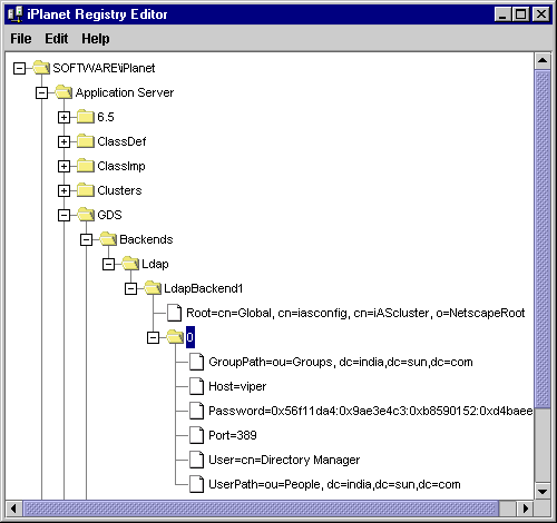

To Configure Registry Entries for Web Connector Plug-in
When you configure a backup Directory Server, iPlanet Application Server creates the necessary back-end entries in iPlanet Registry. However, in the case of a webless installation of iPlanet Application Server, where iPlanet Application Server and the web-connector are installed on different machines, you have 2 instances of iPlanet Registry. You need to update iPlanet Registry entries on the web-connector, with the host name and port number of the machine on which the backup Directory Server is installed.
To update iPlanet Registry with the backup Directory Server details, perform the following tasks:

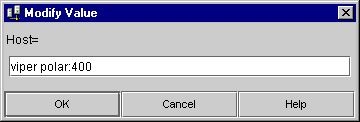

  1. Start iPlanet Registry (on the machine where the web-connector is installed).
  2. Open the following key:
    SOFTWARE/iPlanet/Application Server/GDS/Backends/Ldap/LdapBackend1/0/
  3. Select the Host=<hostname> value.
    Double-click the value to open it, or choose Modify Value from the Edit menu. The Modify Value dialog box appears.
  4. Insert a space after the existing hostname and enter the name of the machine on which the backup Directory Server is installed. If the port number of the backup Directory Server machine is different, insert a colon (:) next to the hostname and specify the port number.
Figure 6-10
Adding the consumer directory server in the registry
  1. Stop and start iPlanet Registry editor for the changes to take effect.
