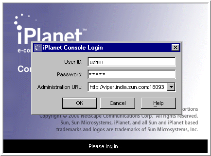

- The iPlanet Console login dialog box appears:
In the Password field, type in the password that you provided for the iPlanet Console Administration Server, during iPlanet Application Server installation. iPlanet Console's main window appears, as shown in the following figure:

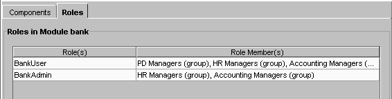

Open the application folder and highlight a servlet or EJB icon, as shown in the following figure:
In the right pane of the Application window, click the roles tab to view the roles and role members that have been defined for this EJB/servlet.

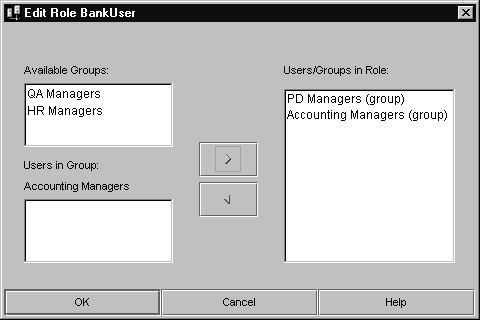

Highlight the role that you want to manage and click Edit Role, at the bottom of the window.
To add a group and a user to a role, complete the following:
- The Edit Role dialog box opens showing you all the users and groups that are currently members of this role.
To add a group to a role, in the Available Groups box, highlight one or more groups and click the right-arrow button.
To remove a group or user from a role, highlight the user(s) and or group(s) in the Users/Groups in Role box and click the left-arrow.
Note When you select multiple groups from the Available Groups box, the users in the Available Users box are not displayed.
To add a user to a role, first highlight a group to which the user currently belongs from the Available Groups list and then highlight the user(s) in the Users in Group box. Finally click the right-arrow button to add the user to the role.

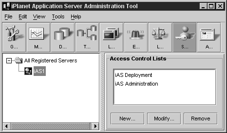

You need to use iASAT to create and manage access control lists (ACLs). When creating an ACL, you can create groups to which users belong and add only groups to the ACL rather than adding individual users as members to the ACL. This is useful if you are using individual user-based security; you save the administration maintenance of updating users in the ACL when users change.For example, if you have created users for an intranet application and a user leaves the company, you need to remove that user only from the appropriate group or groups, as opposed to removing the user from the groups and any ACLs.
To create an access control list, perform the following steps:

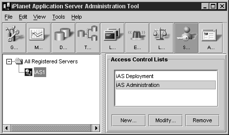

On the iASAT toolbar, click Security to open the Security window.

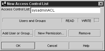

Click New. The New Access Control List dialog box appears, as shown in the following figure:
In the Access Control List text field, enter a name for the ACL.

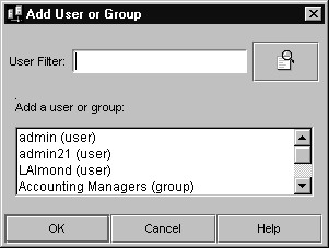

To add a user or group to the ACL, click Add User or Group.
- The name can be any word or words you choose to distinguish one ACL from another.
Select the users and/or groups you want to add to the ACL.
Click OK.
- You can filter the list of users that appears in the result set by entering a string in the User Filter text box. For instance, to show only user IDs that begin with "F," enter F* in the User Filter text box, then click the icon next to the User Filter text box. The user IDs matching your filter criteria appear in the list box below. The User Filter applies only to users, not to groups.
To add a new permission to the ACL, click New Permission.
Provide a new permission action word.
Click OK.
- A permission defines the level of access a user or group has to a particular application or part of an application.
To set the appropriate permissions for the groups in the ACL, check each permission for that group.

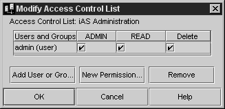

Click Modify. The Modify Access Control List dialog box appears.
To add a new user or group, click Add User or Group. The Add User or Group dialog box appears.
Select the group or groups you want to add to the ACL.
Click OK.
- You can filter the list of users that appear in the list by entering a string in the User Filter text box. For instance, to show only user IDs that begin with "F," enter F* in the User Filter text box, then click the icon next to the User Filter text box. The user IDs matching your filter criteria appear in the list box below. The User Filter applies only to users, not to groups.
In the Modify Access Control List window, click New Permission to create a new permission.
Provide a new permission such as Read, Write, in the Permission text field and click OK.
In the Modify Access Control List window, you can edit the permissions for a group, by selecting or deselecting the checkboxes next to the permissions.
