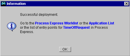

- If deployment succeeds, an Information dialog box appears. A sample is shown in Figure 10-2:
Figure 10-2    A successful deployment brings up the Information dialog box ![]()
From the Information dialog box, you have two main choices:
After you deploy the application, it is available for use.
Click OK to close the dialog box and resume working in Process Builder.
Click one of the highlighted links (Process Express Worklist, Application List, or the application name) to launch Process Express at a particular location.

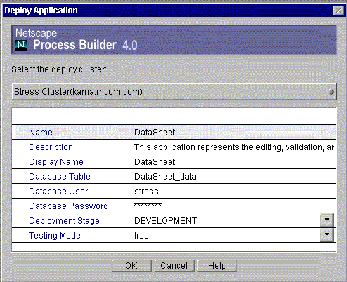

Figure 10-3 shows the Deploy Application dialog box, where you enter deployment information.
Figure 10-3    The Deploy Application dialog box ![]()
Name. The name of the application that appears in the list of applications. You cannot edit this field.
Description. A longer description of the application. This description appears in Process Express. The user has to have enough information between the Display Name and the Description to identify the application they want from a list of applications, so it's important to make these two fields descriptive.
Display Name. The longer, more descriptive name displayed by Process Express. If you are updating an existing application by saving it with a new application name, you can still keep the same Display Name, so that the name users see can be the same from version to version of the application.
Database Table. The table in the database where the data for the application is stored. This table is created automatically when you deploy the application. The table name for each application must be unique. This field defaults to the application name. Because the table name can be no more than 15 characters long, if your application name is longer, it truncates the application name. This field is required.
Database User. The user name for accessing the database where the application's data is stored. This field is required. This user can be your cluster database user, or you can use a more restrictive application-specific database user. The default is the cluster database user.
Database Password. The password used to access the database. This field is required. The default is the cluster database user password.
Deployment Stage. Indicates whether the application is in Development or in Production. The deployment stage governs what you can change in the application. In Development, you can change all application information. In Production, there are some application changes you are not allowed to make.
Testing Mode. This property designates whether the application is in testing mode or not. If set to true, the application is in testing mode. In testing mode all work items are assigned to the process initiator. You can deploy in testing mode in either the Development or Production stage. This field is required.
