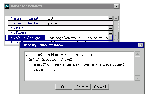

Event Handler Example
The following onValueChange script for a text field checks if the value of the text field is a number. If the value is not a number, it displays a dialog box with a warning and resets the page count value to 100 in case the user ignores the warning. If the value is a number, it does nothing. (Note that in event handlers, such as in client-side scripts, you must use single quotes instead of double quotes.)
var pageCountNum = parseInt (value);
if (isNaN (pageCountNum)) {
alert ('You must enter a number as the page count');
value = 100;
}Figure 11-1 shows the definition of this onValueChange event handler in the Inspector window in Process Builder.
Figure 11-1    A definition for an onValueChange event handler ![]()
Figure 11-2 shows a sample alert window in Process Express:
Figure 11-2    A sample alert window in Process Express ![]()
This script can be used directly as the value of the onValueChange property of the text field. The script uses parseInt() to convert the value of the text field from a string to a number. The value argument to the parseInt function is the name of a property of the text field. Since this script is used directly in the text field object, there is no need to say this.value, although the script would also work if written as:

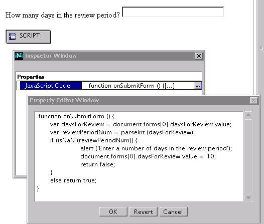

onSubmitForm Example
The following example shows an embedded client-side script that defines an onSubmitForm function. In this case, the script checks that the value entered in the daysForReview form element is a number. If not, the script displays a warning dialog box, sets the value of the daysForReview form element to 10, and returns false to give the user a chance to change the value and submit the form again.
Figure 11-3 shows an embedded client-side script that defines an onSubmitForm function in Process Builder:
Figure 11-3    A script that defines an onSubmitForm function ![]()

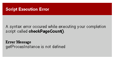

A script may contain undefined items such as functions, variables, or constants. When a script runs in Process Express and encounters an undefined item, Process Manager displays an error dialog box mentioning the item's name.For example, Figure 11-4 shows the dialog box that appears if a completion script misspells getProcessInstance().
Figure 11-4    Error message for undefined function ![]()

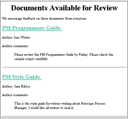

Automation Script
This script updates a link to a newly submitted document in a file that lists all documents available for review.This script could be used as an automation script in a process that enables writers to submit documents for review. In the entry point form, the writer uses a File attachment data field called docFileName to attach the document. Many different writers can use the application to submit documents. The file docList.html contains an active link for every document that has been submitted with this application. The file docList.html lives in the top level of the content store so that all process instances in the application can access it.
Two files are involved in the document list. The file docList.html is an HTML-formatted list of the documents with an active link for each document. The file showList.html contains opening HTML tags, the list of documents (which is the same as docList.html), and closing HTML tags. This script uses two files so that it can add the closing HTML tags after adding the information for the newly submitted document.
Figure 11-6 illustrates the showList.html web page. This page is updated each time a document is submitted for review.
Figure 11-6    A web page that is updated automatically ![]()
