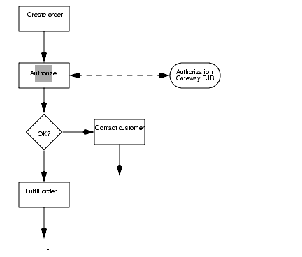

Your JavaScript process automation script can create an instance of an EJB and call the EJB's methods to perform business logic. For example, an order-entry application might create an instance of an EJB that represents a credit card authorization gateway. The application would call methods to check the credit card number, authorize the transaction, and create a charge on the account, as shown in Figure 12-1:
Figure 12-1    Programming logic for calling an EJB component

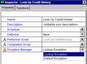

}If an exception is thrown, the process instance moves to the exception manager that you specify in the Inspector window, as shown in Figure 12-2:
Figure 12-2    Setting an exception manager in Process Builder ![]()
