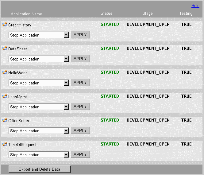

Once an application is deployed, Process Administrator maintains information about its state. As the administrator, you can change this information, and as you do so, Process Administrator keeps the application information up to date in the configuration directory.
Figure 5-1    The Deployed Applications page ![]()
Application states include both their status and their stage. An application's status indicates whether it is currently running or not. An application's stage indicates whether it is in development or production, and whether it is available to end users.
Started (On): End users and administrators can access the application to initiate and manage process instances and work items.
Administrators can stop started applications or start a stopped application.Stopped (Off): End users cannot initiate new process instances for the application and cannot execute actions on existing process instances.

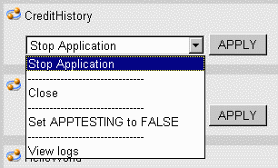

Among the actions that an administrator can perform on an application are stopping and starting it. These change its status, which is maintained in the configuration directory as part of the persistent application data that describes all instances of the application across the cluster.
Figure 5-2    Application administration actions ![]()
If an application is started and the administrator stops it, this shuts it down everywhere across the cluster. This sets the application's status to Stopped, which does not allow access to process instance detail by end users
If an application is stopped and the administrator starts it, this sets the application's status to Started, which allows full access to process instances and work items by end users and administrators.
When it starts an application, either as part of an autostart or as part of a manual start, Process Administrator performs these operations:

For the application you want to stop, choose the Stop Application command from the drop-down list for that application.

For the application you want to start, choose the Start Application command from the drop-down list for that application.

For the application you want to close, choose the Close Application command from the drop-down list for that application.

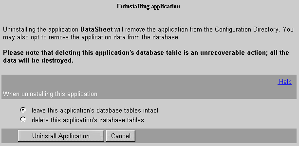

Check the radio button to leave the application's database table intact or to delete it, depending on your situation.
Click Uninstall Application to mark the application as obsolete.
Figure 5-3    The Uninstall Application dialog box ![]()
Now you and your end users cannot access the process instance detail for the application. End users cannot initiate new process instances or continue working on existing work items.
