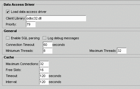

Database connections are maintained through iPlanet Application Server. You can set connection parameters in iPlanet Application Server (iAS) Administrator.To set the connection parameters, perform the following steps:
From Netscape Console or the Windows NT Start menu, launch iAS Administrator.
You can also set the minimum and maximum number of threads available for database connections. The thread parameters determine how many threads iAS allocates for asynchronous database queries. Such threads are usually used for queries returning a large number of rows and allowing the application to do other tasks while waiting for the query to finish. Asynchronous database queries are not supported by JDBC 2.0, a Java programming interface used to build on top on database drivers.On the iAS Administrator toolbar, click the Database button to open the Database window.
In the left pane of the Database window, click the database for which you want to adjust the timeout parameter.
In the right pane of the Database window, in the Connection Timeout field, enter the number of seconds.
The default thread allocations are adequate for most applications. If an application developer uses many asynchronous queries, you might want to increase the maximum number of available threads. Keep in mind that each thread does use a small stack allocation and pulls from the total number of available system threads. Therefore, if an application does not use any asynchronous queries, you can increase performance by setting the maximum available threads to zero.
To set the thread parameters, perform the following steps:
In the right pane of the Database window, in the Minimum Threads field, enter the number of threads.
The database cache is an array used to hold active and recently used database connections. iPlanet Application Server adds database connections to cache when an application creates a database connection.
In the right pane of the Database window, in the Maximum Threads field, enter the number of threads.
While the application is using that database connection, iAS marks that connection "in use." Once the database operations are finished, the server marks the database connection "free." The cache then holds the free connection in the cache for a configured period of time. This allows the server to use the free cached connection and quickly handle a new request to the same database. Once a free connection exceeds the timeout, a cleaning thread removes the connection from the cache and opens a slot for a new connection to be cached.
You can adjust the following cache parameters:
the maximum number of connections allowed in the cache
The default values are adequate for most applications, so adjustments are not usually required for initial application installations.the number of slots held solely for free connections
the timeout limit, in seconds, for free connections
the interval, in seconds, at which the cache cleaner thread removes timed-out free connections
iAS dynamically adjusts the cache up to the maximum number of allowable connections. If there are no connections to cache, the array is allocated to zero spaces.
In the right pane of the Database window, under Cache, enter values for the following parameters:
