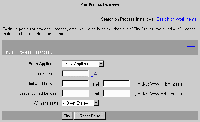

Finding Process Instances
You can get a list of process instances based on the values you enter for one or more of these fields. For more general, conceptual information, see About Process Instances and Work Items.
Note. If you enter no find criteria, all range fields default to "all-inclusive." Whatever criteria you specify are ANDed together, limiting the search to those process instances that fit all the criteria. If you enter a value in only the first part of a range, the criterion for that range becomes "after and including that data point." Likewise, if you only enter a value in the second part of a range, the criterion for that range becomes "up to and including that data point."
Figure 7-1    The Find Process Instances page ![]()
From application. Select "Any Application" or a specific application from the drop-down list.
Initiated by user. Enter the user ID of a Process Express end user.
Initiated between. Enter a from and to range of dates formatted as mm/dd/yyyy [hh:mi:ss]. Note that this field uses a 24-hour clock.
Last modified between. Enter a from and to range of dates formatted as mm/dd/yyyy [hh:mi:ss]. Note that this field uses a 24-hour clock.
With the state. Select "Open State" or a specific state from the drop-down list.

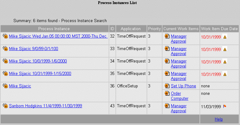

The Process Instances List
Once you submit your process instance criteria, the Process Manager displays a list of all process instances that meet your criteria.
Figure 7-2    The Process Instances List ![]()
The columns of data for the listing are:
Select: This radio box can be used to select/deselect many process instances at the same time. Multiple process instances can be suspended or resumed by selecting the radio boxes and hitting the "Apply" button.
(State Icon): An icon indicating whether the process instance is currently running (normal orange activity icon), suspended (dimmed out), completed (green), or terminated (X).
Process Instance: The name of the process instance, such as Joe's Timeoff Request. This name is a link to the Display Process Instance page for that process instance. (For details, see the next section, Administering a Process Instance.)
ID: The process instance ID number. With parallel processing applications, there may be multiple work items for a single process instance ID.
- Note: If the application is in the Testing stage, all process instances are renamed to the user ID of their initiator.
Application: The application that the process instance belongs to.
Priority: The priority level for the current activity. The default value is 3.
Current Work Items: The work items that are currently active. There may be several for a parallel processing application. If the item is an exception handler or a subprocess, a specific icon is displayed. For example, the last work item in Figure 7-2 is a subprocess. The work item is a link to the Display Work Item page.
Work Item Due Date: The date when the current activity is due to expire. Items that have already expired or that are about to expire show warning icons next to them. An alert triangle warns of an imminent expiration. A flag indicates a process instance with an already expired activity.

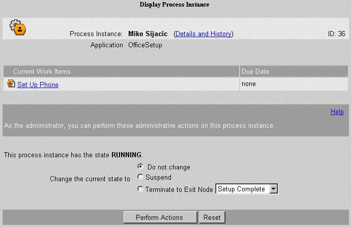

You can select an open process instance from the listings page and administer it by changing its state.To administer a process instance, follow these steps:
Click the link for a specific process instance in the Process Instances List page. The Display Process Instance page is displayed.
Figure 7-3    The Display Process Instance page ![]()
This page allows you to change the process instance's state.
Changing the State of a Process Instance
You can change the state of open process instances, but you can only change them to certain other states.To change a process instance's state:
Click the radio button that reflects your choice:
Do not change
Click Perform Actions to change the state.Suspend (suspend the process instance and all of its constituent work items)
Resume (resume a suspended process instance and any of its work items that are suspended to their previous state)
Terminate (abnormally terminate the process instance) If you choose this option, you must select the exit point you want to use as the designated termination activity. This automatically terminates its constituent work items. You can select any exit point in the process map to terminate a process instance.

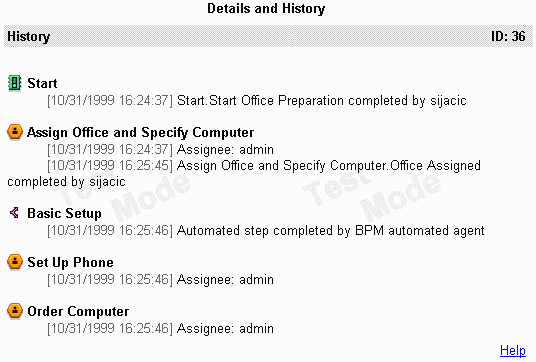

Viewing Details and History
The heading of the Display Process Instance page includes a link to the Details and History page. This provides a detailed history of every action users have performed for every work item for the process instance.To view the details and history page:
Go to Process Business Manager at http://yourServer/Business.apm.
Click the Process Instances tab.
Enter search criteria and click Submit.
Click a process instance link on the Process Instances List. This displays the Display Process Instance page.
Click the View Details & History link in the heading at the top of the page. This displays the details and history for that process instance.

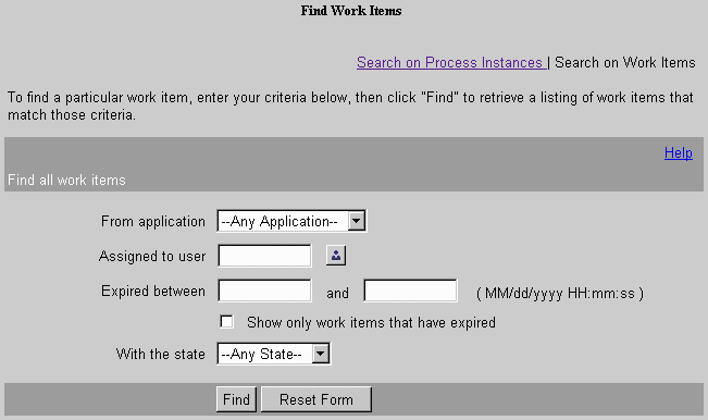

Finding Work Items
You can get a list of work items based on the values you enter for one or more of these fields.
Figure 7-5    The Find Work Items page ![]()
Assigned to user. Enter the user ID of a Process Express end user.
Expired between. Enter a from and to range of dates formatted as mm/dd/yyyy [hh:mi:ss]. Note that this field uses a 24-hour clock. This applies only to the work items of open process instances.
Show only work items that have expired. This checkbox allows you to limit the listing to only those work items that have expired. This applies only to the work items of open process instances.
With the state. Select "Any State" or a specific state from the drop-down list.

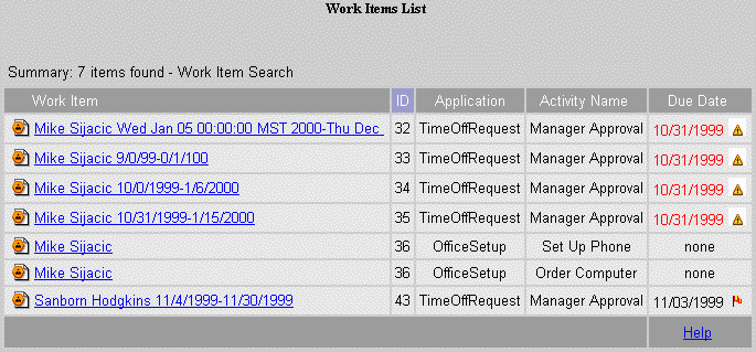

The Work Item List
Once you submit your work item criteria, Process Manager displays a list of all work items that meet your criteria.
Figure 7-6    The Work Items List page ![]()
Select: This radio box can be used to select/deselect many work items at the same time. Multiple work items can be suspended or resumed by selecting the radio boxes and hitting the "Apply" button.
(State Icon): An icon indicating whether the work item is currently available (orange activity icon) or suspended (dimmed out).
Work Item: The name of the work item. This name is a link to the Display a Work Item page for that work item. (For details, see the next section, Administering a Work Item.)
ID: The ID number for the process instance that this work item belongs to.
Application: The display name of the application for which this work item was created.
Activity Name: The name of the activity that the work item performs, as defined in Process Builder.
Due Date: The date when the current work item is due to expire. Items that have already expired or that are about to expire show warning icons next to them. An alert triangle warns of an imminent expiration. A flag indicates a work item with an already expired activity.

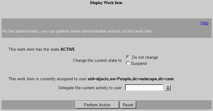

Click the link for a specific work item in the Work Item List page. This displays the Display a Work Item page for that work item.
Figure 7-7    The Display and Administer a Work Item page ![]()
The choices for actions you can perform are:
change the work item's state
This page allows you to change the work item's state.extend the current activity's expiration date (only displayed when the activity has already been flagged as expired)

You can only change the state of open work items, and you can only change them to certain other states.To change a work item's state:

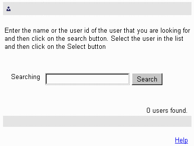

If you know the user ID for the person or group to whom you want to reassign the work item, enter it here.
If you do not know the user ID or group ID, click on the Find User icon. This displays the Find User page.
Figure 7-8    The Find User page ![]()
