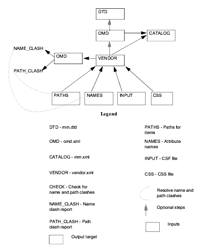

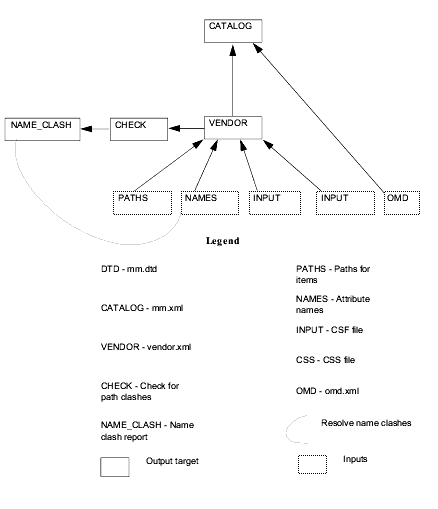

Figure  4-2	   Dependency Tree for Updating an Existing PMC Ontology
