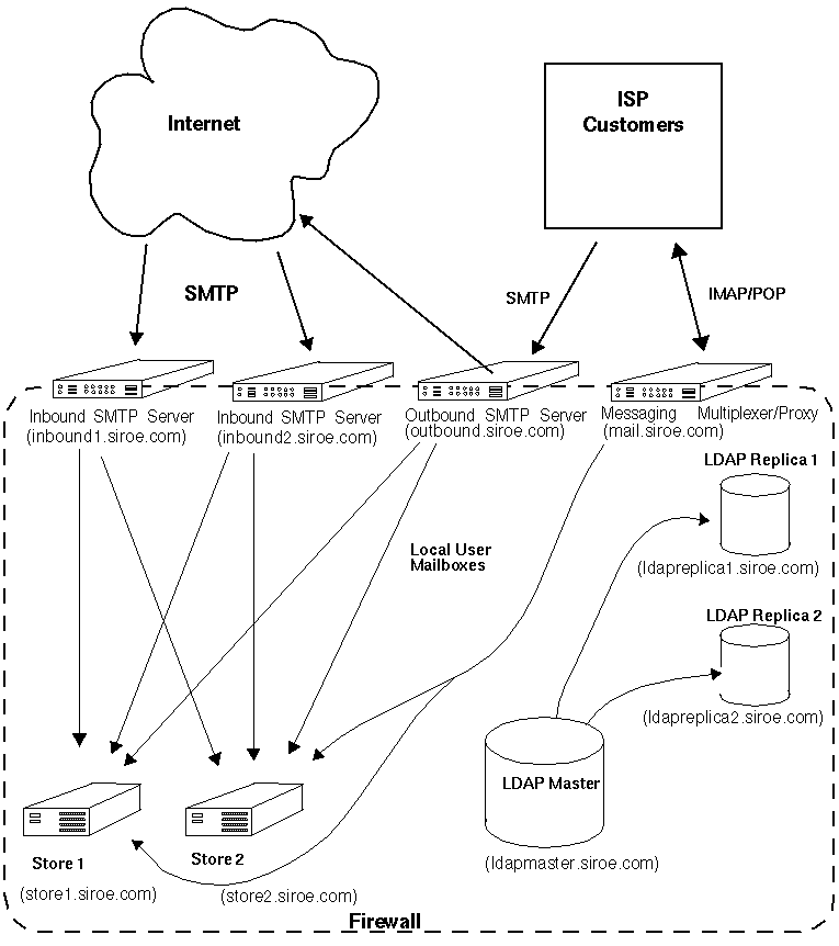

Topology for Multiple Server Scenarios
The scenarios in this section refer to the server deployment shown in Figure 4-1. The following assumptions are made:
Current system is either SIMS 4.0 or Netscape Messaging Server 4.15
2 inbound SMTP servers: inbound1.siroe.com & inbound2.siroe.com
1 outbound SMTP relay server: outbound.siroe.com
1 messaging multiplexor (MMP) proxy: mail.siroe.com
2 backend (message store) servers: store1.siroe.com & store2.siroe.com
1 LDAP master for user/group data and iPlanet Messaging Server configuration information: ldapmaster.siroe.com (port 389 for user/group server and port 390 for configuration server)
2 LDAP replicas: ldapreplica1.siroe.com & ldapreplica2.siroe.com
Note We highly recommend backing up your LDAP database prior to making changes to the directory server.
Figure 4-1    Multiple Server Sample Scenario ![]()
