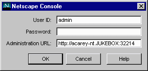

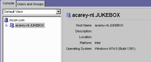

  1. From the Windows Start menu, under Programs, choose Netscape Server Family, then Netscape Console 4.0 to open Netscape Console.
  2. Enter a valid user name and password and click OK.

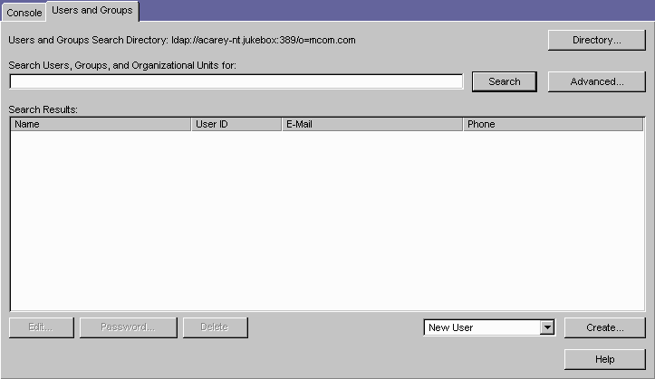

  3. Click the Users and Groups tab.

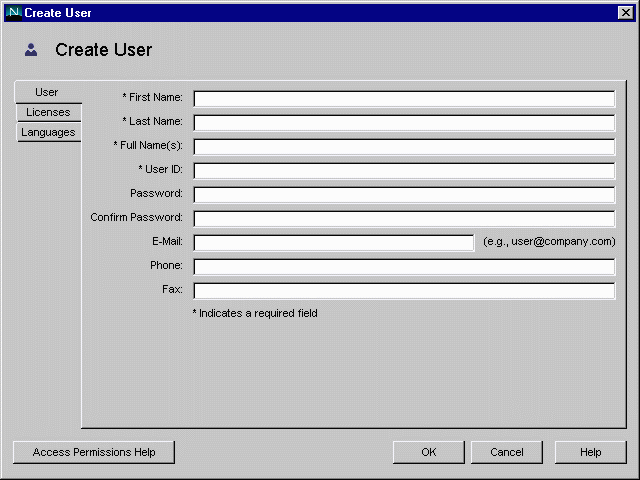

  4. Use the drop-down list in the lower-right corner of the window to choose New User, then click Create.

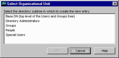

  5. In Select Organizational Unit, click the directory subtree (ou) to which the user will belong, then click OK.
  6. In the Create User window, enter user information.

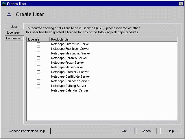

  7. Click the Licenses tab.
  8. Select the servers this user is licensed to use, then click OK.

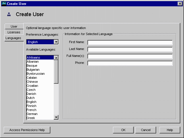

  9. (Optional) Click the Languages tab.

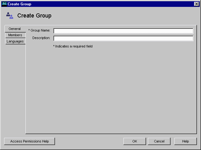

  1. In Netscape Console, click the Users and Groups tab to display the following window:
  2. Use the drop-down list in the lower-right corner of the window to choose New Group, then click Create.
  3. In the Select Organizational Unit window, select the directory subtree (ou) to which the group will belong, then click OK.

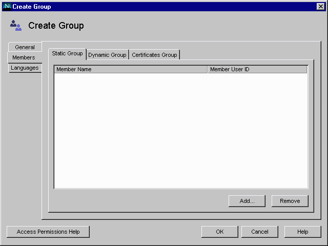

  4. In the Create Group window, enter group information, then click the Members tab.
  5. If you only want to create the group now and plan to add group members later, click OK and skip the rest of this procedure.
  6. In the Members window, click Add or Edit as appropriate.

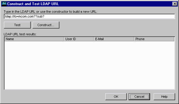

  5. Click Dynamic Group, then click Add.

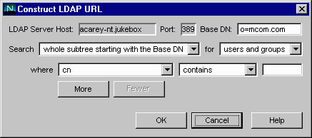

  6. Use the Construct and Test LDAP URL dialog box to specify the criteria for including users in the dynamic group.
  7. Click OK.
  8. (Optional) In the Construct and Test LDAP URL dialog box, to see a list of users and groups included in the dynamic group, click Test.
  9. Click OK.

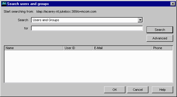

Before you can modify user or group data, you must first use the Users and Groups Search function to locate the user or group entry in the user directory. Then you can select operations from the menu bar to change the entry. The operations you perform apply to all in the Search list.
See Netscape Console documentation for more information.

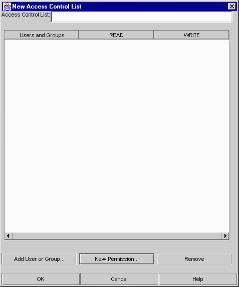

To create an access control list, perform the following steps:

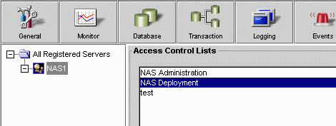

  1. On the NAS Administrator toolbar, click the Security button to open the Security window of NAS Administrator.
  2. Click the New button located at the bottom of the window.
  3. In the Access Control List field, enter a name for the ACL.

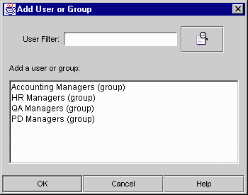

  4. To add a user or group to the ACL, click the Add User or Group button at the bottom of the dialog box.
  5. Select the users and/or groups you want to add to the ACL.
  6. Click OK.
  7. To add a new permission to the ACL, click New Permission.
  8. Enter the new permission action word.
  9. Click OK.
  10. To set the appropriate permissions for the groups in the ACL, check each permission for that group.

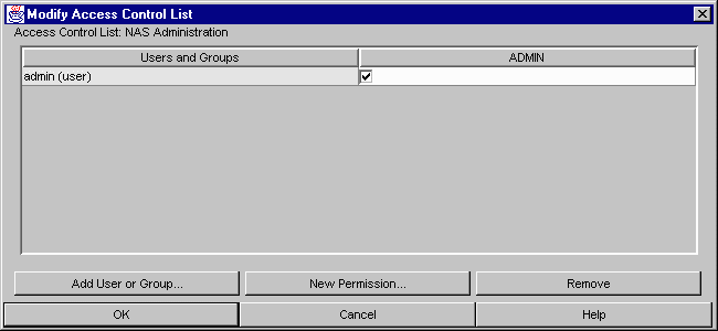

To modify an access control list, perform the following steps:
  2. Click the Modify button located at the bottom of the window.
  3. To add a new user or group, click Add User or Group.
  4. Select the group or groups you want to add to the ACL.
  5. Click OK.
  6. To create a new permission, click New Permission.
  7. To edit the permissions of a group, select or deselect the appropriate permissions for that group.
  8. To remove a group, select that group and click Remove.
