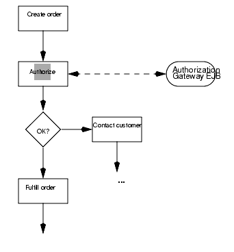

Your JavaScript process automation script can create an instance of an EJB and call the EJB's methods to perform business logic. For example, an order-entry application might create an instance of an EJB that represents a credit card authorization gateway. The application would call methods to check the credit card number, authorize the transaction, and create a charge on the account, as shown in Figure 16.1:
Figure 16.1    Programming logic for calling an EJB component

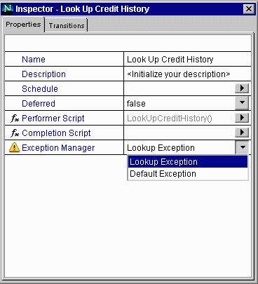

If an exception is thrown, the process instance moves to the exception manager that you specify in the Inspector window, as shown in Figure 16.2:
Figure 16.2    Setting an exception manager in Process Builder
