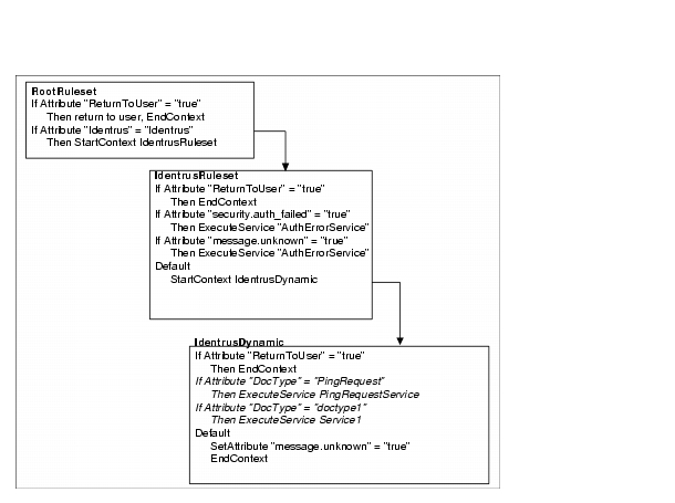

Default routing
In order to provide a simple development path for Identrus Messaging services, iPlanet Trustbase Transaction Manager provides a default routing mechanism for Identrus Messages. This default routing is applied to all Identrus Services developed and deployed as described in Chapter 8 Building Identrus solutions of this document.It is anticipated that this default routing will be sufficient for most Identrus Services in the near term. Where the default routing is inadequate, the developer must write new routing rules.
Router Rules
The updates made to the Router for version 2.2 of the iPlanet Trustbase Transaction Manager allow a very simple approach to basic rules handling to be taken. In previous versions of the system, all services had to define a set of rules that explicitly mapped the transport of a message to and from the service. Now that rules can be defined dynamically by the system, this basic behaviour can be automatically defined. We now discuss how this is achieved.
Routing to service
The deployment descriptor contained in the service JAR file will name the service that it contains. At system startup, the rules handler will determine which services are to be loaded, and for each service in the list will dynamically create a routing rule that forwards messages with the specified doctype to the service. If a service has a user-defined ruleset, the dynamically created rule will pass the message to this ruleset instead of directly to the service. This user defined ruleset lives in the JAR file with the service implementation and will normally not be required for services with simple message flows.
Return path
In order that the routing be kept as simple as possible, a message will be returned to a user if a specified attribute has been set on the message. This "ReturnToUser" attribute should be set by the service once processing is complete. This also applies to error messages produced at the service level.
Figure 3-2    Default routing rules

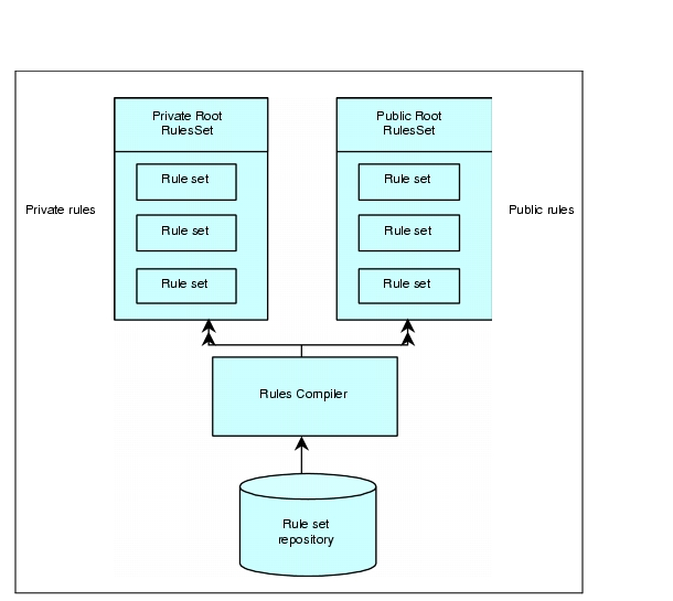

Routing Rulesets
The routing tables have two logical areas, one private and one public. Public rule sets may be added or configured through the management interface, private rule sets are used by iPlanet Trustbase Transaction Manager to provide basic services and may not be configured by the developer or systems administrator. At the top of this structure is the Root Rule Set which governs the way in which the private rules are executed and if none of the private rules match the parameters then the Public Root Rule Set is executed. System developers may then link their own task Rule Sets from this Rule Set (See Rule set definition in the next section)
Figure 3-3    Rule Sets
Each area contains a number of rule sets. Each public rule set will have a name, usually indicating the business task performed by the set of rules. The public rule sets are loaded from disk each time the platform starts up, and may be loaded explicitly by name as the result of a rule execution in the root rule set.
When a message is passed to the router, it will have already been associated with a context. Each context has an association with a rule set. This implies:
The message is operating in its root context, and has the root rule set associated with it.
Rule Sets are processed sequentially, and the first rule to match the current conditions is used. The router takes each rule from the rule set in turn, starting with the first, and attempts to match the message type with a rule pre-condition. If a match is found then the action is executed. If no match is found then an error condition is returned. It is important to bear in mind that because rules are processed sequentially it is necessary to keep the more explicit rules at the beginning of the rule set with more general rules occurring later. Otherwise it is entirely possible that a general rule could preclude other rules from ever being executed.The message is operating in a sub-context, and has a rule set from the public rules area associated with it.
The exception to this is if an iPlanet Trustbase Transaction Manager message is being processed in which case a private rule set will be associated.
It is considered good practice to keep the root rule set as small as possible. To achieve this, a rule in the root rule set should only match the first message in a business task i.e. an unsolicited message. The action should always be to start a new context, indicating the name of a rule set (and potentially the rule name to start at), that the message should be executed in. In doing this, the router will create a new context and associate the named rule set with it. The message will now be processed in the same manner.
A rule set is a single complete XML document that conforms to the DTD outlined in the next section. When the router starts up it looks in the Router section of the iPlanet Trustbase Transaction Manager initialisation file for the directory to find the rules that have been written by hand. It then looks for .xml files, and compiles these into the public rule set area. Each Rule Set contains zero or more rules as shown in the DTD fragment shown below:
