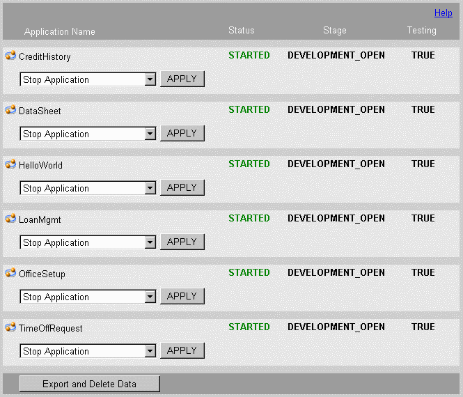

Figure 5-1    The Deployed Applications page
Application states include both their status and their stage. An application's status indicates whether it is currently running or not. An application's stage indicates whether it is in development or production, and whether it is available to end users.

Among the actions that an administrator can perform on an application are stopping and starting it. These actions change the application's status, which is maintained in the configuration directory as part of the persistent application data that describes all instances of the application across the cluster.

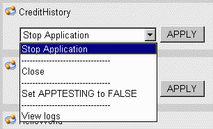

Figure 5-2    Application administration actions
If an application is started and the administrator stops it, this action shuts the application down everywhere across the cluster. This action also sets the application's status to Stopped, which does not allow access to process instance detail by end-users
If an application is stopped and the administrator starts it, this action sets the application's status to Started, which allows full access to process instances and work items by end-users and administrators.

- Choose the Stop Application command from the drop-down list for the application you want to stop.
- Select Apply.

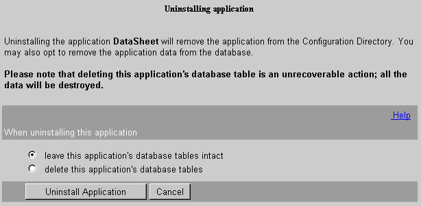

Occasionally, you may have applications that you no longer want to use, and that you want to remove from the end-user interface. You can uninstall a closed application. When you uninstall an application, you prevent end-users from initiating any new process instances from the New Process page.
When you choose the Uninstall command, you are asked if you want to delete the application-specific database tables. If you confirm the deletion, the application's user data is removed. If not, the data is left intact.

The Uninstall Application dialog appears.
- Check the radio button to leave the application's database table intact or to delete it, depending on your situation.
- Select Uninstall Application.
Figure 5-3    The Uninstall Application dialog box
Now you and your end-users cannot access the process instance detail for the application. End-users cannot initiate new process instances or continue working on existing work items.

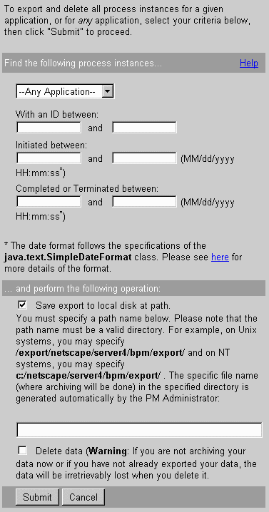

Figure 5-4 shows the Export and Delete Data dialog that appears:
Figure 5-4    The Export and Delete Data page
- Select a specific application or "Any Applications" from the drop-down list.
- Enter search criteria.
You search for process instances based on one or more of the following criteria:
- Check Save export to local disk at path to export the data.
Note On Windows NT, the disk must be local. You cannot use an NFS-mounted drive.
- Enter the absolute physical path to the folder in your local file system that you want to use for archiving.
If you checked the Save export... checkbox, you must enter a path or you get an error when you try to perform the operation.
- Check Delete data to delete the data.
You will lose any data that you have not exported previously or as part of this operation.
- Select Submit to export (and also delete if you checked the delete box) all the application data that meets your criteria.
Note You should export all data before deleting it.
You can delete data without archiving it, although this is a very risky action to take. This action is not recoverable.
