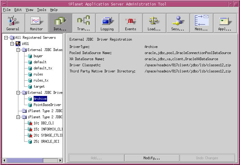

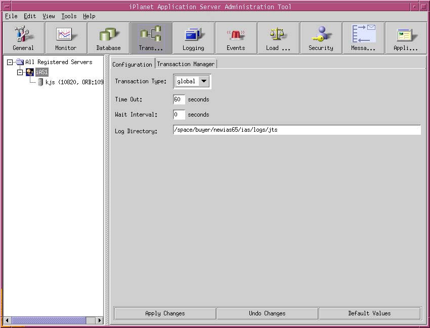

Enable Global Transactions in IAS
The Global Txns are enabled through the ksvradmin utility. This is found in <IASHOME>/ias/bin. Before running it, ensure that your DISPLAY environment is properly set.
The following screen image of ksvradmin shows how to enable Global transactions.
Verify the configuration details
From the ksvradmin utility you can check that all the data that you entered during db_setup.sh is correct. The following screen shows where to check:
Make sure that the changes are correct. If they are not correct, you can make the changes in kregedit in the following location:

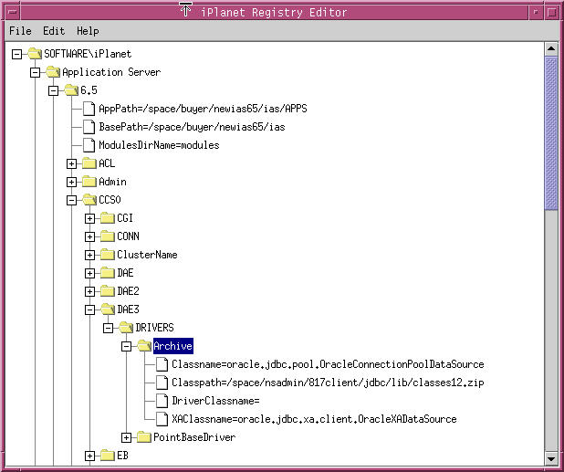

Software\iPlanet\Application Server\6.5\CCSO\DAE3\Drivers\<DRIVER_NAME>
The following screen shows the location.

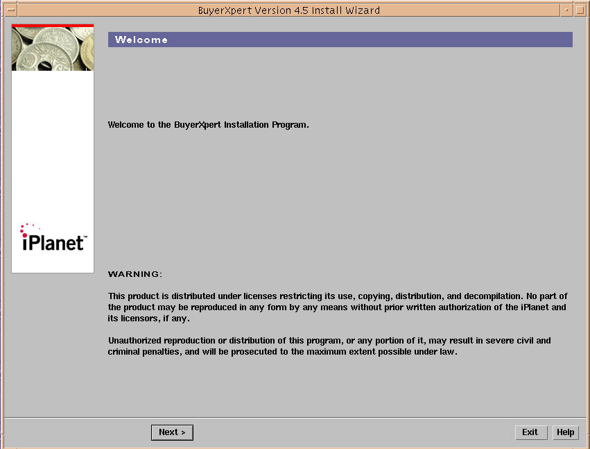

The Welcome screen displays.
Figure 4-1    ![]()
Welcome screen
Read the Welcome message.
Click the Next button to continue the installation.

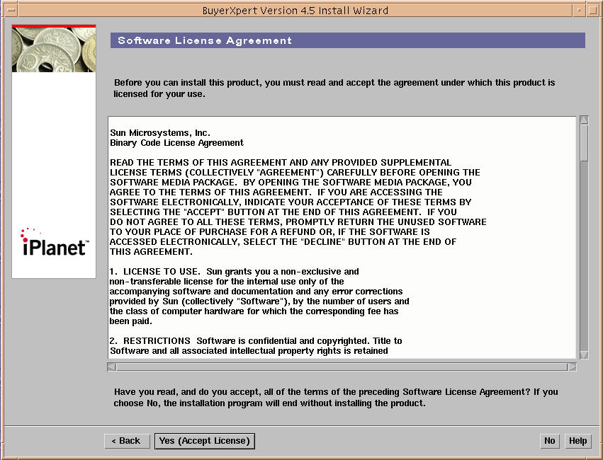

The Software License Agreement screen displays.
Figure 4-2    Software License Agreement screen ![]()
If necessary, increase the window size to make the entire agreement visible.
Click the Yes (Accept License) button to accept and continue the installation.

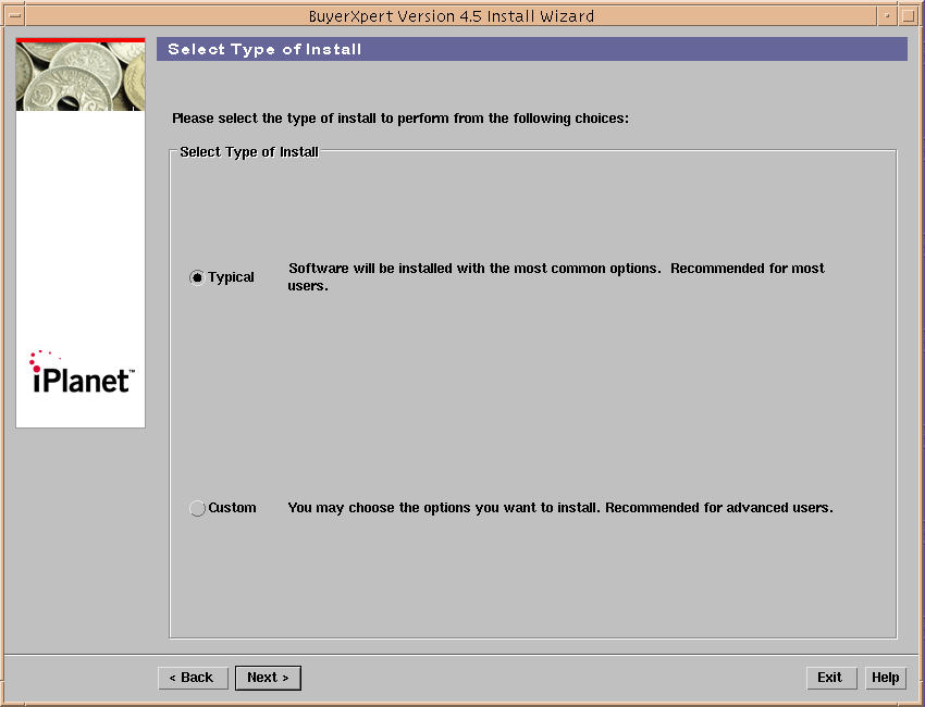

The Select Type of Install screen appears.
Figure 4-3    ![]()
Select Type of Install screen (with Typical option selected)
Select the Typical installation. Figure 4-4    Select Type of Install screen (with Custom option selected) ![]()
Or select the Custom installation option that uses default values to create schemas in the Oracle database for OMS, Auctions, RFx, and so forth, and that allows you to specify the Oracle tablespace options.

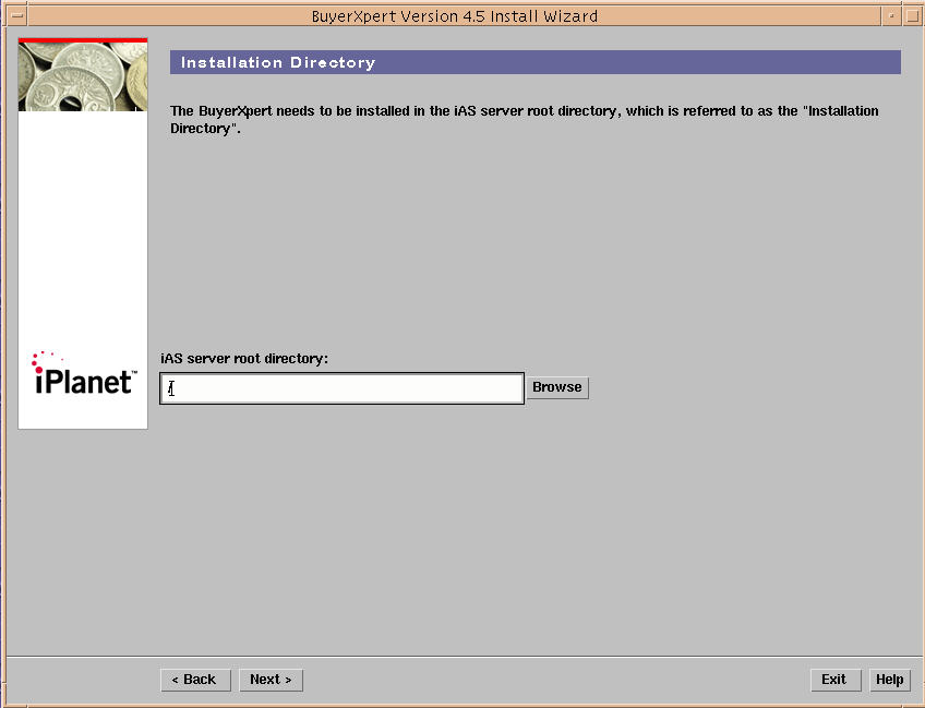

The Installation Directory screen appears.
Figure 4-5    Installation Directory screen ![]()
Enter the iPlanet Application Server Directory name where you want to install BuyerXpert (for example, /export/IPM6). This is typically the directory where the iAS server is located (IASROOT).
Or, select the Browse... button to search for a new location to install BuyerXpert.

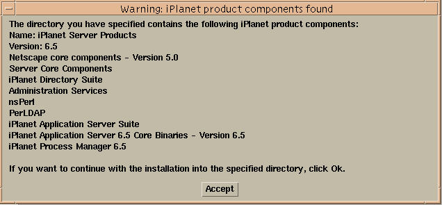

If you enter an existing directory that contains the iPlanet Application Server, the following warning appears after you click the Next button informing you of the existing directory.
Figure 4-6    ![]()
Warning screen
Review the components list.
Click the Accept button to continue the installation.

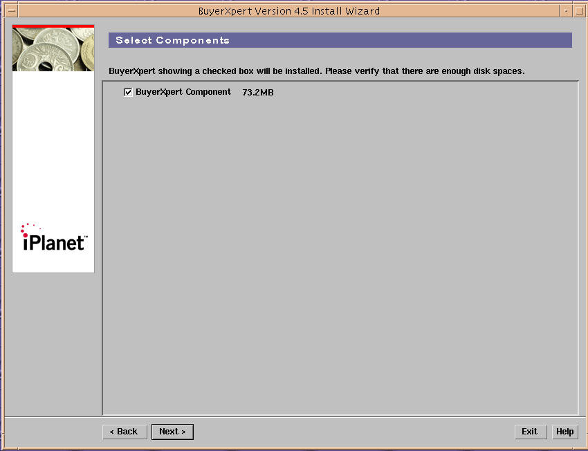

The Select Components screen displays.
Figure 4-7    Select Components screen ![]()
This page displays the size of the BuyerXpert component.
The BuyerXpert software is installed by default.

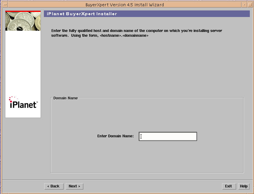

The Domain Name screen displays.
Figure 4-8    Domain Name screen ![]()
To find the hostname and domain name, type hostname or domainname at the UNIX prompt.
Enter the domain name in the following format:
<hostname>.<domainname>
For example, colonial.red.iplanet.com.

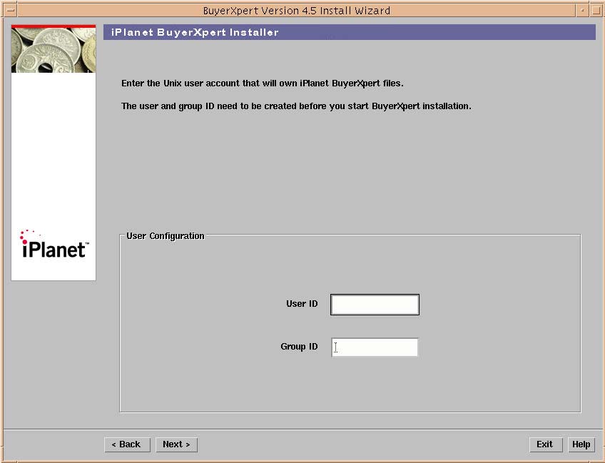

The User Configuration screen displays.
Figure 4-9    User Configuration screen ![]()
Enter the User ID.
The user and group IDs should be exactly the same as the user and group IDs that you specified during the iAS installation.
You can type id at a UNIX prompt to find out your current user and group ID.

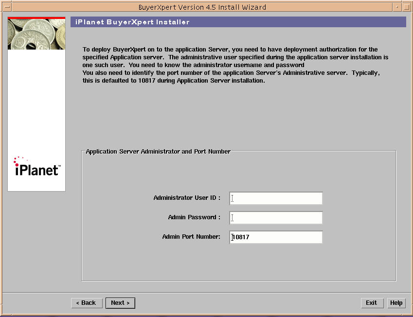

The Application Server Administrator and Port Number screen displays.
Figure 4-10    Application Server Administrator and Port Number screen ![]()
Enter the Administrator User ID.
This is the same Administrator User ID that you specified during the iAS installation.
Enter the Admin Password.
This is the same Admin Password that you specified during the iAS installation.
Accept the default for the Admin Port Number.
This is the same Admin Port Number that you specified during the iAS installation.

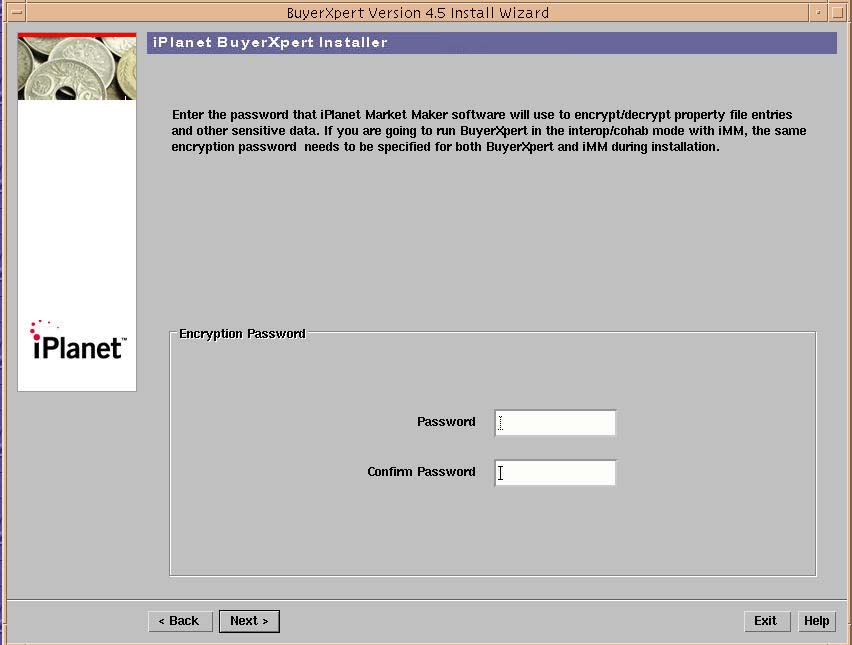

Enter the encryption password for encrypt/decrypt property file entries and other sensitive data.
Enter the password again to confirm.

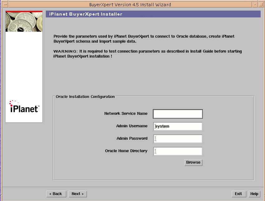

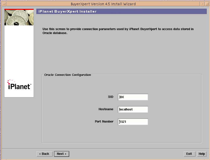

The Oracle Connection Configuration screen displays.
Figure 4-11    Oracle Connection Configuration screen ![]()
Enter the Oracle SID.
These values can be found in the tnsnames.ora file in the ORACLE_HOME directory.

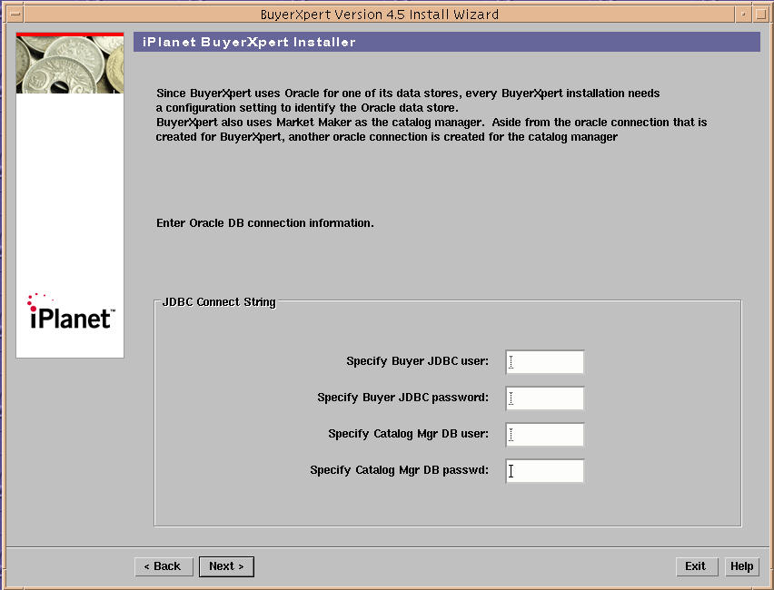

The JDBC Connect Sring screen appears.
Figure 4-12    ![]()
JDBC Connect String screen
Enter the Oracle user to be created for the buyer.
Enter the Oracle password to be created for the buyer.
Enter the Oracle user to be created for the Catalog Manager DB.
Enter the Oracle password to be created for the Catalog Manager DB.

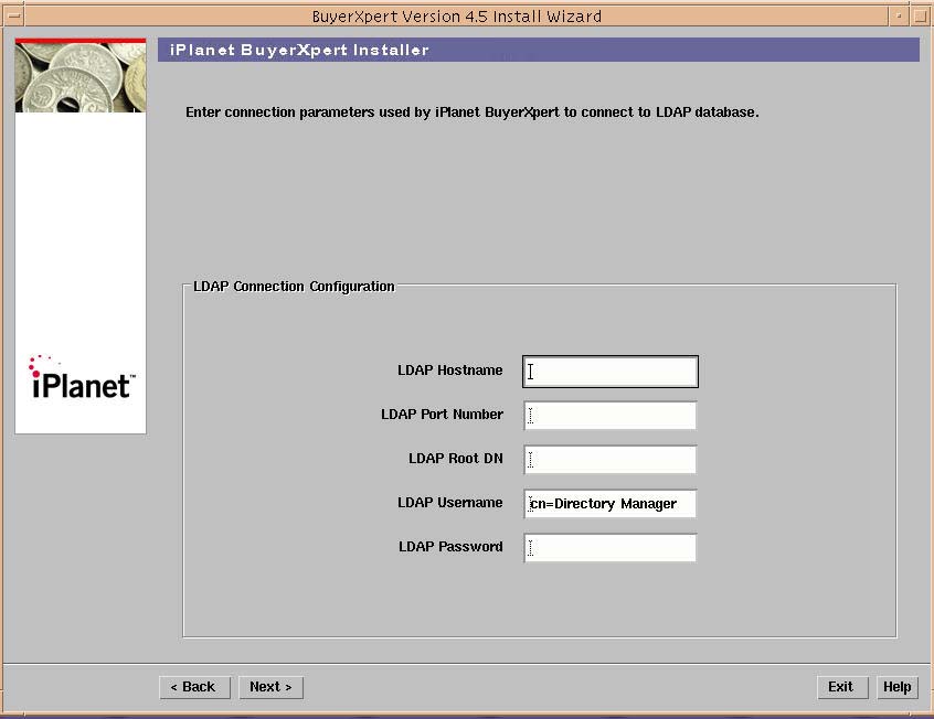

The LDAP Connection Configuration screen displays.
Figure 4-13    ![]()
Enter the LDAP hostname.
These configurations were specified during the creation of the iDS instance.

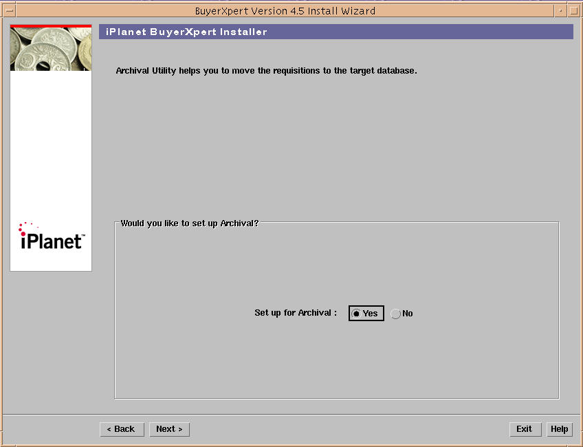

The Would you like to set up Archival screen displays.
Figure 4-14    ![]()
Select Yes if you want to set up PO archival.

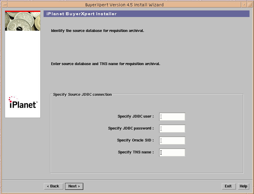

The Specify Source JDBC Connection screen displays.
Figure 4-15    Specify Source JDBC Connection screen ![]()
Enter the JDBC user name.

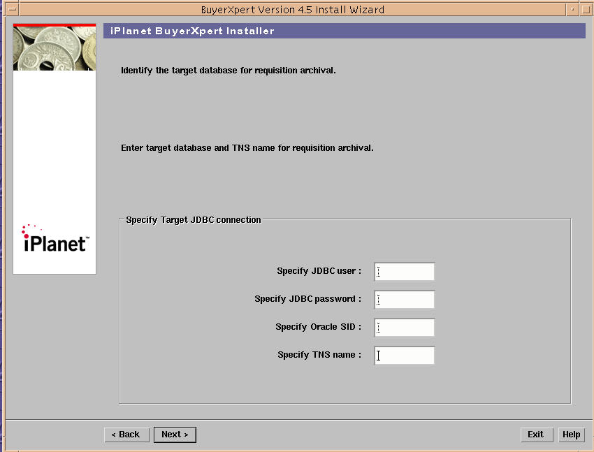

The Specify Target JDBC Connection screen displays.
Figure 4-16    Specify Target JDBC Connection screen ![]()
Enter the JDBC user.

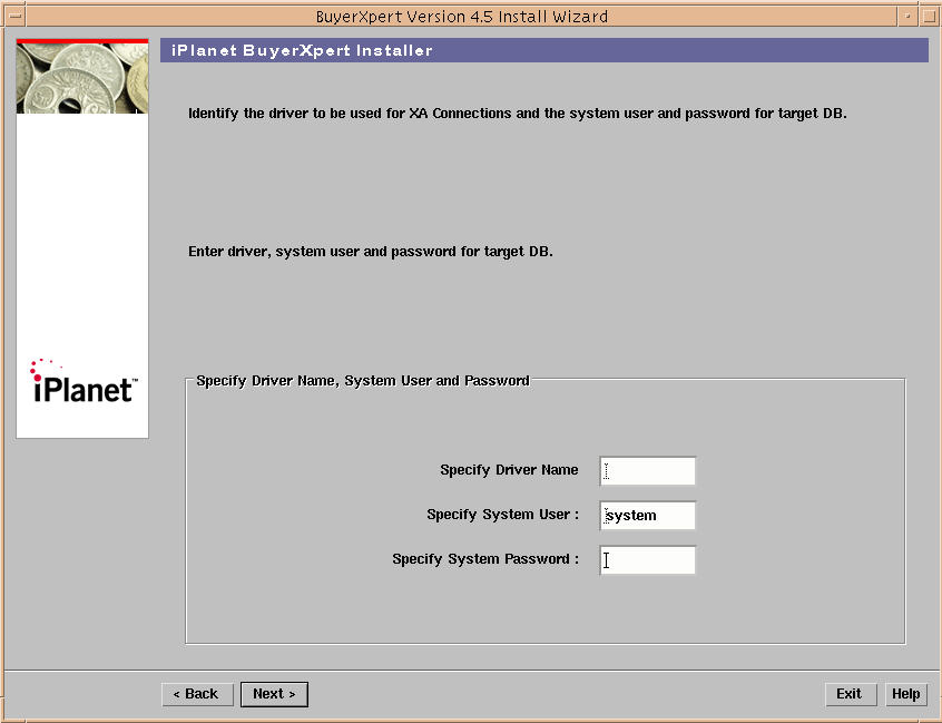

The Specify Driver Name, System User and Password screen displays.
Figure 4-17    Specify Driver Name, System User and Password screen ![]()
Enter the driver name that is to be used with the XA connection.
Enter the Oracle system password.
If you have to run db_setup.sh before this step, enter the name of the driver that you gave when you ran db_setup.sh.
Otherwise, remember the name that you provide here and provide the same name when running db_setup.sh).

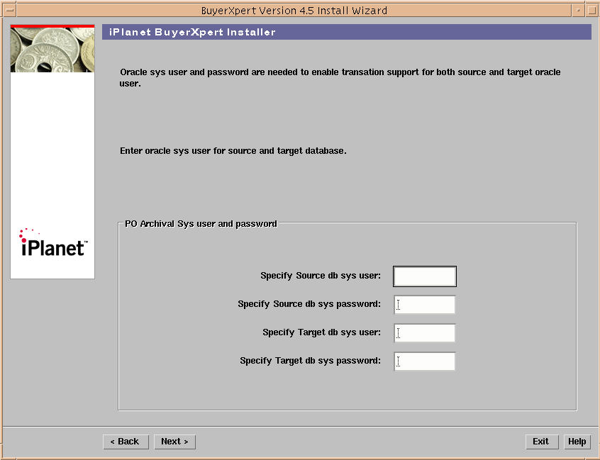

The PO Archival Sys User and Password screen displays.
Figure 4-18    ![]()
Enter the Oracle source db sys user name for transaction support.
Enter the Oracle source db sys password for transaction support.
Enter the target db sys user for transaction support.
Enter the target db sys password for transaction support.

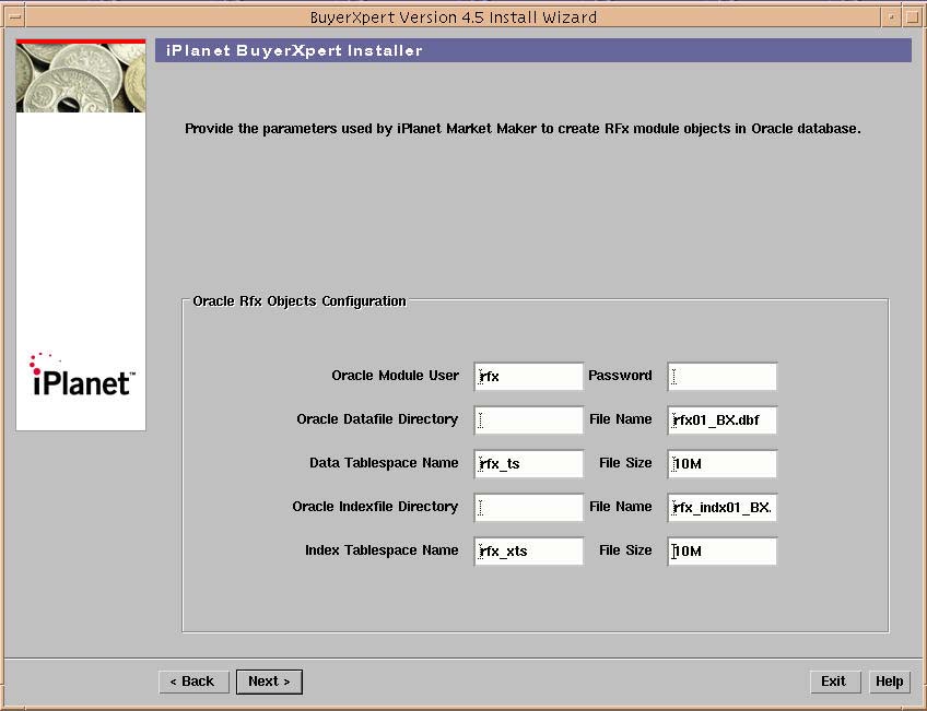

The Oracle PO Archival Objects Configuration screen displays.
Figure 4-19    ![]()
Verify the Oracle target module user.
Enter the location of the Oracle datafile directory.
Verify the datafile file name.
Verify the data tablespace name.
Verify the data tablespace file size.
Enter the location of the Oracle indexfile directory.
Verify the indexfile directory file name.
Verify the index tablespace file name.
Verify the index tablespace file size.

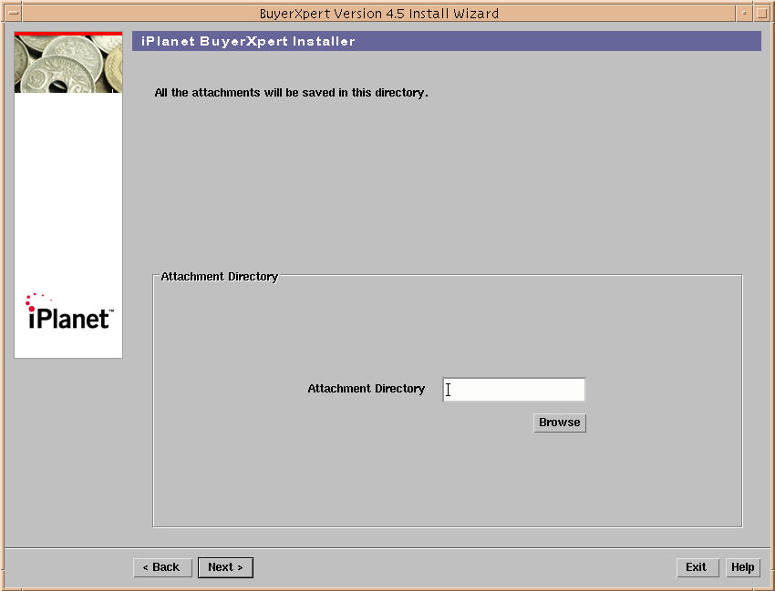

The Attachment Directory screen displays.
Figure 4-21    ![]()
Enter the location of the attachment directory.

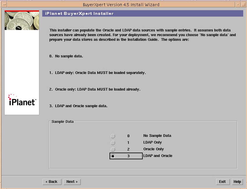

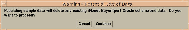

The Sample Data screen displays.
Figure 4-22    Sample Data screen ![]()
Select No if you do not want to populate the Oracle and LDAP data sources with sample entries.
Or, Select one of the following:
LDAP Only (to populate the LDAP sample data only)
Oracle Only (to populate the Oracle sample data only)
LDAP and Oracle (to populate both the LDAP and the Oracle sample data)
If you select either No Sample Data (option #0) or LDAP Only (option #1), proceed to the Actuate Report Server screen.
If you select either Oracle Only (option #2) or LDAP and Oracle (option #3), the following 13 screens display.
If you select either Oracle Only (option #2) or LDAP Only (option #3), a warning message displays.
The message advises that populating sample data will delete any existing iPlanet BuyerXpert Oracle schema and data, and you are prompted to choose whether or not you would like to proceed.
The installer recreates the users and tablespaces that you specified earlier, and that you specify in the next 12 screens.
Click Continue to continue with the installation.
The Oracle Installation Configuration screen displays.
Figure 4-23    ![]()
Enter the network service name.
Enter the location of the Oracle home directory.

The Oracle RFx Objects Configuration screen displays.
Figure 4-32    ![]()
For a Custom installation:
Enter the password for the rfx user.
You can modify the Oracle user, data and index tablespace name and size, and the location of the datafile.
If no datafile location is specified, Oracle uses the default location, ORACLE_HOME/dbs.

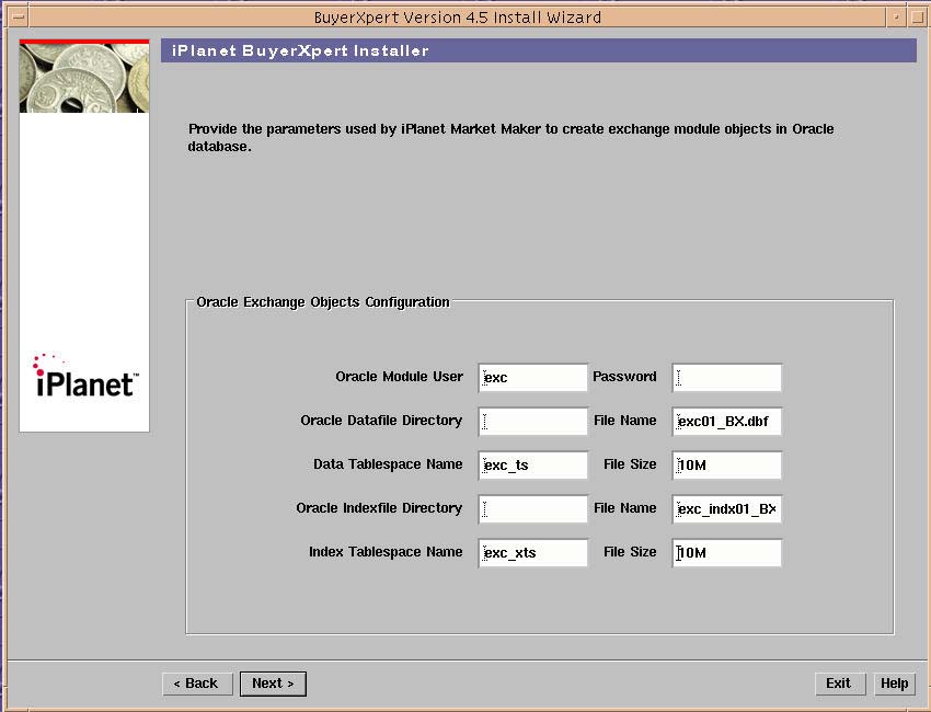

The Oracle Exchange Objects Configuration screen displays
Figure 4-33    Oracle Exchange Objects Configuration screen ![]()
Enter the password for the exc user.

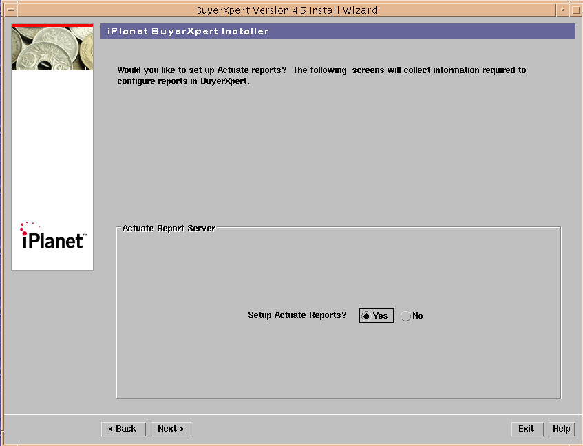

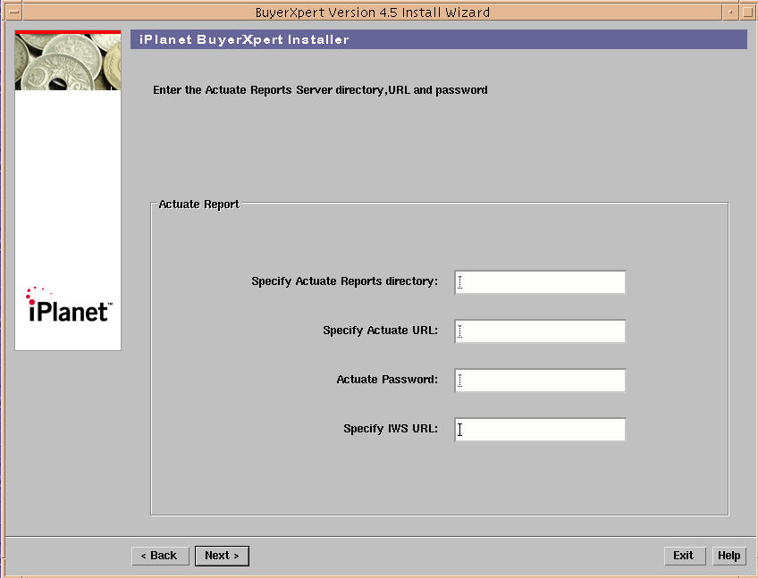

The Actuate Report Server screen displays.
Figure 4-34    Actuate Report Server screen ![]()
If you do not want to setup Actuate reports, proceed to Ready to Install, Click the Next button to continue the installation..
Select Yes if you want to setup Actuate reports.
The Actuate Report screen displays.
Figure 4-35    Actuate Report screen ![]()
Enter the location of the Actuate Reports directory.
Note The Actuate Reports directory, URL, and password were specified during the Actuate Reports installation.
Enter the iWS URL.

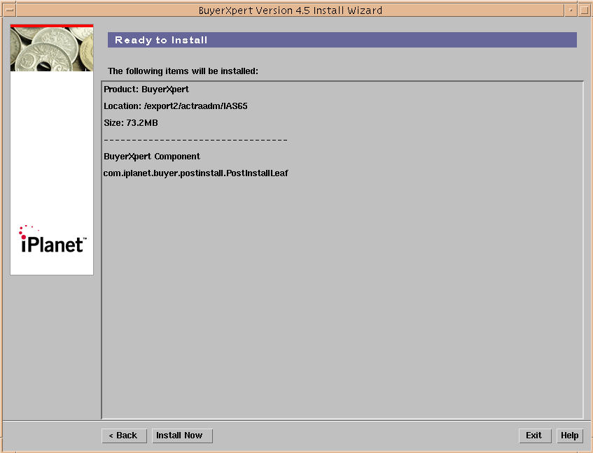

The Ready to Install screen displays.
Figure 4-36    ![]()
Click Install Now.

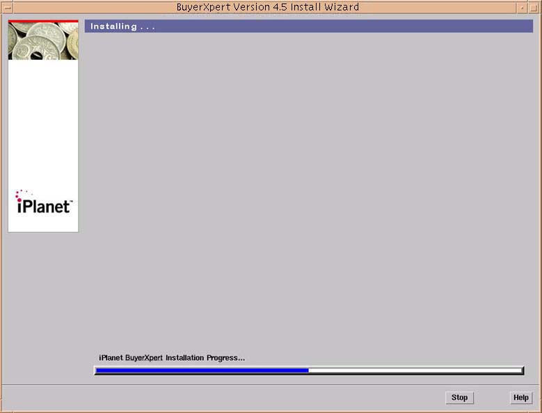

The Installing... screen displays.
Figure 4-37    ![]()
Note The Installation Progress bar displays 100% before installation is complete (this is a known problem).
Click Stop if you want to cancel the installation before it is complete.

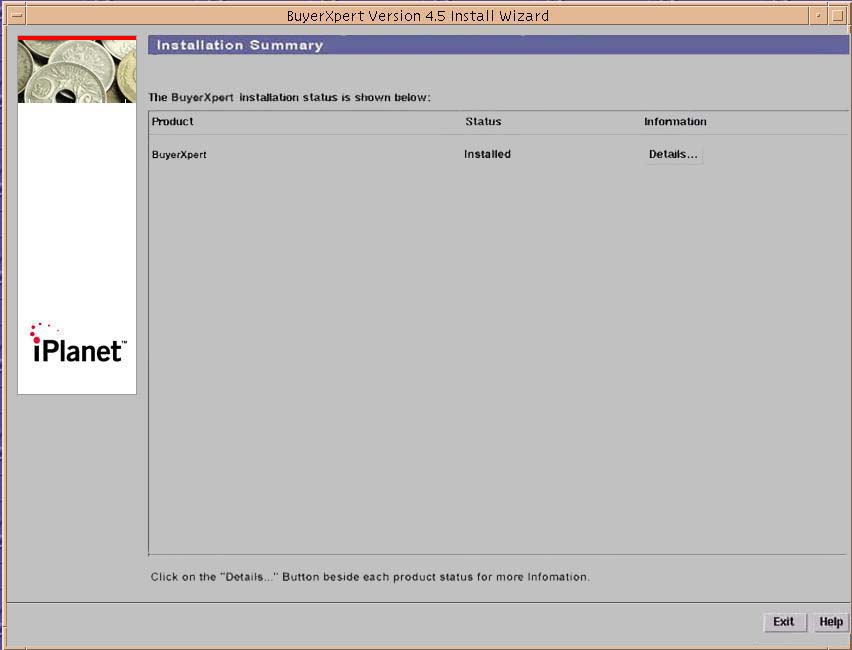

The Installation Summary screen displays.
Figure 4-38    Installation Summary screen ![]()
The installation is complete in approximately 45 minutes.
If the installation is successful, the Status displays Installed.
If the installation is not successful, the Status displays Failed.
The installation log is in /tmp/BX45install-<username>.
Click Exit to exit the installer.

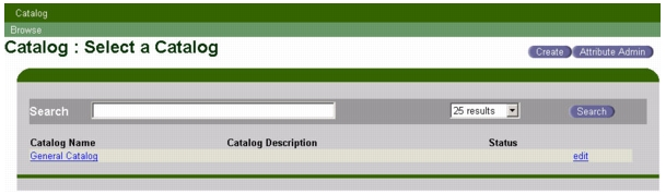

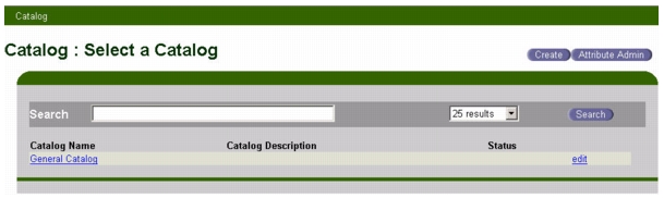

Creating Catalogs in Catalog Manager
To create catalogs in Catalog Manager:

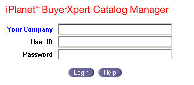

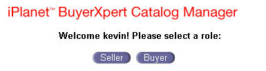

Figure 4-39    Login screen ![]()
Figure 4-40    Buyer/Seller Login screen ![]()

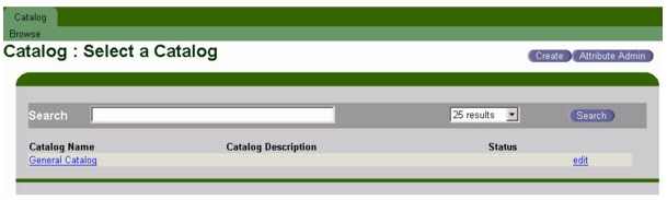

Figure 4-41    Catalog : Select a Catalog screen
Figure 4-42    Browse Option (sub-menu option)
Figure 4-43    Catalog : Select a Catalog screen
Click a Catalog Name.
If necessary, click the Return to Catalogs button.
Click the Create button.
Enter a catalog name.
Enter a brief Catalog Description to provide notes that describe the catalog contents.
Select a user group for accessing this catalog.
Confirm

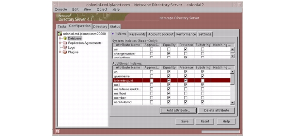

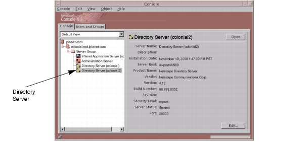

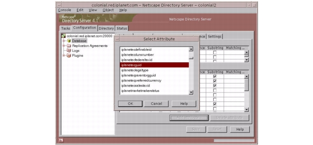

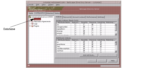

Creating Membership Indexes
For membership performance improvements, you need to create the following indexes in your membership Directory Server if they do not already exist:

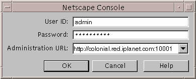

To create indexes, you need to run startconsole from the iAS home directory.
The console screen displays.
Enter the administrator password you gave when you installed Process Manager.
Double click the Directory Server that you created under the Server Group.
Highlight Database, located on the left side.
Select iplanetecguid.
The attribute name iplanetecguid appears under the Addition Indexes column and attribute Equality and Presence is checked.
Add the other attributes by repeating the previous steps.
Click Add Attribute to add all these attributes:
Click Save.

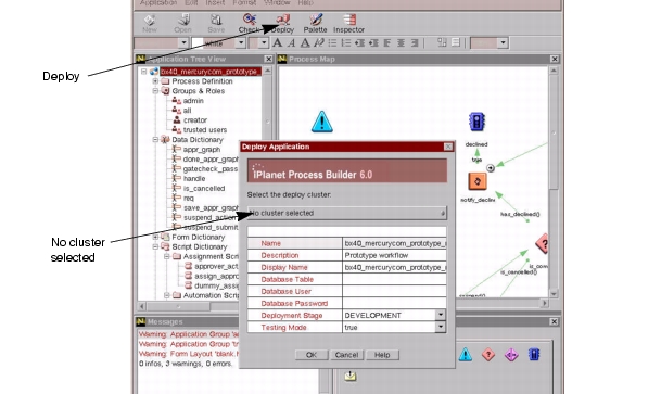

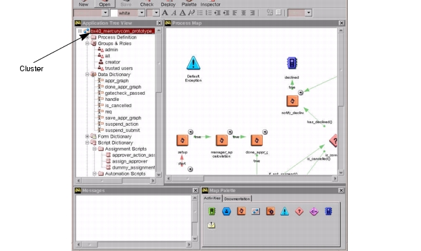

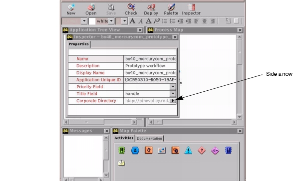

Running the Process Builder

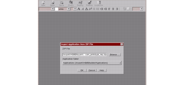

To deploy a sample application:

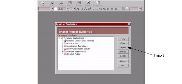

Run the Process Builder:
Click Import.
Enter the zip file location.
Click OK.
The cluster that you just set up displays on the left side of the screen.

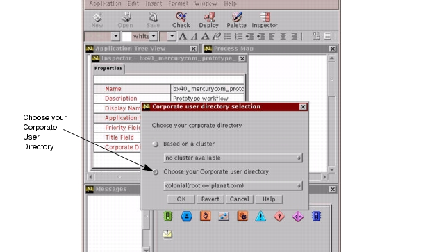

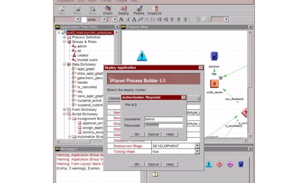

Double click the bx40_buyercompany_prototype file name on the left side of the screen.

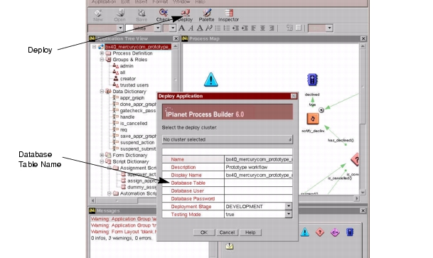

Verify that the corporate directory contains the correct machine name.
Select Choose Your Corporate User Directory.
Click Deploy (in the row of buttons near the top of the screen).
Select the cluster by clicking No Cluster Selected.
Enter your iAS user ID.

Run the Process Builder again:
Click Import.
Click OK.
Double click the bx40_buyercompany_prototype file name, located on the left side of the screen.
Click Deploy (located in the row of buttons near the top of the screen).
Click the Database Table field.
Enter a new name for the timecard deployment.
Click OK.

Import the following files in the order shown:
