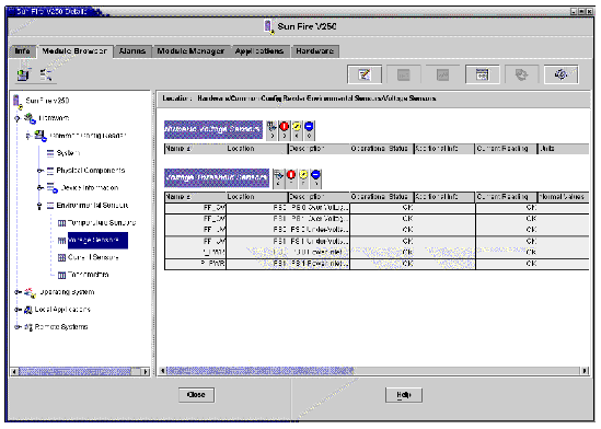

FIGURE 3-1 Physical Components Showing Location and Description Columns (Sun Fire V250 Shown)
The Operational Status property can take the values shown in TABLE 3-2.

Environmental sensors are modelled for fan speed (tachometer), temperature, current and voltage. Two types of sensor are supported:
FIGURE 3-3 Numeric Voltage Sensors and Voltage Threshold Sensors Tables (Sun Fire V250 Shown)
