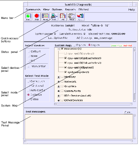

When you start the SunVTS CDE user interface, the SunVTS CDE main window is displayed (FIGURE 4-1). SunVTS is in an idle state with all testing options set to default values.
The procedures in this chapter explain how to use the CDE main window:
Note - See Appendix A for details about each main window item. |

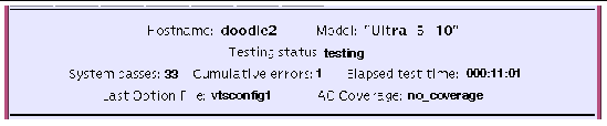

1. Identify the current state of SunVTS in the Status panel (FIGURE 4-2).
The following information is displayed in the Status panel:
System passes--displays the total number of successful system passes (a system pass is when all tests have been run once).
Elapsed test time--indicates the total number of hours, minutes, and seconds that elapsed during testing.
AC Coverage--displays the type of Auto Configuration coverage level that was selected (either confidence, comprehensive, or no_coverage when the AC feature is not in use).
2. Select a test mode from the Test Mode panel (FIGURE 4-3):
Connection test mode--provides a low-stress, quick testing of the availability and connectivity of selected devices. These tests are non-intrusive, meaning they release the devices after a quick test, and they do not place a heavy load on system activity.
Functional test mode--provides more robust testing of your system and devices. It will use your system resources for thorough testing and it assumes that no other applications are running.
Auto Config test mode--opens the Automatic Configuration dialog box which provides access to the Automatic Configuration feature. The Automatic Configuration feature simplifies the test session configuration by assigning a predetermined set of test options. See Using the Automatic Configuration Feature for instructions on using this feature.
Exclusive test mode--enables users to perform tests that must be performed exclusively, and which allow no other tests or applications to be running concurrently.
Online test mode--enables users to perform sunvts testing while other customer applications are running concurrently.
Note - As you change test modes, the tests that are selectable in the System Map change. |

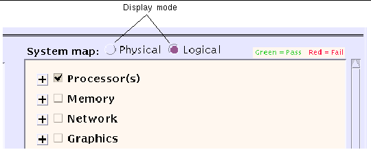

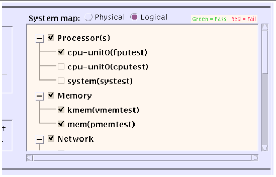

3. Specify the System Map display mode (logical or physical):

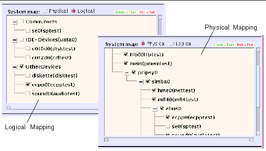

The devices that SunVTS identified as testable devices on your system are listed in the System Map (FIGURE 4-6). You control the way that SunVTS displays these devices by selecting one of the following:
Logical Mapping--organizes the devices, according to their function, into groups. For example, SCSI disk, SCSI tape, and SCSI CD-ROM drives are placed in the SCSI-Devices group. You can focus your testing on a specific device, device group, or on all of the groups on the system.
Physical Mapping--shows the exact location of each device on the system in relation to how the devices are connected to each other. If you are testing a single-board type system, each device is shown under the system board. Multi-board type systems show each device under the board (for example, board0, board1, and so on) to which the device is attached. For example, if you have multiple disk drives connected to different disk interfaces, each disk would be displayed under the respective interface. From Physical Mapping, you can determine the actual location of each device. When possible, the board number and controller type for the device are also displayed.
Select the Physical or Logical button.
4. Expand the System Map to view selectable devices.
About devices in the System Map:
When SunVTS is started, most of the devices in the System Map are collapsed, meaning individual devices are grouped together and hidden from view under a device category. A "+" (plus) indicates that the device group is collapsed. A "-" (minus) indicates that the device group is expanded so you see each device for a given category.
Use the following methods to open the System Map:

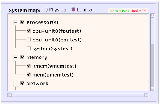

5. Select the devices that you want to test.
A checkmark next to a device in the System Map indicates that device is selected. Depending on the devices on your system, and the test mode that you select, SunVTS selects certain devices by default.
a. Select your devices using the buttons in the Device Selection panel:
b. Refine the selected devices by clicking on the checkmark box next to a device or device group.

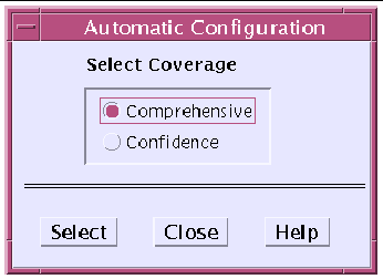

2. Select Auto Config from the Select Test Mode panel.
The Automatic Configuration dialog box is displayed (FIGURE 4-10).
3. Select one of the following choices from the Automatic Configuration dialog box:
Comprehensive--sets all the test options for thorough testing. All applicable functional tests are enabled. The test session validates the full functionality of the system and provides you with assurance that the system is hardware fault free.
Confidence--sets all the test options such that there is limited functional test coverage as compared to the Comprehensive level of coverage. The Confidence level testing verifies the main functionality of the system in a shorter amount of time.
Note - The Help button displays a dialog box with Auto Configuration information and instructions. |
4. Click on Select in the dialog box.
SunVTS applies the predefined options and is ready to test selected devices.

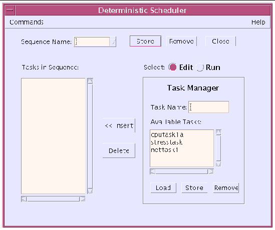

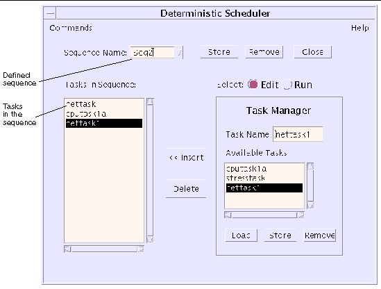

SunVTS provides a Deterministic Scheduler that you can use to define what tests run and in what order. If you do not use this feature, selected tests run in an order that is dynamically determined by SunVTS kernel.
The Deterministic Scheduler is available as a dialog box from the SunVTS CDE interface menu-bar area.
The following list provides an overview of the steps you perform to start, run, and quit the Deterministic Scheduler feature. Detailed instructions follow.
Start SunVTS with the SunVTS CDE user interface.
Start the Deterministic Scheduler.
Create one or more tasks. A task is a SunVTS test session configuration (one or more selected SunVTS tests, test options, and specified test mode).
Create the sequence. A sequence is a group of tasks specified to run in a certain order.
Start the sequence.
When the sequence is done, reset the Deterministic Scheduler if desired.
Quit the Deterministic Scheduler feature.
1. Start SunVTS with the SunVTS CDE user interface as described in Starting SunVTS.
2. Start the Deterministic Scheduler by selecting DSched
start DS from the SunVTS menu bar.
The Deterministic Scheduler Dialog box is displayed (FIGURE 4-11).
Note - The Help button displays a dialog box with Deterministic Scheduler information and instructions. |
3. Define your task(s) as described below:

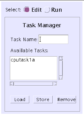

a. In the Deterministic Scheduler dialog box, click on the Edit button.
The Deterministic Scheduler displays the Task Manager panel and shows a list of existing tasks (if any have been created) in the Available Tasks list. You can use existing tasks or create new tasks. If this is the first time that the Deterministic Scheduler is used, you must create your own.
b. In the SunVTS main window, configure a test session (select one or more devices and your desired test mode).
If you assign more than one test to a task, the order of the tests within this task will be determined by SunVTS. If you want to control the order of every test, assign only one test for each task.
When the Deterministic Scheduler is started, it changes the default values of Max System Passes from 0 (run indefinitely) to 1 (run one pass). This is necessary so that each task only runs selected tests once and proceeds to run subsequent tasks in the sequence.
c. In the Deterministic Scheduler dialog box, enter a task name.
d. Click on Store in the Task Manager panel.
Your task appears in the Available Task list.
e. Repeat Step a through Step d to create additional tasks.
f. To see the tests configured for a particular task, select the task from the Available task list and press Load.
The SunVTS main window shows the SunVTS test configuration that is associated with the selected task.
g. If you want to modify a task: select it; load it; change the test configuration in the SunVTS main window; and press Store in the Task Manager panel.
h. If you want to delete a task, select it and press Remove in the Task Manager panel.
4. Define the sequence as follows:
a. Select a task from the task list.
The task is added to the sequence list.
c. Repeat the previous steps until all desired tasks are added to the sequence list in the order that you want them to run.
You can add the same task more than once.
When you begin testing, the tasks run from the top of the list down.
d. If you want to remove a task from the sequence list, select it and press Delete.
e. To save the sequence for future use, enter a name in the Sequence name field and press Store in the Task Manager panel.
The sequence will be saved for easy retrieval for future testing.

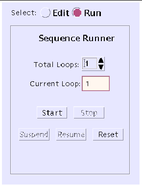

f. With the Sequence selected, press the Run button.
The right-hand panel displays the Sequence Runner panel (FIGURE 4-14), providing access for you to define the number of times (loops) for the sequence to run and to start running the sequence.
a. Increment or decrement the Total Loop value to the desired number of times you want the sequence to run.
6. Press the Start button to start the sequence.
While testing is underway you can:
monitor the test progress in the main SunVTS window. All test results are logged in the SunVTS log files.
close the Deterministic Scheduler dialog box by pressing the close button or by selecting Commands
Quit Options
Quit UI only from the Deterministic Scheduler dialog box. Testing will continue, and results will be displayed in the SunVTS main window. You can reopen the Deterministic Scheduler dialog box from the SunVTS main window.
suspend and resume the sequence by pressing the suspend and resume buttons in the Deterministic Scheduler dialog box.
7. Use the Reset button to reset the SunVTS main window and the Deterministic Scheduler.
The SunVTS main window test statistics and the Deterministic Scheduler current loop count are reset.
8. Quit the Deterministic Scheduler when you are done by selecting Commands
Quit Options
Quit DS and UI.
The Deterministic Scheduler and the Deterministic Scheduler dialog box are dismissed.
