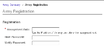

3. From the Sun Web Console page, click Sun StorEdge 6130 Configuration Service.
See Discovering and Registering Arrays for instructions.

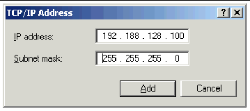

4. In Advanced TCP/IP Settings, select the IP address you want to configure, and click Add directly below the IP addresses listing.
5. Type the IP address and subnet mask as shown in the following example:
The new IP address is added to the IP addresses listing.
7. Open a command window and try to ping the array, as shown in the following example:

4. In Advanced TCP/IP Settings, click Add directly below the IP addresses listing.
5. Type an IP address that is on the same subnet as Controller A (192.168.128.101) and Controller B (192.168.128.102).
For example, you can use 192.168.128.100 because it is on the same subnet and does not conflict with the controller IP addresses.
7. Log in to the Sun Web Console as root to register the array.
8. Click Sun StorEdge 6130 Configuration Service.
10. If the array is not discovered, register the array manually:
b. Enter the IP address for Controller A and click OK.
