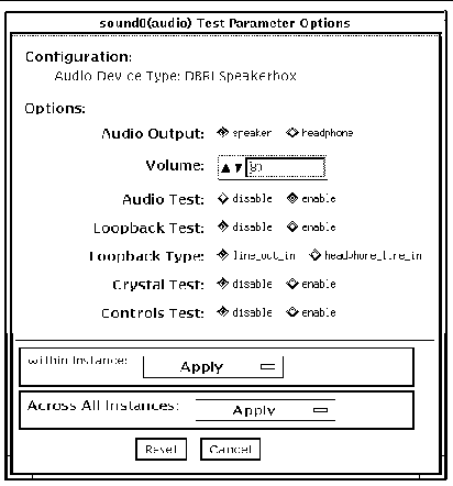

To reach the following dialog box, right-click on the test name in the System Map and select Test Parameter Options. If you do not see this test in the System Map, you might need to expand the collapsed groups, or your system might not include the device appropriate to this test. Refer to the SunVTS User's Guidefor more details.
FIGURE 3-1 audiotest Test Parameter Options Dialog Box
Note - Upon startup, the SunVTS probe utility determines which audio implementation is present and adjusts the audiotest Option menu appropriately. Your dialog box might look different than the one pictured here, but will contain some or all of these options.
Note - The internal loopbacks are only active if the audio jacks are unused (nothing is connected).
Some options can only be selected through the command line. See the command-line option descriptions in audiotest Command-Line Syntax.
TABLE 3-2 audiotest Options
Option
Description
Audio Output
Selects the output port for the Music Play test.
Volume
Sets the volume for the Music Play test.
Audio test
Enables or disables the Music Play test. This test is enabled by default.
Loopback test
Enables or disables the Loopback test. A loopback cable must be installed between the selected ports to run external loopback tests. This test is disabled by default.
Loopback type
Selects the type of Loopback test to run.
Crystal test
Enables or disables the Crystal test. This test is disabled by default.
Controls test
Enables or disables the speakerbox Controls test. This is an interactive test. The user is prompted to press the control buttons on the speakerbox. This test is disabled by default.
