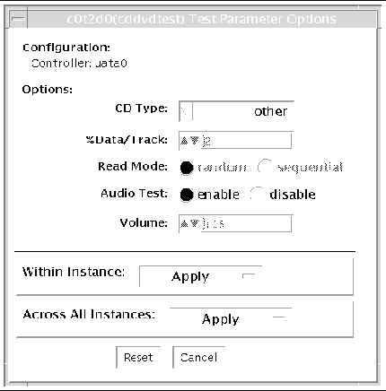

CD-ROM Test Options
This section describes the cddvdtest options for CD-ROMs.
FIGURE 5-1 cddvdtest Test Parameter Options Dialog Box for CD-ROM
TABLE 5-2 cddvdtest Options for CD-ROM
Option
Description
CD Type
The CD Type menu lists the types of compact discs that can be tested. The choices are: Pdo, Multi-session, or Other the default CD type is other). In Connection test mode, this option has a default value of other.
Note - Your choice must correspond with the disc ussed for testing.
% Data/Track
Tests a percentage of data on each track. Type a value between 0 and 100 in this field to indicate the percentage. In the online and connection tests this option has a default value of 2%.
Read Mode
cddvdtest reads the CD either in Random or Sequential mode. In Random mode, data blocks are read from random track positions; in Sequential mode, data blocks are read in sequence. For both modes, the total number of blocks read is determined by the %_of_data option. In the online and Connection tests this option has a default value of random.
Audio Test
Enables or disables the audio test. You must connect headphones or a speaker to the audio jack on the CD player to hear audio output. In the Connection test, this option has a default value of disable.
Volume
Adjusts the volume. Type a value between 0 and 255 in this field. In the online and connection tests this option has a default value of 125.

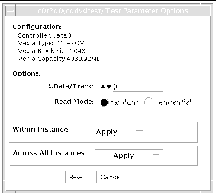

DVD-ROM Test Options
This section describes the cddvdtest options for DVD-ROMs.
FIGURE 5-2 cddvdtest Test Parameter Dialog Box for DVD-ROM
TABLE 5-3 cddvdrwtest options for DVD-ROM
Option
Description
% Data/Track
Specifies a percentage of data to test for each track.
Use a number between 0 and 100.
Read Mode
Specifies either Random or Sequential mode. Random mode reads data blocks from random track positions. Sequential mode reads data blocks in sequence. For both modes, the total number of blocks read is determined by the % Data/Track value.

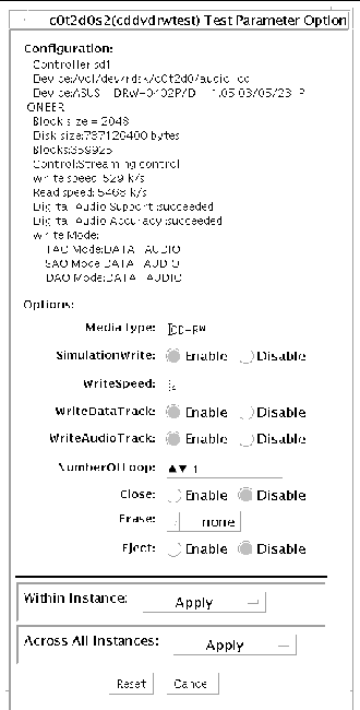

CD-RW Test Options
This section describes the test options for CD-RWs.
FIGURE 5-3 cddvdtest Test Parameter Options Dialog Box for CD-RW
TABLE 5-4 cddvdtest Options for CD-RW
Option
Description
SimulationWrite
Disables or enables simulation write.
WriteSpeed
Speed entered in terms of nX. Speed is set to closest approximation of nX allowed by the device.
WriteDataTrack
Writes a data track in one test loop.
WriteAudioTrack
Writes an audio track in one test loop.
NumberOfLoop
Number of loops in one test pass comprising data and audio track if enabled.
Close
Closes after writing. Cannot write more tracks on the media.
Erase None
Does not erase. The All option erases the whole disk.
Eject
Ejects the disk when the test is completed. Do not enable this option in a multiple pass test session.

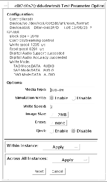

DVD-RW Test Options
This section describes the cddvdtestoptions for DVD-RWs.
FIGURE 5-4 cddvdtest Test Parameter Options Dialog Box for DVD-RW
TABLE 5-5 cddvdtest Options for DVD-RW
Options
Description
SimulationWrite
WriteSpeed
ImageSize
Specifies track size, how much data is written: 2 MB, 10 MB, 2 GB, 4 GB.
Erase None
Do not erase the media.
Fast
Erases with Fast option. Only the Table of Contents is erased.
All
Erases with All option. Erases whole disk surface.
Eject

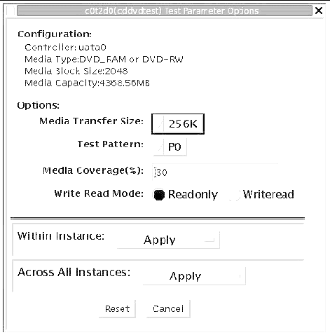

DVD-RAM Test Options
This section describes the cddvdtestoptions for DVD-RAM.
FIGURE 5-5 cddvdtest Test Parameter Options Dialog Box for DVD-RAM
TABLE 5-6 cddvdtest Options for DVD-RAM
Options
Description
Media Transfer Size
Specifies the media test size in Kbytes.
Test Pattern
Specifies the test pattern: P0, P1, or P2 (Default P0).
The following options are supported:
- P0 = 0000000000000000
- P1 = ff00ff00ff00ff00
- p2 = ffffffffffffffff
Media Coverage
Specifies the percentage of media coverage.
Write Read Mode
Specifies either Readonly or Writeread.

speed=n
Specifies the speed. Enter the speed in terms of nX.
imagesize={2MB,10MB,2GB,4GB}
Specifies the image size used in the write/read test.
erase={none, fast, all}
. none - Does not erase media after test complete.
fast - Erases the last track added.
all - Erases entire disk.
eject
Ejects the media.
DVD-RAM Command-Line Syntax
/opt/SUNWvts/bin/cddvdtest standard_arguments -o dev=cntndnsn, rawiosize={32K,64K,128K,256K,512K},rawpattern={P0,P1,P2},rawcover={1% - 100%},rawrw={Readonly,Writeread}
TABLE 5-15 DVD-RAM Command-Line Syntax
Argument
Description
dev=cntndnsn
Specifies the device under test.
rawiosize = 32K,64K,128K,256K,512K
Specifies the iosize for write and read operation. Default is 256K.
rawpattern = P0,P1,P2
The following options are supported. Default is P0.
rawcover = 1-100
Specifies the media coverage in percent. Default is 30.
rawrw = Readonly, Writeread
Selects the Read and Write operations. Default is Readonly.
