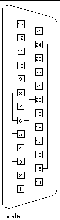

25-Pin RS-232 Loopback Plug
FIGURE A-1 shows the RS-232 and RS-423 single-port loopback plug, which is a specially wired male DB-25 connector. The plug is connected to a serial port in the back of the system under test. The following table lists the pin connections for connecting the first plug to the second plug:
TABLE A-2 25-pin RS-232 Loopback Plug Wiring Plug Connections
First Plug
Second Plug
Pin 3
Pin 2
Pins 6 and 8
Pin 20
Pins 15 and 17
Pin 24

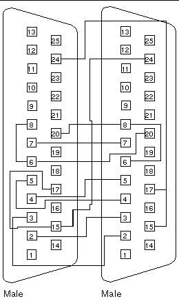

25-Pin RS-232 Port-to-Port Loopback Cable
FIGURE A-2 shows how to connect 25-pin RS-232 and RS-423 port to 25-pin RS 232 and RS 423 port loopback cables (two DB-25 connections). The cable is connected to a pair of serial ports in the back of the system under test. Both plugs are male. The following table lists the pin connections for connecting the first plug to the second plug:
TABLE A-3 25-pin RS-232 Port-to-Port Loopback Cable Wiring Plug Connections
First Plug
Second Plug
Pin 2
Pin 3
Pin 3
Pin 2
Pin 4
Pin 5
Pin 5
Pin 4
Pins 6 and 8
Pin 20
Pin 7
Pin 7
Pins 15 and 17
Pin 24
Pin 20
Pins 6 and 8
Pin 24
Pins 15 and 17
FIGURE A-2 25-pin RS-232 Port-to-Port Loopback Cable Wiring Diagram

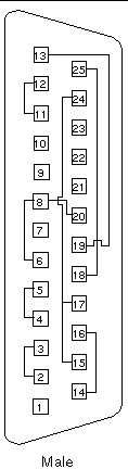

25-Pin Port A-to-Port B Loopback Plug
FIGURE A-5 shows how to connect a 25-pin Port A to Port B loopback plug for most systems. The following table lists the pin connections for connecting the first plug to the second plug:
TABLE A-6 Port A-to-Port B Loopback Plug Wiring Plug Connections
First Plug
Second Plug
Pin 16
Pin 2
Pin 3
Pin 14
Pin 13
Pin 4
Pin 5
Pin 19
Pins 6 and 8
Pin 11
Pin 12
Pin 20
Pin 18
Pin 24
Pins 15 and 17
Pin 25
FIGURE A-5 Port A-to-Port B Loopback Plug Wiring Diagram

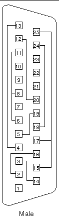

25-Pin Port A-to-A Port B-to-B
Loopback Plug
If your system has a single communications port to connect it to peripherals, follow the connection instructions in FIGURE A-6 to make a male 25-pin loopback plug for that communication port. The following table lists the pin connections for connecting the first plug to the second plug:
TABLE A-7 Port A-to-A, Port B-to-B Loopback Plug Wiring Plug Connections
First Plug
Second Plug
Pin 3
Pin 2
Pin 5
Pin 4
Pins 6 and 8
Pin 20
Pin 12
Pin 11
Pin 13
Pin 19
Pin 16
Pin 14
Pins 15 and 17
Pin 24
Pin 25
Pin 18
FIGURE A-6 Port A-to-A, Port B-to-B Loopback Plug Wiring Diagram

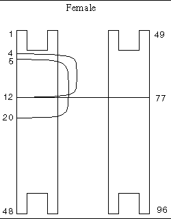

96-Pin Female Loopback Connector
FIGURE A-7 shows a 96-pin connector that can be ordered from Sun (part number 370-1366). The following table lists the pin connections for connecting the first plug to the second plug:
TABLE A-8 96-Pin Female Loopback Connector Wiring Plug Connections
First Plug
Second Plug
Pins 4 and 12
Pin 77
Pin 5
Pin 20
Pins 6
Pin 36
Pin 10
Pin 11
Pin 13
Pin 16
Pin 14
Pin 15
Pin 18
Pin 19
Pin 21
Pin 24
Pin 28
Pin 60
Pin 29
Pin 68
Pin 30
Pin 34
Pin 37
Pin 40
Pin 38
Pin 39
Pin 42
Pin 43
Pin 45
Pin 48
Pin 46
Pin 47
Pin 52
Pin 78
Pin 53
Pin 55
Pin 54
Pin 75
Pin 58
Pin 59
Pin 61
Pin 64
Pin 62
Pin 63
Pin 66
Pin 67
Pin 69
Pin 72
Pin 76
Pin 79
Pin 82
Pin 83
Pin 85
Pin 88
Pin 86
Pin 87
Pin 90
Pin 91
Pin 93
Pin 96
Pin 94
Pin 95
The following are the materials used for this plug:
- PCR-E96FA (1)
- PCS-E96LKPA (1)
- 3751 Metal Plug (1) (9563K42)
- AWG28 Madison Cable (8" long) UL/CSA Approved
FIGURE A-7 96-Pin Female Loopback Connector Wiring Diagram

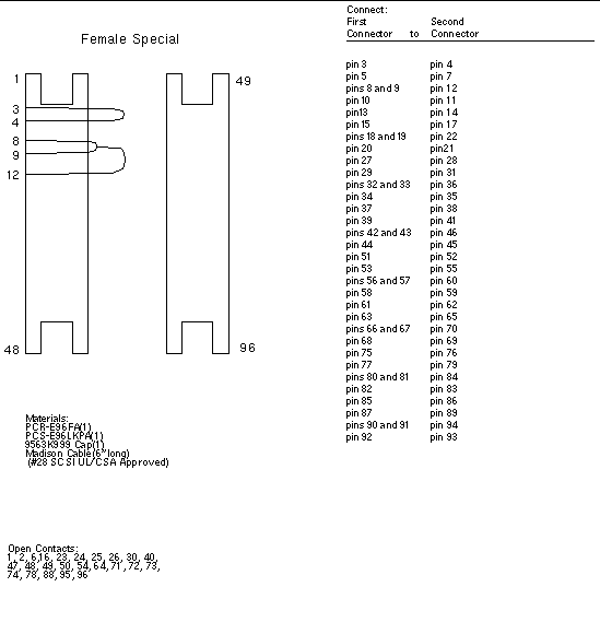

96-Pin Female Special Loopback Connector
This 96-pin connector can be ordered from Sun (part number 370-1381).
FIGURE A-8 96-Pin Female Special Loopback Connector Wiring Diagram

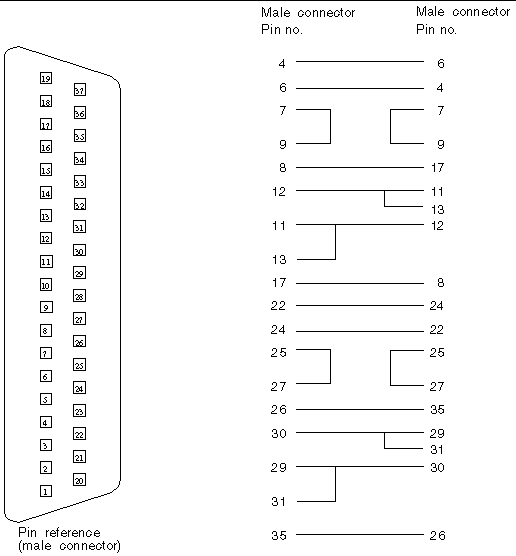

37-Pin RS-449 Loopback Cable
Use these wiring instructions for a loopback cable for two 37-pin RS-449 synchronous ports.
FIGURE A-9 37-Pin RS-449 Loopback Cable Wiring Diagram

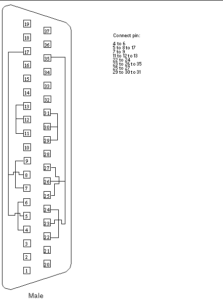

37-Pin RS-449 Loopback Plug
Use these wiring instructions to make a male 37-pin RS-449 loopback plug. This plug is also available from Sun (part number 530-1430).
FIGURE A-10 37-Pin RS-449 Loopback Plug Wiring Diagram

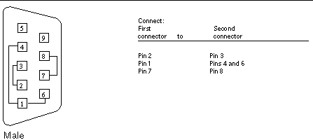

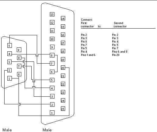

9-Pin to 25-Pin Port-to-Port Loopback Cable
Use these wiring instructions for a 9-pin RS-232 and RS-423 port to 25-pin RS-232 and RS 423 port loopback cables. Both connectors are male.
FIGURE A-13 9-Pin to 25-Pin Port-to-Port Loopback Cable Wiring Diagram

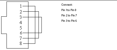

NT to TE Loopback Cable
Using two standard RJ-45 connectors, and connect pin 1 to pin 1, pin 2 to pin 2, and so on, for all pins. This loopback is a straight-through connection.
Twisted-Pair Ethernet (TPE) Loopback Cable for Fast Ethernet
Use the following wiring instructions for standard RJ-45 connectors for Fast Ethernet. Use loopback cable in netlbtest for eri devices.
FIGURE A-15 Twisted-Pair Ethernet (TPE) Loopback Cable Wiring Diagram for Fast Ethernet

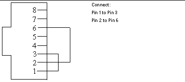

TPE Loopback Cable for Gigabit and 10/100 Ethernet
Use the following wiring instructions for RJ-45 plugs for Gigabit and 10/100 Ethernet. This loopback cable is used in netlbtest for Gigabit and 10/100 devices.
FIGURE A-16 TPE Loopback Cable Wiring Diagram for Gigabit and 10/100 Ethernet

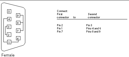

9-Pin Female DB-9 External Loopback Connector
Use these wiring instructions for female 9-pin DB-9 external loopback connectors. Use this loopback connector with the netlbtest on x86 platforms.
FIGURE A-21 9-Pin Female DB-9 External Loopback Connector Wiring Diagram
