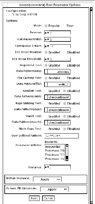

To reach the following dialog box, right-click on the test name in the System Map and select Test Parameter Options. If you do not see this test in the System Map, you might need to expand the collapsed groups, or your system might not include the device appropriate to this test. Refer to the SunVTS User's Guide for more details.
FIGURE 22-1 vmemtest Test Parameter Options Dialog Box
TABLE 22-1 vmemtest Options
vmemtest Options
Description
Mode
Two modes are available:
- Regular mode tests the specified amount of memory as one block and passes as the size argument to the different test algorithm functions (subtests).
- Page mode tests assign virtual memory one page at a time. Each page is mapped to the temporary file /tmp/vmem.page and is then paged out to storage once test data is written. Next, the temporary page is paged back into memory for a read and compare.
vmemtest runs in Regular mode as default setting.
Reserve
Specifies the amount of memory to reserve from being tested by vmemtest. The test ensures that this amount of memory is left free on the system while evaluating the size of memory for testing. If specified value of reserve is zero, this test will use a default value evaluated based on the available free swap space for the instance. Trying to reserve more memory than available free memory by this instance will cause the test to fail.
Test Amount
An amount can be specified to test the virtual memory, instead of the default.The default value is 0, which means the default memory size is evaluated within the test.
Record the memory configuration details on the target system before selecting nondefault setting for the amount option.
If negative values are specified, the test assumes the default setting. The actual size of memory tested by the instance is always evaluated with reference to the available free swap space on the system.
vmemtest Configuration
The amount of memory listed in the Configuration field is equivalent to the sum of the used and available swap space amounts returned by the swap -s command. This number ndicates the amount of virtual memory found, rounded up to the nearest Kbyte.
Contiguous Errors
Specifies the max number of contiguous memory errors, which will be considered and counted as one noncontiguous error. The default value is 10.
Test Method
vmemtest runs the Sequential and File Caching subtests by default.
- Sequential subtest - Tests the whole memory from the beginning address to the end address in a sequence.
- Address Random subtest - Randomly selects memory addresses with in the specified range to test.
- Page Striding subtest - Noncontiguous memory test, implemented sequentially and non-sequentially.
- Sequential striding - Tests from the first page to the last page, withn a specified test range. Only one word is tested per page.
- Nonsequential striding - Tests randomly from first to last page, within a specified memory range. Alternates testing one word per page until all pages are tested.
- Block Copy test - Writes and reads data between two memory blocks. Each memory block is half the memory to be tested.
- File Caching test - Aimed at improving performance through the use of file caching in the Solaris kernel. This test is useful for large memory configurations. This test takes 30 to 70% less time than the Sequential test method.
Predefined Pattern
Select one of the following patterns to use for the test:
- Address-uses the virtual addresses of the tested memory locations.
- walk_1-uses a pattern that starts with 0x80000000 through 0x11111111.
- walk_0-uses a pattern that starts with 0x7fffffff through 0x00000000.
- 0x00000000-uses all ones and zeros for testing.
- 0x5aa55aa5-uses 0x5aa55aa5 pattern.
- 0xdb6db6db-uses 0xdb6db6db pattern.
- Checkerboard-uses 0xaaaaaaaa patterns.
- UserDefined-uses the pattern that is specified in the User Defined Pattern area (see below).
Only used if the Predefined Pattern is set to UserDefined. The pattern specified should be in the form of an 8-digit, hexadecimal number such as 0x2a341234. Default setting is up=0x7ff77ff7
Instance
Specifies how many copies of the vmemtest test to run.
