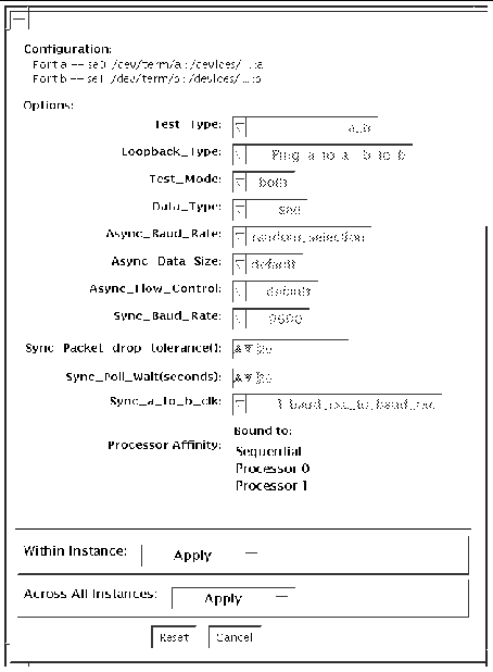

To reach the following dialog box, right-click on the test name in the System Map and select Test Parameter Options. If you do not see this test in the System Map, you might need to expand the collapsed groups, or your system might not include the device appropriate to this test. Refer to the SunVTS User's Guide for more details.
FIGURE 18-1 serialtest Test Parameter Options Dialog Box
TABLE 18-1 serialtest Options
Option
Description
Test Type
Selects how the test will run. Test options include:
- a - Runs the test on port A.
- b - Runs the test on port B.
- a_b - Runs the test on ports A and B sequentially.
- a_b_concurrent - Runs the test on port A and port B concurrently.
Loopback Type
Selects the loopback test. Options include:
- Plug_a_to_a__b_to_b - An external loopback plug for a, b, a_b, and a_b_concurrent test types.
- no_modem_a_to_b - An external loopback cable for a_to_b and a_to_b_concurrent test types.
Data Type
Selects the data pattern to transfer. You can select:
- Random
- Sequential
- Alphanumeric
- 0x00-0xff
Async Baud Rate
Selects the baud rate for Asynchronous mode testing. The valid rates are 110, 300, 600, 1200, 4800, 9600, 19200, 38400, 57600, 76800, 115200, 153600, 230400, 307200, 460800, and ALL. The default rate is 9600 baud. Some platforms can only support up to 38400 or 76800. If the device is connected to the super I/O port then the max baud rate supported is 115200. The test will return an error if you try to use a higher baud rate than is supported. For baud rates greater than 153600, the serial line drivers must be set for RS-423 mode and not RS-232 mode. The RS-423 and RS-232 modes are usually selected by a hardware jumper on the motherboard.
Consult your hardware installation manual for more information.
Async Data Size
Selects the total number of bytes to transfer in Asynchronous mode. This can range from 1 to 10000.
Async Flow Control
Selects the type of flow control to use in Asynchronous mode testing. You can select Hardware (RTS/CTS), Software (XON/XOFF) or None. The default depends on the loopback type. Software flow control is not allowed on a, b, a_b, or a_b_concurrent loopback types.
The following options are not available for the devices connected to the super I/O port. They are available for all other supported I/O ports.
Test Mode
Selects the mode to run the test in. The modes available are Asynchronous, Synchronous, or Both. When Both is selected, the test runs first in Asynchronous mode then Synchronous mode.
Sync Baud Rate
Selects the device generated clock rate for Synchronous mode testing. The valid rates are from 110 to 230400. The rate does not have to be a specific value as required for async mode baud rates. The default rate is 9600. Some platforms can only support up to 38400 or 76800. The test will return an error if you try to use a higher rate than is supported. For rates greater than 100000, the serial line drivers must be set for RS-423 mode and not RS-232 mode. The RS-423 and RS-232 modes are usually selected by a hardware jumper on the motherboard.
Sync Packet
Selects the tolerance level of Synchronous mode dropped packets during the many_packets subtest. The default is Drop 20 percent. The valid range is from 0 percent to 99 percent. Some packet drops are expected especially at higher Toleranceclock rates and on a heavily loaded system.
Sync Poll Wait
Selects the number of seconds in additional time to wait for a Synchronous mode packet to be sent. Additional time may be needed when there is heavy system activity and time-outs are being detected. In general, the user can decrease the value to 0 when the system load is light or increase the value when there is a heavy system load.
The following option is available only for devices connected to the super I/O port. They do not apply to any other supported I/O ports.
User Defined Baud Rate
Allows the user to set new baud rate values for the test. First select the User Defined option from the Async menu. Then enter the new value in the User Defined Baud Rate field.
