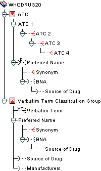

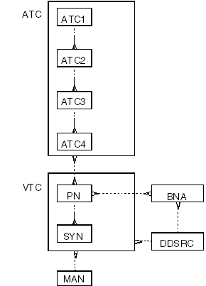

You can define the following types of dictionaries:
A strong dictionary definition in TMS consists of a fixed number of hierarchical levels with defined relations between the levels. You store every dictionary term in a particular level and define relations from each term to terms in other levels, according to the relations you have defined for the levels themselves. This type of TMS dictionary definition is appropriate for external dictionaries such as MedDRA and WHO-Drug.
Strong dictionaries can serve as the base for creating virtual dictionaries and filter dictionaries; see "Virtual Dictionaries" and "Filter Dictionaries".
For more information, see "Planning Strong Dictionary Structure".
Some external dictionaries, such as SNOMED, require a different type of structure, one that is dynamically created by relations between terms. TMS supports these with weak dictionaries and named relations between terms.
Where strong dictionaries have fixed hierarchies, represented by levels, weak dictionary have dynamic hierarchies, which are variable. For example, a strong dictionary with four levels from the coding level to the highest derivation level will only have four terms in a hierarchical chain:

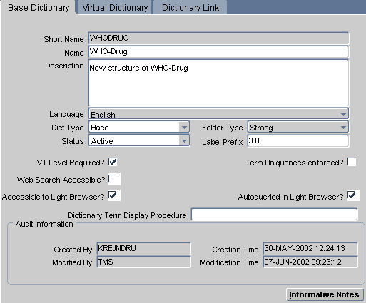

To set up a virtual dictionary in TMS, choose a base dictionary (and activate it, if the base dictionary is still provisional), define the virtual dictionary's name and cut-off date, and assign the virtual dictionary to a domain.
Define and activate the base dictionary on which you want to base the virtual dictionary; see "Defining a Dictionary" and set it to active; see "Setting the Dictionary's Status to Active".
Load data into the base dictionary and activate the data; see "Loading a Dictionary".
With the base dictionary displayed in the Base Dictionary tab of the Define Dictionaries window, click the Virtual Dictionaries tab.
From the Record menu, choose Insert Record. The system displays values for most fields that are inherited from the base dictionary. You can modify the Short Name, Name, and Description to make them more meaningful.
Define a Cut-off Date. All terms current at the point in time you specify will constitute the virtual dictionary. You cannot change the cut-off date after saving. Click in the Cut-off Date field. If other virtual dictionaries have been created for the same base dictionary, their cut-off dates are available in the LOV. If not, you can enter the date using the format:
DD-MON-YYYY HH:MM:SS
for example, 01-NOV-2006 10:01:15
You can enter the date portion only and the system will enter a time of midnight.
If a Release Label has already been associated with the timestamp you selected, the system displays it in the Release Label field. You can modify it if necessary. Save.
When you are satisfied with your virtual dictionary definition, set its Status to Active and Save.

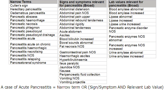

Standardized MedDRA Queries (SMQs) are designed to aid in the identification and retrieval of case safety reports in clinical studies. The MedDRA Maintenance and Support Services Organization (MSSO) defines SMQs as follows:
SMQs are groupings of terms from one or more MedDRA System Organ Classes (SOCs) that relate to a defined medical condition or area of interest. They are intended to aid in case identification. The included terms may relate to signs, symptoms, diagnoses, syndromes, physical findings, laboratory and other physiologic test data, etc., related to the medical condition or area of interest. Lowest Level Terms (LLTs) that are not subordinate to an included Preferred Term (PT) are excluded.
See Figure 6-1, "Acute Pancreatitis SMQ Terms and Algorithm" for an example of a MedDRA SMQ.

Some, but not all, MedDRA SMQs include algorithms that return refined search results. You can use these algorithms in TMS to search for source terms that report relevant symptoms or diagnoses; see "Searching for Terms Using Filter Dictionaries".
To use SMQ algorithms in TMS you must do the following:
Create one Informative Note attribute of type Algorithm; see "Defining Informative Note Attributes".
Create an Informative Note of type Algorithm for each SMQ filter dictionary term with an algorithm defined, either manually (see "Creating Informative Notes for Terms and Relations") or as part of the load script; see "About Load Scripts".
To support MedDRA SMQs, include the algorithm defined by MSSO for the SMQ filter dictionary term, but transform the format of the algorithm so that TMS can execute it. For example, in MedDRA 9.0, the SMQ algorithm defined by the MSSO for "Acute pancreatitis (SMQ)" is:
A or (B and C)
where A…F are categories of terms predefined by MSSO. You must load these categories with SMQ filter dictionary terms and store them in the Status column of the TMS table TMS_DICT_RELATIONS.
To translate this into a format that TMS understands, replace "or" with "UNION", replace "and" with "INTERSECT", and add the column name of the relations table that stores the SMQ category:
status = 'A' UNION (status='B' INTERSECT status='C')
You can substitute your own algorithm if you prefer. However, each term can have only one Informative Note of type Algorithm.Maintain filter dictionaries as you do base dictionaries:

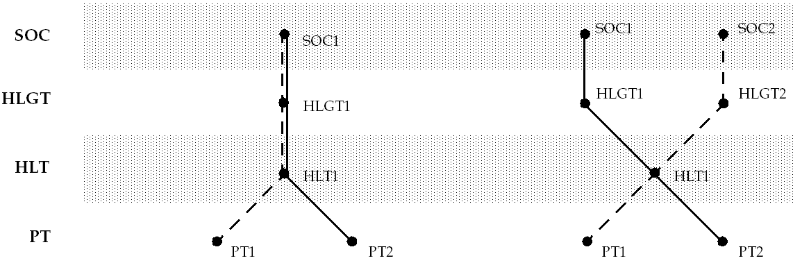

Figure 6-2 shows derivation paths using Primary Link (on the left) and a primary path (on the right). In these examples, all relations between levels are many-to-many, so Primary Links are required for each relation in the derivation path.
The example on the left shows a dictionary structure without a group level, where a Primary Link is required between each level and the next higher level. Terms PT1 and PT2 are both defined with a Primary Link to the same term—HLT1—in the next higher level. Their derivation path is the same because the rest of the derivation path depends on the Primary Links defined for the higher-level terms: HLT1 has a single Primary Link to HLGT1, which has a single Primary Link to SOC1.
The example on the right shows a dictionary structure where the HLT, HLGT, and SOC levels are all included in a group level, but a primary path is defined between the PT level and the group level. In this case, terms PT1 and PT2 can be linked to the same term in the HLT level and yet be linked to different terms in the two higher levels. This model conforms to MedDRA's structure.
Note that there is a third possible structure. If you defined the same group level as in the example on the right—containing the SOC, HLGT, and HLT levels—and defined a Primary Link from the PT level to the group level instead of a Primary Path Link, then the terms PT1 and PT2 would each link to HLT1 but, if Many cardinality were defined from the HLT to the HLGT and from the HLGT to the SOC, their derivation path would end there. No higher level terms could be derived because no other Primary Links or primary paths would exist.If Single cardinality were defined from the HLT to the HLGT and from the HLGT to the SOC, and those levels were defined as reportable and their relations as derivable, the derivation path would continue all the way to the SOC level.
Figure 6-2 Derivation Path Examples for MedDRA

For example, you could define WHO-Drug as shown in Figure 6-3, with two group levels, ATC and classification level VTC:
Figure 6-3 Group Levels in a Sample WHO-Drug Dictionary
This definition of WHO-Drug makes use of the Group Level feature as described in the following two sections.
By defining the classification level (the level in which TMS looks for a match to verbatim terms) as a group level, you can include more than one sublevel within the group for TMS to search. This increases the number of terms TMS can search without forcing the same terms to exist on multiple levels, which reduces the size of the dictionary. If you define a group level to be the classification level, you must specify that a term can exist in only one of the group's sublevels at a time. To enforce this structure, choose Level from the Term Uniqueness list when you define the group level.
In the WHO-Drug structure shown above, the classification level is defined as the group level called VTC, which contains as sublevels the Preferred Name level and the Synonym level. When TMS attempts to classify a verbatim term, it searches both sublevels, one after the other. Because TMS searches both levels to find a match, it is not necessary to include every preferred term in the Synonym level because TMS searches both levels to find a match.
Grouping the dictionary's higher levels and requiring a Primary Link to the group level enables you to define a Primary Link for a specific term to any one of the group's sublevels. TMS derives the Primary Link term and related terms in any higher levels within the group if the following conditions apply:
There is a many-to-one or one-to-one relation between each lower and higher level (Single cardinality is required at the higher end).
The group level and all its sublevels are defined as reportable.
The relations between the levels are defined as derivable.
Alternatively, you can define a primary path between the group level and a lower level. A primary path enables you to specify which terms to derive for each lower level term from each of the group sublevels (see "Primary Links and Primary Path Links").
In addition, you must create structures in the external system to receive the derived values; in Oracle Clinical you need a question set variable and derived question for each sublevel that might contain the Primary Link term (see "Setting Up Data Collection in Oracle Clinical").TMS enforces the following additional constraints for group levels.
A level can be linked to a group level or a sublevel within it, but not to both.
If two group levels are linked, none of the sublevels can be linked directly to sublevels in the other group.
A group level cannot be a child level because that might cause problems during derivation. However, a group level can be lower in the hierarchy than other levels if the top sublevel (not the group level itself) has the child relation with the parent level.
Group levels do not fit easily into a standard tree structure display. TMS displays them as follows:
If a group level exists below the top of the hierarchy, its sublevels are displayed twice: once below the group level, which is displayed as a sibling level to the level above (because it cannot be defined as a child level), and once directly under the higher level with the relation between the top sublevel and the higher level displayed.
The Group Level icon is displayed to the left of the group level.
The relation icons (lines, dotted lines, and branches) appear in color for all sublevels within a group except the topmost, which by definition cannot have a conventional relation defined to the group level.
This display is for a sample WHO-Drug dictionary as shown in Figure 6-4.
Figure 6-4 Sample WHO-Drug Dictionary in the TMS Navigator Tree

To use a dictionary in TMS you must define it in the TMS user interface. This section includes the following topics:
The Base Dictionary tab of the Define Dictionaries window enables you to define the high-level settings of a dictionary and to set a dictionary's status from Provisional to Active. This section discusses definition only, because you must keep the dictionary status set to Provisional while you complete the definition tasks. You use the Base Dictionary tab to set a dictionary to Active status later on. See "Setting the Dictionary's Status to Active".
The high-level dictionary definition includes:
The dictionary's name, short name, and description.
Whether the dictionary is a base dictionary, virtual dictionary, of filter dictionary; see "Virtual Dictionaries" and "Filter Dictionaries".
The dictionary structure (strong or weak); "Strong Dictionaries".
The language of the dictionary's terms and relations.
The Release Label prefix.
Other settings that drive aspects of dictionary structure and the dictionary's availability to other components in TMS.
Appendix A, "Sample Dictionary Definitions" contains the definitions you must use in order to successfully load and activate practice dictionary CLS.
To define the basic dictionary settings:
From the Definition menu, select Define Dictionaries. The Define Dictionaries window opens, with the Base Dictionary tab selected (Figure 6-5).
Figure 6-5 Tabs in the Define Dictionaries Window
Choose whether you want to create a base, filter, or virtual dictionary.
For a base or filter dictionary, begin by highlighting the Dictionaries line in the tree structure and select Insert Record.
For a virtual dictionary, select an active base dictionary folder in the tree and click the Virtual Dictionary tab. Select Insert Record. See "Virtual Dictionaries" for further information.
Define the dictionary itself (Name, Short Name, Description).
Notes:
Special characters are not allowed in the Short Name definition.
The short name must be exactly the same in the GUI definition and in the load script. For the practice dictionary, this is CLS.
To delete a dictionary, you must place the cursor on the right side of the window in the Dictionary field (not the Dictionary Name in the tree). Before you can delete the dictionary itself, you must delete all the dictionary data, its levels, and set it to Provisional status.
The following steps apply to base dictionaries only. Virtual dictionaries inherit all of the settings from the steps below from their base dictionaries.
From the Language list, select the language for this dictionary. You can link terms in dictionaries that have different languages by using named relations of type Translation.
From the Dict. Type list, select one of the following:
Base. Select Base to define a dictionary published by an external organization (such as MedDRA or WHO-Drug, or a legacy dictionary developed by your company.
Filter. Select Filter to use MedDRA SMQs or a similar standardized query dictionary; see "Filter Dictionaries" for further information.
From the Folder Type list, select Strong to create a strongly defined dictionary or Weak to create a dictionary folder.
Leave the Status set to Provisional until you are ready to activate and use the dictionary; see "Setting the Dictionary's Status to Active".
Enter a Label Prefix. Accept the default value of 1. or enter the prefix of your choice. TMS automatically concatenates this value with a build number that represents the number of times Activation has been run on the dictionary. If you use a numerical prefix, you may want to end it with a period/full stop (.) to separate the prefix from the build number.
You may want to use additional decimal places to accommodate point releases of the same dictionary, and you may want to use the dictionary's official release number.
For example, if you define a label prefix of 3.0. when you initially load WHO-Drug 3.0, TMS assigns a Release Label of 3.0.1 to the successfully activated terms and relations the first time you run Activation on the Activation Group, 3.0.2 the second time, and so on. You can use Release Labels, including the label prefix, to define named relations of type Release Label (RL); see "Defining Named Relations".
You can also use a text prefix such as MEDDRA, or a prefix that combines text and numbers, such as MEDDRA7.0.
Assess the following options for your dictionary, selecting the appropriate boxes:
VT Level Required? For strong dictionaries only. If selected, you must define a classification level or classification group level in your dictionary—which, in turn, creates a Verbatim Term level—before you can activate this dictionary. In the TMS modules that deal with verbatim terms (every module under the VTA Maintenance and Omission Management nodes, as well as Browse VT Classification Data), TMS populates the list of values in the Dictionary field from the set of dictionaries that have a VT Level Required? selected.
Web Search Accessible? If selected, the dictionary is available for use in the Research/Document Repository tab in the HTML Browser (see Chapter 14, "Using the HTML Browser").
Accessible to Light Browser? Can the dictionary be used at all in the HTML Browser? If selected, TMS users will be able to browse and search this dictionary's terms, relations, and VTAs in the HTML Browser.
Before activating this option, consider this dictionary' usage and the sensitivity of its data. The HTML Browser may be set for Auto-login, meaning that users do not have to enter a user name and password to browse accessible data. If this dictionary data is sensitive, you may not want to make it available in the HTML Browser.
Do check this flag for filter dictionaries to enable filter dictionary searches using MedDRA SMQs.
Term Uniqueness Enforced? If selected, terms in this dictionary must be unique over the scope of the entire dictionary. When you choose to enforce uniqueness for an entire dictionary, you in turn enforce term uniqueness on all levels and group levels within that dictionary.
Autoqueried in Light Browser? Is the dictionary available for browsing in the Exploration/Hierarchies tab of the HTML Browser? If selected, the HTML Browser automatically queries for all terms in the top level of the dictionary when you select the dictionary in the main HTML Browser window. This setting is appropriate only for strong dictionaries (dictionaries with hierarchical levels defined).
Not recommended for dictionaries in which most or all of the terms are stored in the highest or only level, because autoqueries in such dictionaries can be very time- and resource-consuming.
The Terminologies tab in the HTML Browser appears only if both Autoqueried in Light Browser? and Accessible to Light Browser? are checked for at least one of the dictionaries linked to the current domain.Dictionary Term Display Procedure If desired, specify a procedure in this field to modify the behavior of the Dictionary Term field in VT classification and reclassification. By default, TMS displays the dictionary term to which the selected verbatim term is classified, if any. By writing a procedure and specifying it for a dictionary, you can display a different term in these fields.
For details about writing a Dictionary Term Display Procedure, see "Dictionary Term Display Procedure". Because this feature is only relevant for verbatim term classification, enter a procedure in this field only for strong dictionaries with verbatim term levels.
Save. For a base dictionary, TMS inserts the new dictionary into the tree structure. Virtual dictionaries do not appear in the navigation tree within the Define Dictionaries module. In either case, TMS populates the audit information fields.

To assign a dictionary to an existing TMS domain:
From the Definition menu, select Define Domains to reach the Define Domains window and query for the domain to which you want to assign one or more dictionaries.
Click the Dictionaries button to reach the Define Domain Dictionaries window.
Click the ellipsis (…) or press F9 to launch the list of values for available dictionaries.
Select a dictionary and click OK.
Select the VTA Appr Reqd? box if you want to require that in this dictionary/TMS domain combination, all VTAs are created as Unapproved. There is one exception to this rule: if the VTA has been created via Synchronization because of a direct match to a dictionary term, the VTA is created as approved.
This may be useful at the beginning stages of a study, or use of the TMS domain, because it gives you the opportunity to manually check TMS's classifications. When you are satisfied that a classification is correct, you can manually approve the VTA in the Approve VTAs window under the Omission Management menu. After you do, TMS classifies all future occurrences of the verbatim term automatically. See "Approved and Nonapproved VTAs".
The default setting of the VTA Appr Reqd? flag is determined by the setting of a reference codelist value that appears in the TMS_CONFIGURATION codelist; see "DOMVTAAPPRREQD".
You can change the VTA Appr Reqd? flag setting at any time, including during an ongoing study.
Select the Action Appr Reqd? box if you want to require that in this dictionary/TMS domain combination, all Answerable Action assignments must be manually approved. Internal Actions are used for this purpose.
The default setting of the Action Appr Reqd? flag is determined by the setting of a reference codelist value that appears in the TMS_CONFIGURATION codelist; see "DOMACTAPPRREQD".
You can change the Action Appr Reqd? flag setting at any time, including during an ongoing study.
In the Non Appr DT drop-down:
Select None if you want to prevent classification to nonapproved dictionary terms.
Select VTA if you want to allow classification to nonapproved dictionary terms. This setting may be appropriate, for example:
during post-marketing surveillance if you do not want to have to reclassify verbatim terms whose dictionary terms become invalid (nonapproved) after a dictionary upgrade
if you are using MedDRA-J and want to be able to classify terms to nonpreferred Japanese terms when multiple Japanese terms correspond to the same English term.
When you select this option, in this domain the Autoclassification job treats nonapproved terms exactly the same as approved terms in this dictionary.
You can change this value from VTA to None only if no current VTAs are linked to a nonapproved dictionary term in the dictionary/domain combination.To add another dictionary, click in the next row and repeat the process.
Click OK. TMS saves the domain/dictionary links you have defined.
To unlink a dictionary (to prevent its use in this TMS domain), highlight it and select Record, then Delete.
