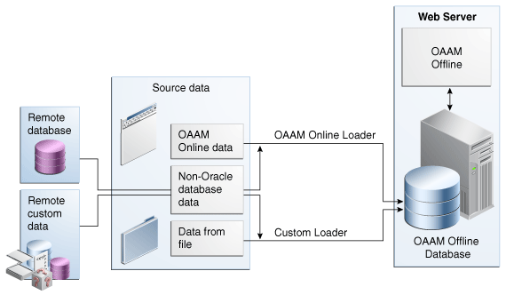

OAAM Offline is a standalone application.Unlike OAAM Online, OAAM Offline does not involve a client application. The relationship between the source data, the loaders, the Web server that hosts OAAM Offline, and the database that stores the customer login and transaction data is shown in Figure 22-1, "OAAM Offline Architecture".
OAAM Offline has its own database. This database has an identical schema to that of the OAAM Online version. It is used to load customer data to perform risk analysis and tune rules. OAAM Offline can support both login and transaction data. For information on the types of loaders that are used to load data, refer to Section 22.1.7, "Data Loaders."
If you want to load the customer data (source data) into the Offline database, you will need to create a Load Job, and a data loader is required to load the data into the database.

Loaders load the customer login or transaction data that will be processed for jobs.
The standard OAAM Loader, which is shipped with OAAM, can be used to load login data from an OAAM schema database or a remote database that is mapped to the OAAM schema.
Custom data loaders are developed to accomplish complex and custom use cases specific to a deployment. Login and transaction data can be loaded from almost any source including files. OAAM supports custom loaders. For more information on developing a custom loader, refer to the "Developing a Custom Loader for OAAM Offline" chapter of the Oracle Fusion Middleware Developer's Guide for Oracle Adaptive Access Manager.
