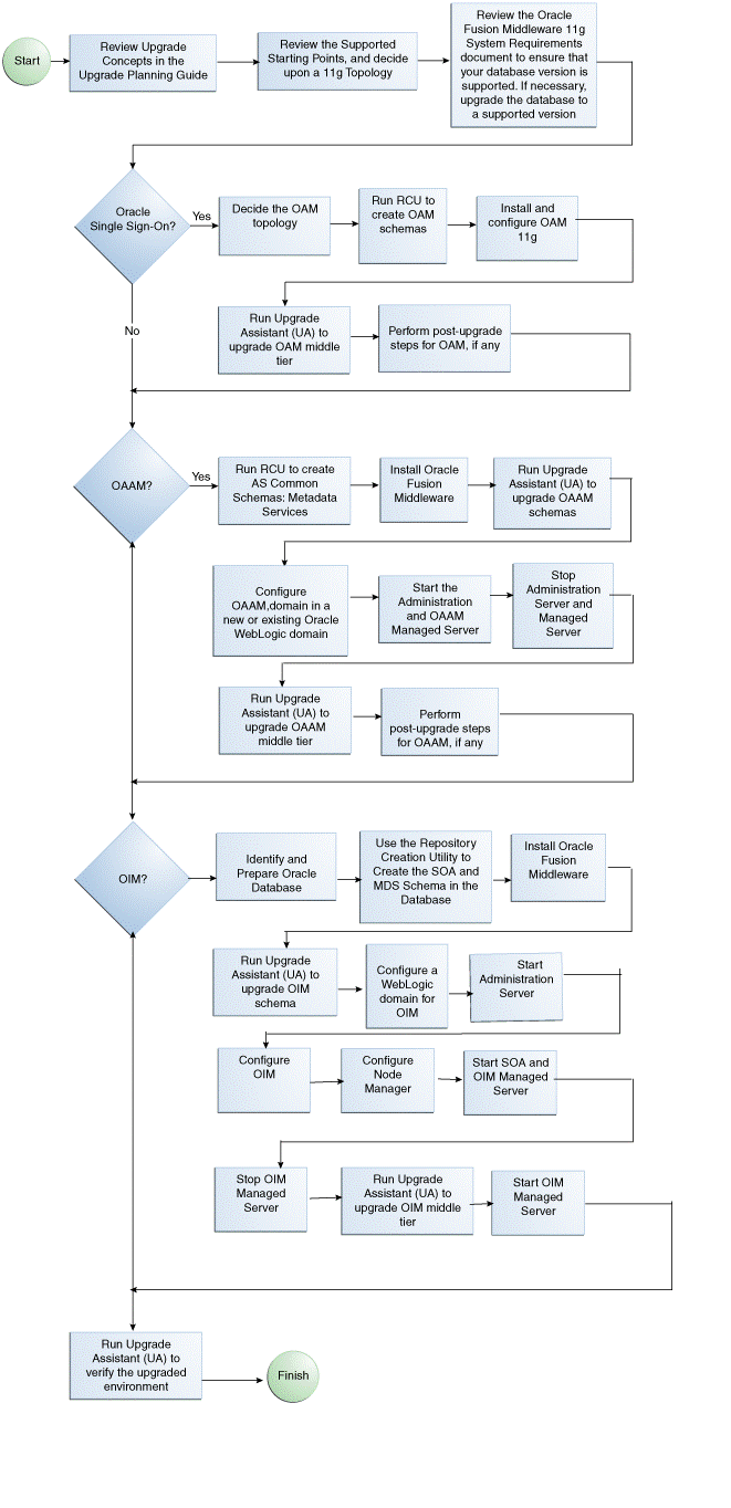

Figure 8-1 provides a flow chart of the Oracle Single Sign-On and Oracle Identity and Access Management upgrade process. Review this chart to get familiar with the steps you will be required to take, based on your existing version of Oracle Single Sign-On, Oracle Adaptive Access Manager, and Oracle Identity Manager.
Figure 8-1 Flow Chart of the Oracle Single Sign-On and Oracle Adaptive Access Manager Upgrade Processes
Table 8-1 describes each of the steps in the upgrade process flow chart, which is shown in Figure 8-1. The table also provides information on where to get more information on each step in the process.
Table 8-1 Table Describing the Steps in the Oracle Identity Management Upgrade Process
