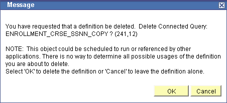

Deleting a Connected Query
To delete a connected query:
Access the Connected Query Manager page by selecting Reporting Tools, Connected Query, Connected Query Manager.
Click the Delete link next to the connected query to delete.
A confirmation message appears asking if you want to delete the existing connected query.
Click the OK button to continue and delete the connected query.
Alternatively, click the Cancel button to cancel the deletion and return to the Connected Query Manager page.
This is an example of the delete confirmation message:
Example of the confirmation message

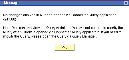

Opening a PeopleSoft Query Using Connected Query Manager
When you open a PeopleSoft query using the Connected Query Manager, the Query Manager component appears in a read-only mode along with a message informing you that no changes are allowed to the query that is opened. The Query Manager that is being opened through the Connected Query Manager is fully functional. It enables you to run a query, view SQL that is being generated by query, view the query structure, view query prompts, view query criteria, and so on, but it doesn't allow you to save any changes for the opened query.
This is an example of the message received when you open a PeopleSoft query in the Connected Query Manager:
Sample message received when you open a PeopleSoft query in the Connected Query Manager
