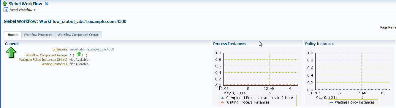

Figure 7-1 shows the Siebel Workflow page.
Figure 7-1 Siebel Workflow Page
Surrounding text describes Figure 7-1 .
