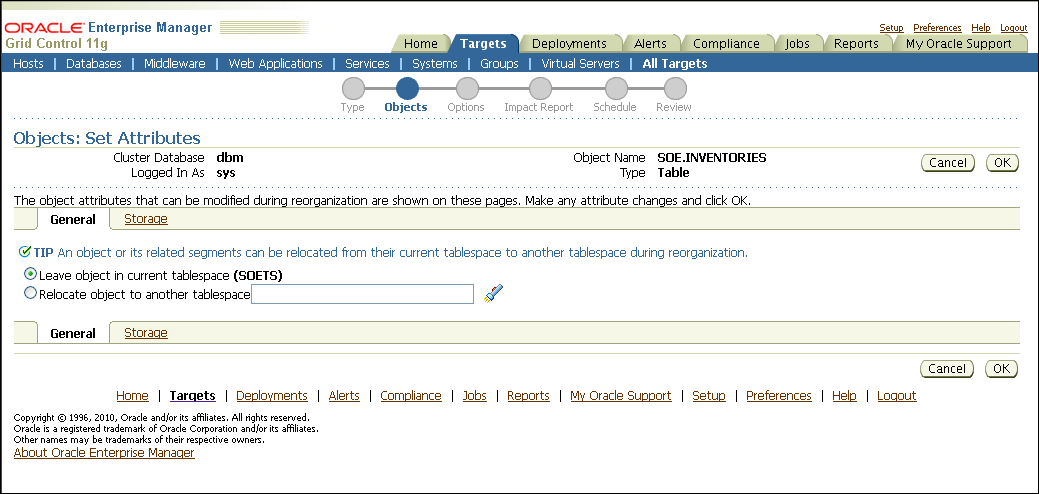

Database object reorganization or redefinition
Changes to the logical structure or the physical organization of Oracle Database objects, primarily to improve performance or manageability.
Changes to the data or schema.
Using the Oracle Database online redefinition feature enables objects to be available during the reorganization or redefinition.
  • Moving an object to a different tablespace
  • Converting a table to a partitioned table
  • Add, modify, or drop one or more columns in a table or cluster
Online object reorganization with DBMS_REDEFINITION (see Section 14.2.10, "Data Reorganization and Redefinition")

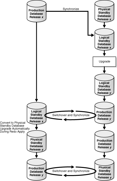

14.2.6.2.2 Transient Logical Standby Database Rolling Upgrade
You can use a transient logical standby database to perform a rolling database upgrade using your current physical standby database by temporarily converting it to a logical standby database. Use a transient logical standby when your configuration only has a physical standby database. Performing a rolling upgrade using a transient logical standby is similar to the standard SQL Apply rolling upgrade with the following differences:
  • A guaranteed restore point is created on the primary database to flash the database back to a physical standby database after the switchover.
  • The conversion of a physical standby database to a logical standby database uses the KEEP IDENTITY clause to retain the same DB_NAME and DBID as that of its primary database.
  • The ALTER DATABASE CONVERT TO PHYSICAL STANDBY statement converts the original primary database from a logical standby to a physical standby database.
  • The original primary database is actually upgraded through Redo Apply after it is converted from the transient logical standby database role to a physical standby database.
Figure 14-1 shows the flow of processing that occurs when you perform a rolling upgrade with a transient logical standby database.
To simplify the operation shown in Figure 14-1, a Bourne shell script is available that automates the database rolling upgrade procedure (starting with Oracle Database 11g Release 1). The database rolling upgrade is performed using an existing Data Guard physical standby database and the transient logical standby rolling upgrade process. The Bourne shell script, named physru, is available for download with details in "Oracle 11g Data Guard: Database Rolling Upgrade Shell Script" in My Oracle Support Note 949322.1 at
https://support.oracle.com/CSP/main/article?cmd=show&type=NOT&id=949322.1
Figure 14-1 Using a Transient Logical Standby Database for Database Rolling Upgrade
Description of Figure 14-1 follows
Description of "Figure 14-1 Using a Transient Logical Standby Database for Database Rolling Upgrade"

14.2.10 Data Reorganization and Redefinition
Many scheduled outages related to the data server involve some reorganization of the database objects. The Online Reorganization and Redefinition feature of Oracle Database enables data reorganization to be performed even while the underlying data is being modified. This feature enhances availability and manageability by allowing users full access to the database during a data reorganization operation.
In highly available systems, it is occasionally necessary to redefine large tables that are constantly accessed to improve the performance of queries or DML. Using Online Reorganization and Redefinition, administrators have the flexibility to modify table physical attributes and transform both data and table structure at the same time users have full access to the database. This capability improves data availability, query performance, response time, and disk space usage, all of which are important in a mission-critical environment. Plus, Online Reorganization and Redefinition can make the application upgrade process easier, safer and faster.
The recommended best practice is to reorganize tables using the DBMS_REDEFINITION PL/SQL package, because it provides a significant increase in availability compared to traditional methods of redefining tables that require tables to be taken offline. Whether you call DBMS_REDEFINITION manually at the command line or using Oracle Enterprise Manager Reorganize Objects wizard, the entire reorganization process occurs while users have full access to the table, thus ensuring system availability.
Figure 14-2 shows a page in the Oracle Enterprise Manager Reorganize Objects wizard that you can use as an alternative to calling the DBMS_REDEFINITION package at the SQL*Plus command line. After you answer a few questions in the wizard, it generates a script and performs the reorganization.
Figure 14-2 Database Object Reorganization Using Oracle Enterprise Manager
Description of Figure 14-2 follows
Description of "Figure 14-2 Database Object Reorganization Using Oracle Enterprise Manager"
