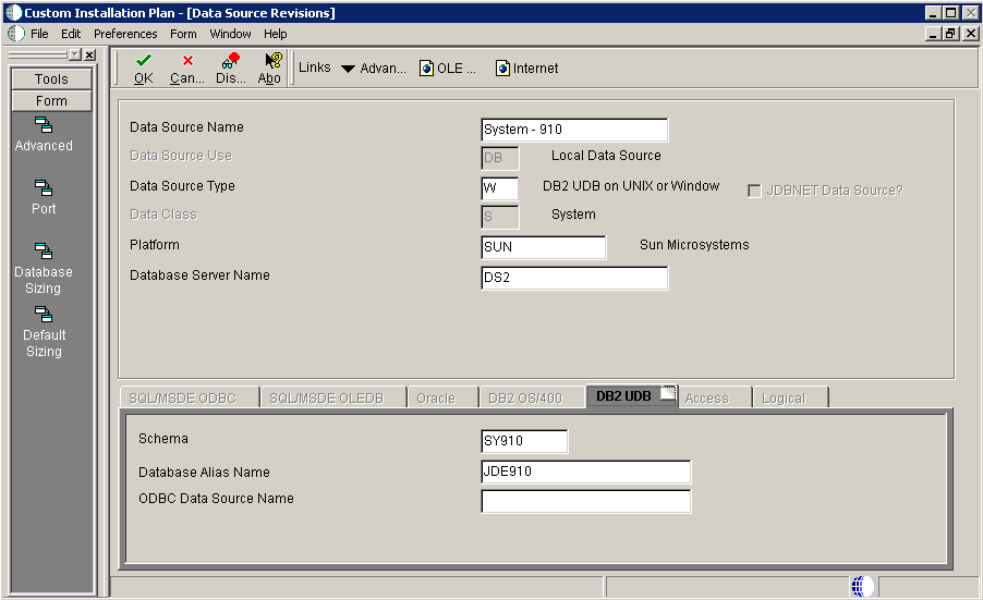

17.7.2.2 Verifying Custom Server Map Data Source Information
To verify custom Server Map data source information:
Surrounding text describes data_srce_svr_map_unix_udb.gif.
  1. On Data Source Revisions, verify your Server Map data source information.
    Tip:
    Default data sources are configured as completely as possible. However, when you run Installation Planner, you might need to modify some data source information to reflect your system-specific configuration.
  2. Click OK.

17.10.4 Verifying the System Data Source
To verify the System data source:
Surrounding text describes data_source_system_unix_udb.gif.
  1. On Data Source Revisions, verify the accuracy of the settings for the System data source.
  2. Click OK.
