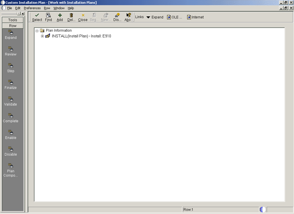

  3. From the System Installation Tools menu (GH961), click Custom Installation Plan.
    Surrounding text describes installation_plans.gif.
  4. On Work with Installation Plans, click Add.
    The Installation Planner form appears.

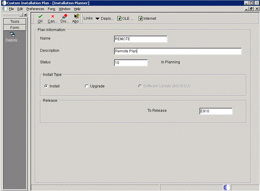

Surrounding text describes remote_plan.gif.
  1. On Installation Planner, complete these fields:
    Field Description
    Name Enter the name of your remote plan.
    Description Enter the description of your remote plan.
    Status Select 10 as the status of your remote plan.
    Install Type Select Install.
    To Release Verify that the release number is E910.
  2. On Installation Planner, click OK.

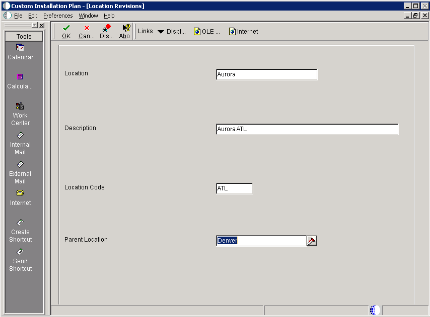

15.4 Entering Plan Location Information
To enter plan location information:
Surrounding text describes location_revs_remote.gif.
  1. On Location Revisions, complete these fields:
    Field Description
    Location Enter the location to which this plan applies. The location could be a city, company headquarters, or a division of a company.
    Description Enter a description of the location name.
    Location Code For a remote location, enter a 3-character alphanumeric identification code. This 3-character code is used as a prefix for the environments of the remote location, and a suffix is attached for replicated data sources. For example, you might use DAL if the location were Dallas, Texas. In that case, the prototype environment would be named DALPY910, and the business data data source would be named Business Data - CRPDAL.
    Parent Location Enter the parent location to which this remote location is attached.
  2. Click OK.

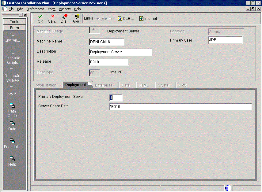

15.5 Entering Deployment Server Information
Once a plan location is specified, complete the information for the Deployment Server. You are given the option to enter a new Deployment Server or choose an existing one. For most situations, you will have a tiered Deployment Server for the remote location.
To enter Deployment Server information:
Surrounding text describes define_dep_server.gif.
  1. At the Installation Planner prompt asking if you want to enter new Deployment Server information, click OK to add a Deployment Server.
    Surrounding text describes dep_svr_revs_custom.gif.
  2. On Deployment Server Revisions, complete these fields:
    Field Description
    Machine Usage Displays the default value of 15 to indicate that this is a Deployment Server.
    Machine Name Enter the name of your Deployment Server. The name is case sensitive, should not exceed 15 characters, and should not contain any special characters.
    Description Enter a description of the machine name. This name includes the location with which this Deployment Server is associated, and whether or not it is the primary server.
    Release Enter the Release 9.1 release number that you are installing, or use the visual assist button to choose one from the list. For example, E910 is the current release.
    Host Type Displays the default value of 50 to indicate that the server type is an Intel NT.
    Location Displays the default location chosen for this plan.
    Primary User Enter the user to whom email is sent when a package is deployed. The default for Primary User is JDE.
  3. On the Deployment tab, complete these fields:
    Field Description
    Primary Deployment Server Enter the hierarchy of the servers. Type
    0
    (zero) if a primary Deployment Server for the location exists and this is a secondary server. Type 1 if this is the primary Deployment Server for the location.
    Server Share Path Enter the server share path where you installedRelease 9.1 on your Deployment Server. Make sure that this path is specific to your version of the release. For example, for Release 9.1, the path ends with\E910.
  4. Click OK.
    Tip:
    If you enter invalid information into a tab field, a stop sign symbol appears next to the tab name, such as Deployment Server. For more information about the error, click the stop sign icon in the bottom right-hand corner of the form.
  5. Click OK.
    Tip:

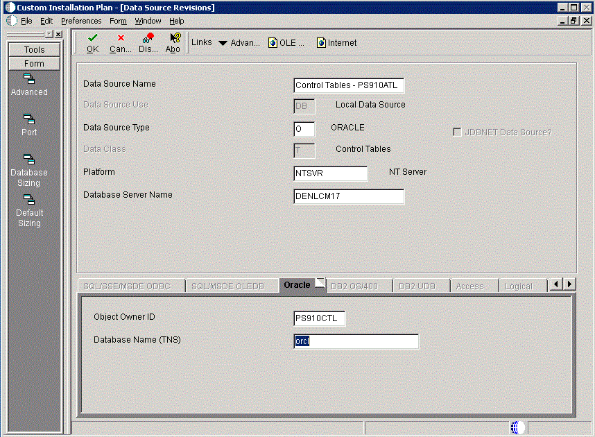

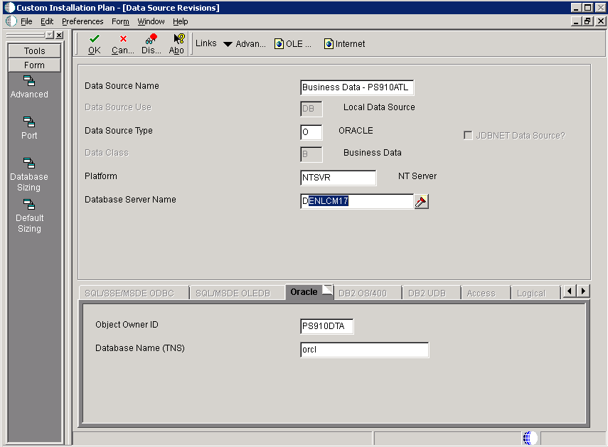

15.7 Enter Data Source Information for Server Map
To enter information for the Server Map data source:
Surrounding text describes data_source_dialog.gif.
  1. On Data Source, click OK to continue entering unique data source information.
    Surrounding text describes data_srce_svr_map_as400.gif.
  2. On Data Source Revisions, verify the accuracy of the Server Map data source.
  3. Click OK.

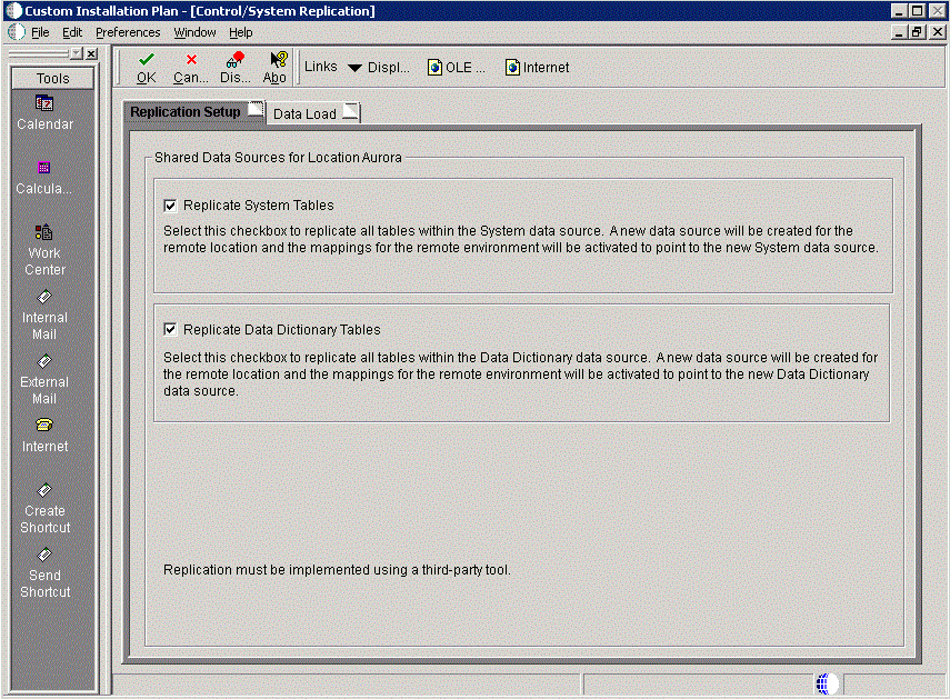

To replicate information to remote locations:
Surrounding text describes replication_setup.gif.
  1. On Control/System Replication, select the Replication Setup tab and select the following options to replicate information to remote locations:
    Field Description
    Replicate System Tables Select this checkbox to replicate all tables within the System data source. A new data source will be created for the remote location and the mappings for the remote environment will be activated to point to the new System data source.
    Replicate Data Dictionary Tables Select this checkbox to replicate all tables within the Data Dictionary data source. A new data source will be created for the remote location and the mappings for the remote environment will be activated to point to the new Data Dictionary data source.
    Caution:
    Replication must be implemented using a third-party tool.

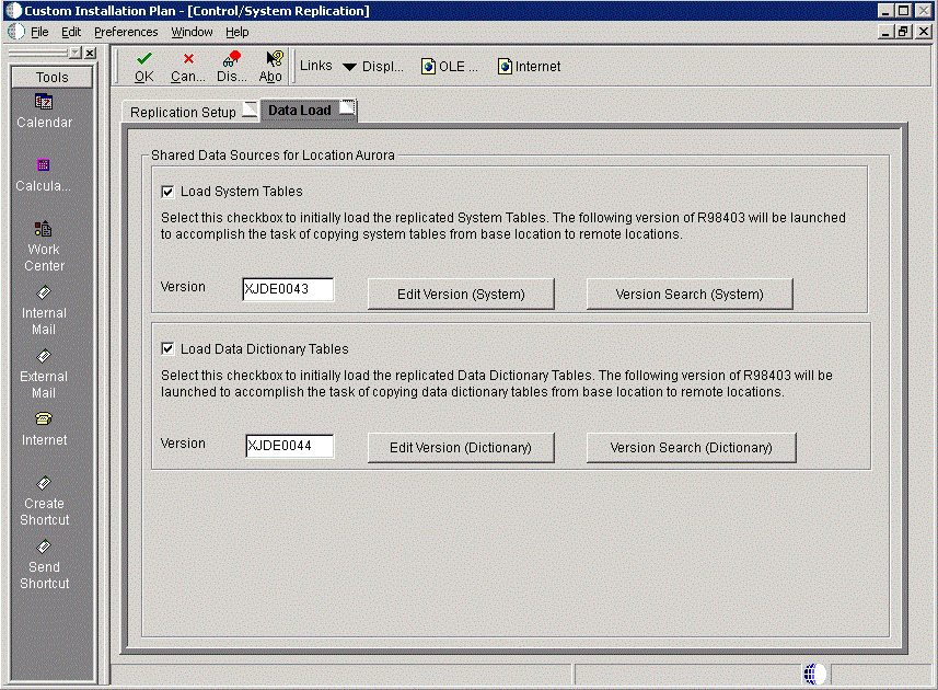

  2. Select the Data Load tab.
    Surrounding text describes data_load_tab.gif.
  3. On the Data Load tab, choose from the following options to copy selected tables to the remote locations:
    Field Description
    Load System Tables Select this checkbox to initially load the replicated System Tables. The following version of R98403 will be launched to accomplish the task of copying system tables from the base location to remote locations.
    Load Data Dictionary Tables Select this checkbox to initially load the replicated Data Dictionary Tables. The following version of R98403 will be launched to accomplish the task of copying data dictionary tables from the base location to remote locations..
    To edit or change the versions of the R98403 program that copy the control tables, constant tables, and master tables, click the Edit or Search buttons next to their respective versions.
    If you have defined multiple locations, the system will prompt you to complete sets of the Replication Setup and Data Load screens for each location.
  4. Click OK.

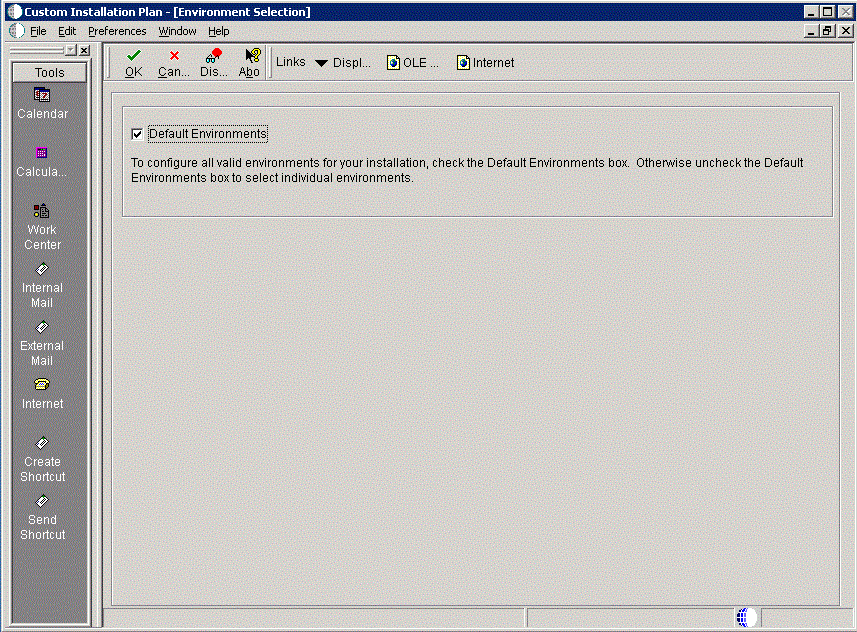

15.12 Setting Up Environments
To set up environments:
Surrounding text describes environment_sel_remote.gif.

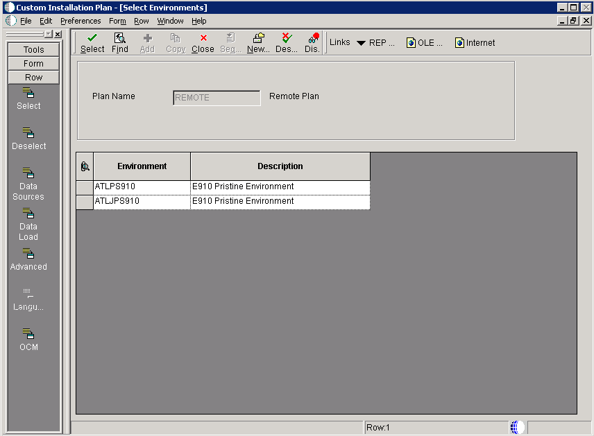

  1. On Environment Selection, with the Default Environments checkbox selected, click the OK button.
    Surrounding text describes select_environments_remote.gif.
  2. On Select Environments, double click on an Environment to select it.
  3. Click the Close button.

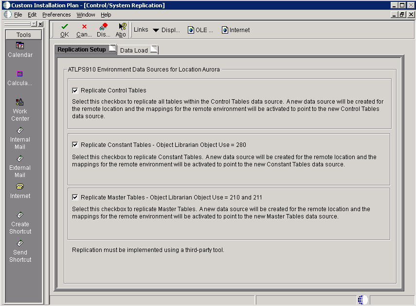

    Surrounding text describes control_sys_replication.gif.
  4. On Control/System Replication, select the Replication Setup tab and select the following options to replicate information to remote locations:
    Field Description
    Replicate Control Tables Select this checkbox to replicate all tables within the Control Tables data source. A new data source will be created for the remote location and the mappings for the remote environment will be activated to point to the new Control Tables data source.
    Replicate Constant Tables - Object Librarian Object Use = 280 Select this checkbox to replicate Constant Tables. A new data source will be created for the remote location and the mappings for the remote environment will be activated to point to the new Constant Tables data source.
    Replicate Master Tables - Object Librarian Object Use = 210 and 211 Select this checkbox to replicate Master Tables. A new data source will be created for the remote location and the mappings for the remote environment will be activated to point to the new Master Tables data source.
    Caution:

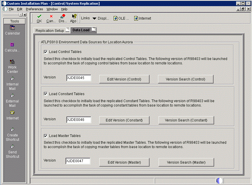

  5. Select the Data Load tab.
    Surrounding text describes data_load_tab_remote.gif.
  6. On the Data Load tab, choose from the following options to copy selected tables to the remote locations:
    Field Description
    Load Control Tables Select this checkbox to initially load the replicated Control Tables. The following version of R98403 will be launched to accomplish the task of copying Control tables from the base location to remote locations.
    Load Constant Tables Select this checkbox to initially load the replicated Constant Tables. The following version of R98403 will be launched to accomplish the task of copying Constant tables from the base location to remote locations.
    Load Master Tables Select this checkbox to initially load the replicated Master Tables. The following version of R98403 will be launched to accomplish the task of copying Master tables from the base location to remote locations.

  2. On Data Source Revisions, enter the data source name for the Business Data data source that will be used by the remote location. For example, Business Data - PS910ATL.
  3. Complete the other fields as applicable for your database and platform.
  4. Click the OK button.
    Surrounding text describes remote_control_tables.gif.
  5. On Data Source Revisions, enter the data source name for the Control Tables data source that will be used by the remote location. For example, Control Tables - PS910ATL.
  6. Complete the other fields as applicable for your database and platform.
  7. Click the OK button.

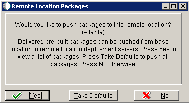

15.14 Remote Location Packages
After you complete the data source setup for the environments, you can choose whether to push packages to a remote location.
Surrounding text describes remote_location_packages.gif.
  1. On Remote Location Packages, click the OK button.

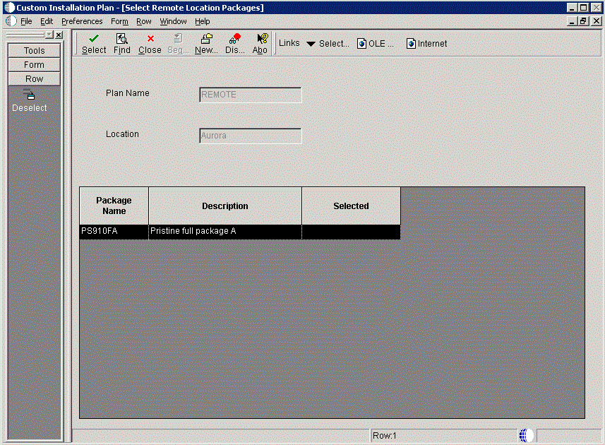

    Surrounding text describes remote_location_pack_form.gif.

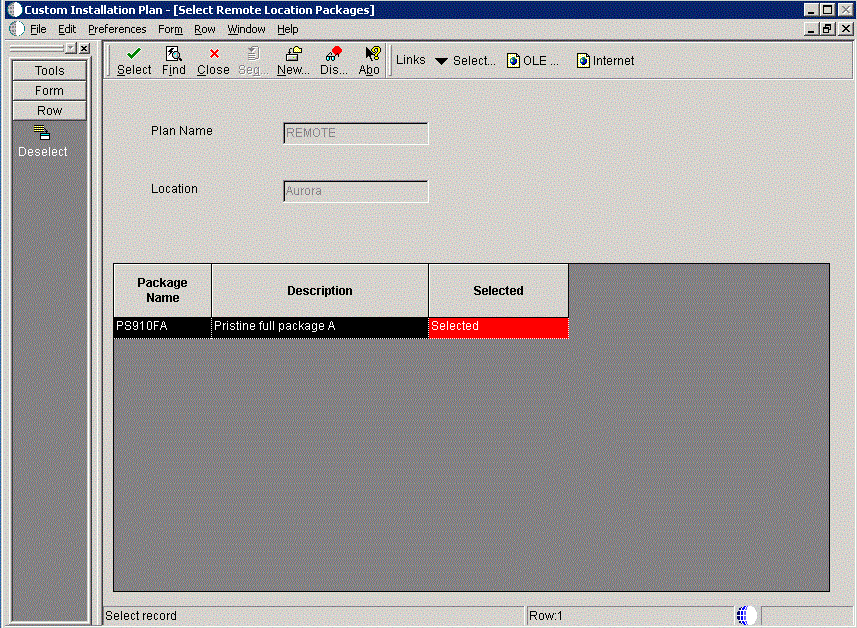

  2. On Remote Location Packages, click the Select button to choose the highlighted package.
    Surrounding text describes remote_loc_form_selected.gif.
  3. On Remote Location Packages, verify that "Selected" is displayed in the "Selected" column.
  4. Click the Close button.

    For more information about Section 22.1, "Installation Planner Validation Report (R9840B)", refer to Chapter 22, "Working with Reports".
  4. On Work With Installation Plans, click Expand to review the plan you created.
