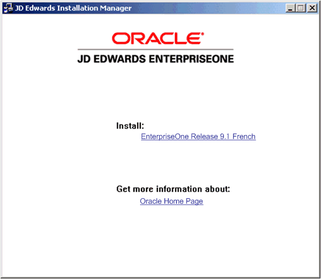

Obtain the JD Edwards EnterpriseOne language and run the setup.exe.
On JD Edwards Installation Manager, click the link for the language that you want to install.
In this example, the language installation image is for French.

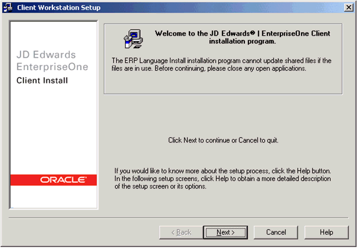

On the Welcome screen, click Next.

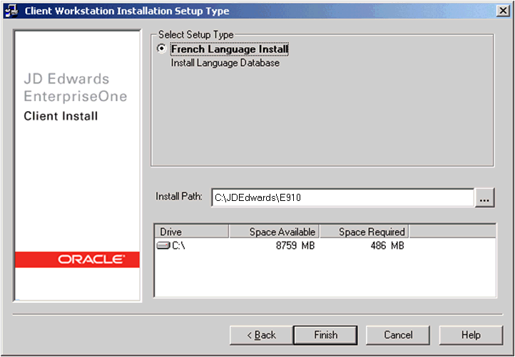

On Client Workstation Installation Setup Type, complete these fields:
| Field | Description |
| Select Setup Type | Ensure the radio button for your language is selected. |
| Install Path | The Installer provides a default path to the existing client installation on this machine:
You must verify that this drive and path is valid for your installation. You can use the browse function to locate the directory. |
Click Finish.

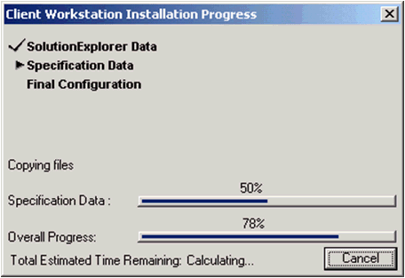

The Client Workstation Install Progress displays the progress of the language installation.

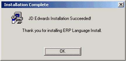

When the installation finishes, the Oracle Deployment Server Setup form indicates whether the installation was successful.
On Installation Complete, click OK.

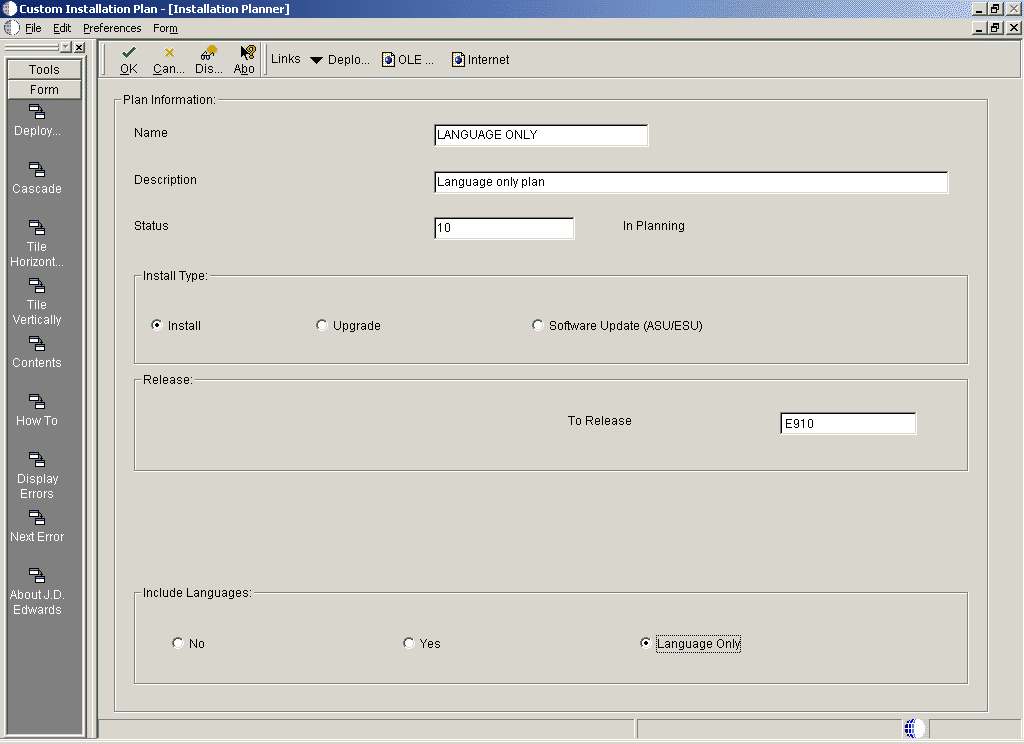

On Installation Planner, enter the basic plan information.
In the Include Language area, select the Language Only option.

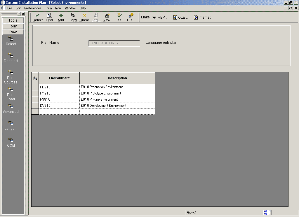

To select an environment:
Choose the environment for which you wish to install a language.
The Language Selection form appears.
