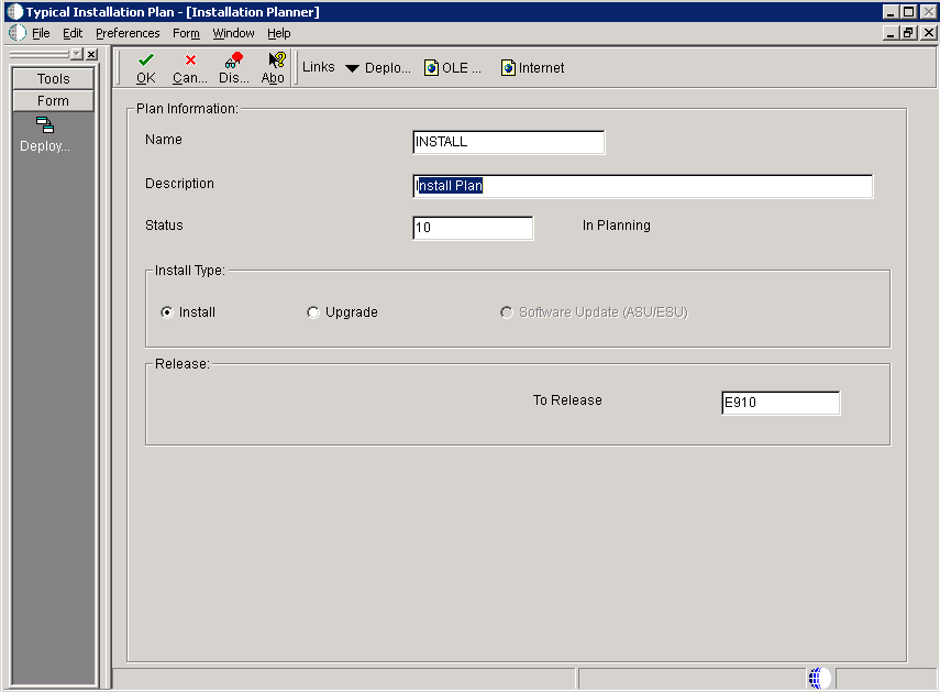

After starting Installation Planner, enter basic plan information, such as plan name and description.
To enter a plan description:
On Installation Planner, complete the following fields:
Name
Enter the name of your installation plan.
Description
Enter the description of your installation plan.
Status
Select 10 as the status of your installation plan.
To
Verify that the release number is E910.
Click OK.

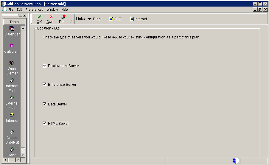

Once a plan location is specified, specify the types of servers you want to add to your installation plan.
To select additional server types:
On Server Add, check the types of servers that you want to add to your configuration.
Click OK.
A Server Revisions form appears in the order listed on the Server Add form for each type of server that you chose.
Continue with the relevant sections that follow.

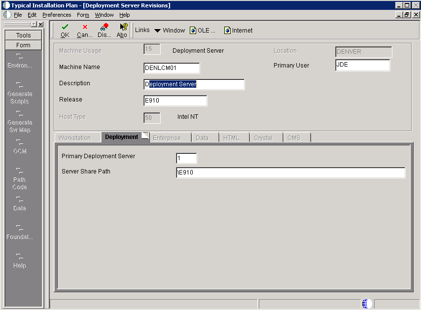

When choosing to add an additional Deployment Server to your plan, the Deployment Server Revisions form appears.
To enter Deployment Server information:
On Deployment Server Revisions, complete the following fields:
| Field | Description |
| Machine Name | Enter the name of your additional Deployment Server. The name is case sensitive, should not exceed 15 characters, and should not contain any special characters. |
| Description | Enter a description of the machine. |
| Release | Enter E910. |
| Location | Displays the system-provided default value chosen for this plan. |
| Primary User | This identifies the user to whom email is sent when a package is deployed. The default for Primary User is The default value for Primary User. |
On the Deployment tab, verify or complete the following fields:
| Primary Deployment Server | This field indicates the hierarchy of the servers. The default value for a secondary Deployment Server is 0. |
| Server Share Path | Enter the server share path where you installedRelease 9.1 on your Deployment Server. Verify that this path matches your version of the release; for example, for Release 9.1, the server share path is\E910. |
Click OK.
