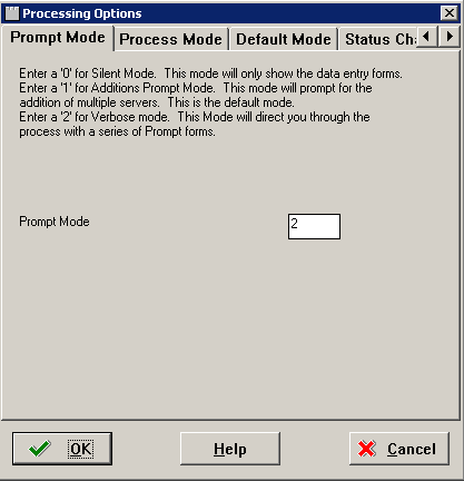

To specify the prompt mode:
Select the Prompt Mode tab.
On the Prompt Mode tab, select a prompt mode:
| Value | Model | Description |
| 0 | Silent | Installation Planner displays only the data entry forms. |
| 1 | Additions Prompt | Installation Planner prompts you to add servers. |
| 2 | Verbose | Installation Planner directs you through creating a plan with a series of prompting forms. |

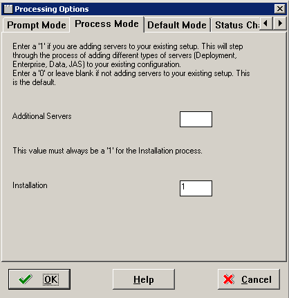

On the Process Mode tab, select the options for the processes that you want to run when you create your plan:
Additional Servers
Enter 1 to add servers to your existing setup (Deployment Server, Enterprise Server, Database Server, HTML Web Server). Enter 0 or leave blank for regular plans.
Caution: You should only change this value when running a Server Plan.
Installation
Enter 1 to run the JD Edwards EnterpriseOne installation automatically.

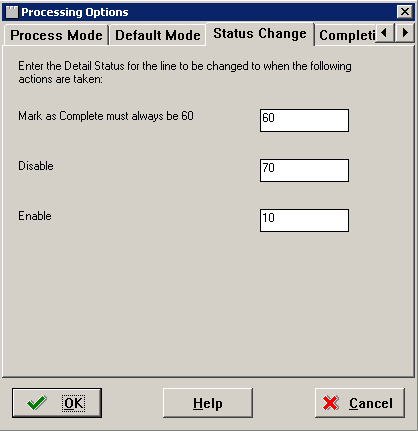

On the Status Change tab, this tab form appears.
Do not make any changes on this tab. These values are hard coded in the application

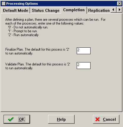

To specify plan completion processes:
Select the Completion tab.
On the Completion tab, complete the fields using these values:
After defining the plan, the options on this tab specify which processes are run. one of the following values:
| Value | Description |
| 0 | Do not run automatically. |
| 1 | Prompt to be run. |
| 2 | Run automatically. |
Finalize Plan
Enter the default option 2 to run automatically.
Validate Plan

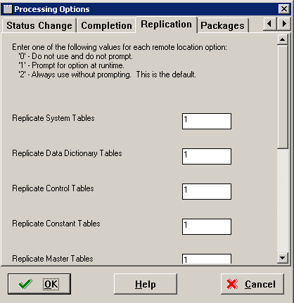

To specify replication options:
Select the Replication tab.
On the Replication tab, complete the fields using these values:
| 0 | Do not use and do not prompt. |
| 1 | Prompt for option at run-time. |
| 2 | Always use without prompting . |
Replicate System Tables
Select whether you have the option to replicate system tables automatically for remote locations.
Replicate Data Dictionary Tables
Select whether you have the option to replicate data dictionary tables automatically for remote locations.
Replicate Control Tables
Select whether you have the option to replicate control tables, menus, and user defined codes automatically for remote locations.
Replicate Constant Tables
Select whether you have the option to replicate constant tables automatically for remote locations. Business data tables are Object Librarian type 280.
Replicate Master Tables
Select whether you have the option to replicate master tables automatically for remote locations. Business data tables are Object Librarian type 210 and 211.

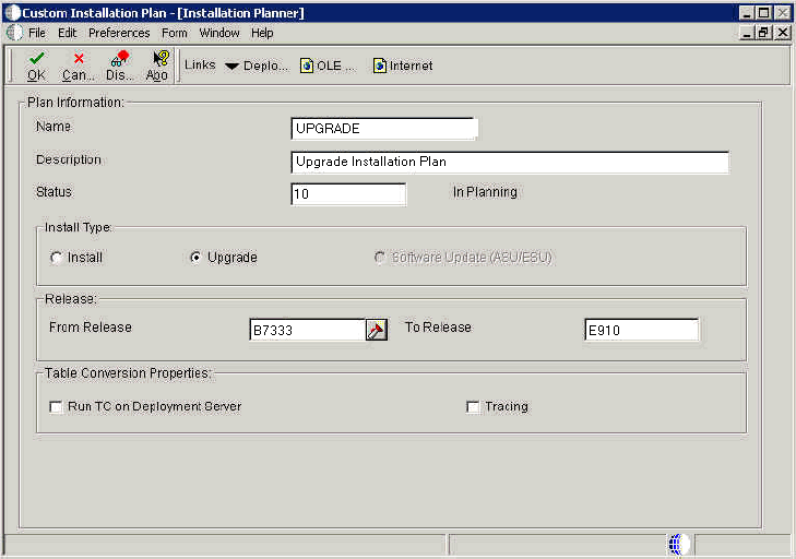

To enter a plan description:
On Installation Planner, complete the following fields:
| Field | Description |
| Name | Enter the name of your plan. |
| Description | Enter the description of your plan. |
| Status | Select 10. This is the default value. |
| Install Type | Select Upgrade.
If the Installation Planner detects registry settings indicating a previous installation of JD Edwards EnterpriseOne has been installed on this Deployment Server, it automatically changes the Install Type to Upgrade. You can also manually change the Install Type to Upgrade. If the previous installation of the Deployment Server is on a different machine, or if this installation is on a remote Deployment Server, the Install Type will be set to Install. In either of these cases, you must manually change the Install Type to Upgrade and the Installation Planner will prompt you for the data source information in a subsequent screen. |
| From Release | Enter the number of the release you are upgrading from.
For example, enter E910 for Release 9.1. |
| To Release | Verify that the release number is E910 (the default value). |
| Table Conversion Properties | Check box to run table conversions on the Deployment Server. The default is to run on the Enterprise Server. |
| Tracing | Turns on debug logging. |
| Include Languages | This is an optional selection that is only available if you have previously specified this Custom plan to install languages. Select yes if you are installing an alternate language. |
Click OK.

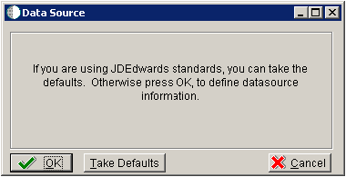

If you are installing the Deployment Server on the same machine as a previous release, and the Installation Planner has detected that previous release, you can proceed to the next step.However, if you manually changed the Install Type to Upgrade, most likely because the previous release of JD Edwards EnterpriseOne was installed on a different machine, or this installation is on a remote, Deployment Server, you will be presented with the following screen in which you must enter the data source information that will enable the Installation Planner to locate the previous release.

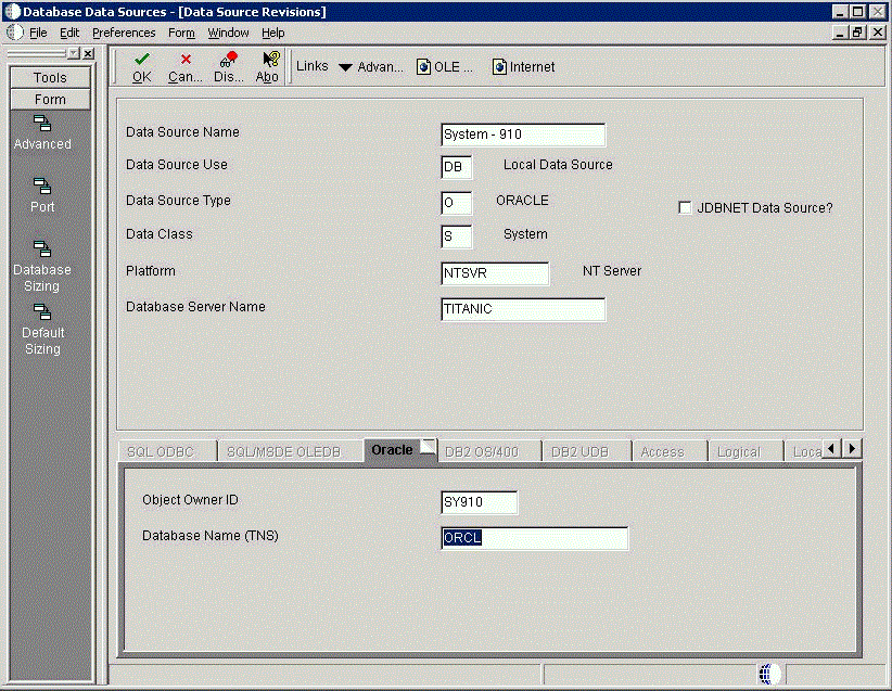

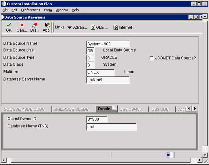

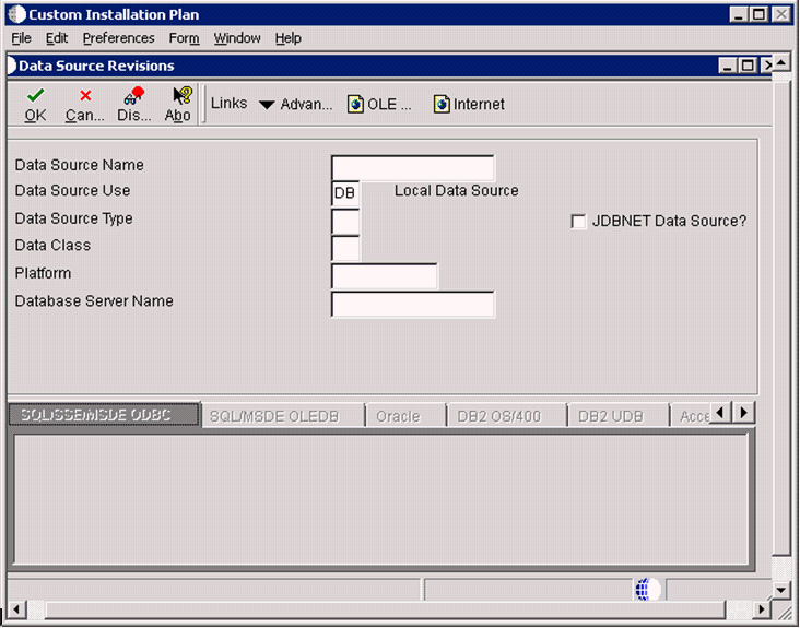

On Data Source Revisions, complete the following fields:
| Data Source Name | Enter the name of the System data source to be upgraded. For example:
System - 910 |
| Data Source Use | You can accept the default value of DB. |
| Data Source Type | Choose the type of data source. Valid value is:
O - Oracle |
| Platform | Enter your platform. For example, NTSVR. |
| Database Server Name | Enter the name of your database server on which your previous System data source resides. |
| Object Owner ID | Enter the name of the owner of this object. |
| Database Name (TNS) | Enter the Oracle database name that is in the tnsnames.ora on the machine that contains the System datasource for the previous release. |
Click OK.

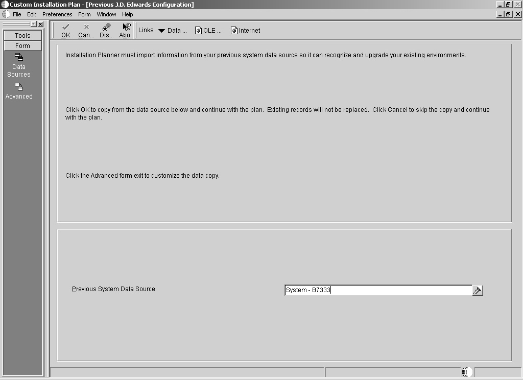

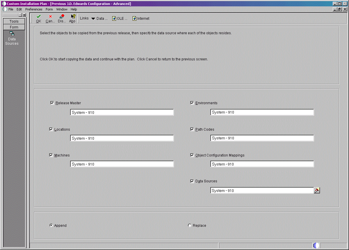

This form imports information from your previous system data source. The previous system data source you are upgrading from should be prepopulated. Use the Data Sources form exit to verify the data source is set up correctly.
If this is correct, click OK and proceed to step 9. For more control over the process, click the Advanced form exit and continue with the next step. This screen sets up to copy information from the previous system data source into planner while providing some default information for the user. It is also used for spec merge and table conversions to provide access to the previous environments.

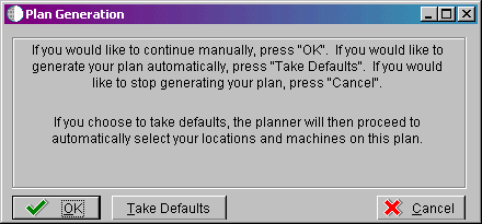

Choose a method for generating your plan:
To manually create your plan, click OK and continue with Section 5.4.3, "Entering Location Information".
To enable the system to automatically enter the locations and machines from the previous version, click Take Defaults.
The machines that were imported from the previous system data source are entered into the current plan. Skip the sections on entering locations, Deployment Servers, Enterprise Servers, and machines or servers, and continue with Section 5.4.9, "Entering Shared Data Source Information".

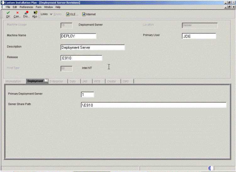

Once a plan location is specified, specify the information for the primary Deployment Server you will use in this plan. While Release 9.1 enables more than one Deployment Server to be defined, only the primary Deployment Server is defined at this time. You can choose a primary Deployment Server from the list of existing servers or you can enter information for a new server.

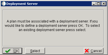

If you installed JD EnterpriseOne Files to a remote Deployment Server, you should click the OK button to define a new Deployment Server. The deployment server name is the remote machine name by default.

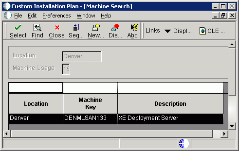

On Deployment Server, click OK to define a new Deployment Server, or click Select to choose from a list of existing Deployment Servers.
If you choose Select, you are presented with the Machine Search table, from which you can make your selection.
On Deployment Server Revisions, complete or verify these fields:
| Machine Usage | Displays the value 15 by default to indicate that this is a Deployment Server. |
| Machine Name | Displays the name of the Deployment Server appears by default. The name is case sensitive, should not exceed 15 characters, and should not contain any special characters.
Remote Deployment Server. If you installed JD EnterpriseOne Files to a remote Deployment Server, you should click the OK button to define a new Deployment Server. The deployment server name is the remote machine name by default. |
| Description | Enter a long description for the machine. This description should include the location with which this Deployment Server is associated and whether or not it is the primary server. |
| Release | Enter the Release 9.1 release number you are installing or use the visual assist button to choose one from the list. The default value is E910. |
| Host Type | Displays the value of 50 appears by default to indicate that the server type is Intel NT. |
| Location | Displays your current location as the default value. |
| Primary User | Specify the user to whom an email is sent when a package is deployed. The default value for Primary User is JDE. |
On the Deployment tab, complete these fields:
| Primary Deployment Server | Define the hierarchy of the servers. Values are:
1- Primary Deployment Server (default value) 0 - Secondary Deployment Server The server share name of the directory to which you installed Release 9.1 on your Deployment Server. Verify that the server share name for Release 9.1 is |
Click OK.

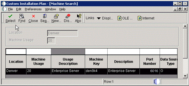

On Enterprise Server, click OK to define a new Enterprise Server, or click Select to choose from a list of existing Enterprise Servers.

On Data Source, you are prompted to enter Data Source Information for the Enterprise Server.
Choose one of these options:
Click OK to continue entering unique data source information. If you choose this option, continue with this task.
Click Take Defaults to select the default data. If you choose this option, you can skip to Section 5.4.2, "Caution When Choosing Take Defaults"
Caution:
In order to ensure the validity of all subsequent plan information, it is strongly recommended that even advanced users should not choose this Take Defaults option. Instead, you should step through plan and verify that the Planner is populating information exactly as you expect to match your requirements.Tip:
If you do not follow the recommendation as outlined in the "Caution When Choosing Take Defaults" above, a dialog is displayed prompting you for the Oracle connect string.

To verify the data source for Data Dictionary:
On Data Source Revisions, verify the accuracy of the settings for the Data Dictionary data source.
Click OK.

To verify the System data source:
On Data Source Setup, verify the accuracy of the settings for the System data source.
Click OK.

On Data Source Revisions, verify the data source for your Business Data.
Be sure this data source points either to the existing production data source you want to upgrade or to a copy of it.
Business Data data sources are specific to the environment and pathcode.Click OK.

To finish the Installation Plan.
A message appears to let you know that the installation plan has been finalized.
When the plan is finalized:
The status is set to 20, which signals that several adjustments to tables were made according to your plan.

Click OK to exit the concluding message box and initiate the Planner Validation Report.
If processing option default was chosen, Planner Validation Report automatically prompts you to run this report.
If processing option default was not chosen, on the tree view of your plan, click Validate to initiate the Planner Validation Report.
To conclude the validation planner report:
On Report Output Destination, choose On Screen or To Printer, and click OK.
Review the report to confirm that all records were validated.
After reviewing the report, on the Batch Versions form, click Close.
For more information about Section 25.1, "Installation Planner Validation Report (R9840B)", refer to Chapter 25, "Working with Reports".

This section is only applicable if you installed your E910 deployment server a different machine (as the previous release). If you install the E910 Deployment Server on the same machine (as the previous release), the Installation Planner automatically detects the local System data source and uses it to configure the upgrade.Before you run the Installation Planner for an upgrade, you must ensure that you have a data source properly configured on the E910 Deployment Server so this machine can access system tables for the previous release residing on a different machine. This is because the installation planner must import information from previous system data source in order to recognize and upgrade your existing environment.
If the Installation Planner cannot detect the System data source on this machine and it is an upgrade plan, it displays this screen prompting you to enter the information about the previous System data source.
On Custom Installation Plan, Data Source Revisions, select the appropriate tab for your previous database and complete the fields to match your previous data source.
For example, if your previous data source was Oracle, your previous platform was Linux, and your previous EnterpriseOne applications release was 9.0, a properly completed form would look like this:
Click the OK button to verify your data source connection information to the System data source on the remote machine.
