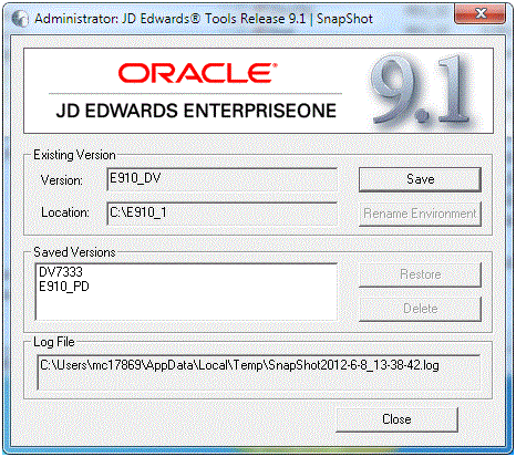

5.1 Understanding SnapShot
The SnapShot program manages multiple instances of JD Edwards EnterpriseOne Deployment Servers or Development Clients on a single machine. Using this program you can save and restore copies of an installed Deployment Server or Development Client. For instructions on using SnapShot with the Development Client, refer to the JD Edwards EnterpriseOne Development Client Installation Guide.
Below is an example of SnapShot managing multiple tools releases including B7333 (DV7333) and two installations of E910 (E910_DV and E910_PD).
This image is described in surrounding text.
The preceding image shows the JD Edwards main SnapShot window. The main features of this window, from top to bottom, include:
  • Close (icon)
    The Close icon is located in the upper right hand corner. Click this icon to exit SnapShot.exe.
  • System (icon)
    The System icon is located in the upper left hand corner. Click on this icon or right-click on the title bar to display a drop-down menu that contains "About EnterpriseOne SnapShot…." Selecting this item displays version and build information about SnapShot as shown below:
    Surrounding text describes about_snapshot.gif.
  • Existing Version
    The Existing Version area contains these fields and buttons:
    • Version
      The Version field lists the existing installed Deployment Server. Initially, this is the release specified in the installed package. After you save and then restore a SnapShot, this field will be the name that you gave the SnapShot when you saved it.
    • Location
      The Location field shows the JD Edwards EnterpriseOne installation directory.
    • Save
      Use the Save button to save the installed JD Edwards EnterpriseOne to a SnapShot.
    • Rename
      Use the Rename Environment button to rename the path code and environment names of the installed JD Edwards EnterpriseOne. This function is not available on the Deployment Server.
  • Saved Versions
    The Saved Versions area contains a field that lists saved versions (also called SnapShots). The example in this image shows the following versions: DV7333 and E910_PD.
  • Restore
    Use the Restore button to restore a saved version (SnapShot) to a runnable JD Edwards EnterpriseOne installation.
  • Delete
    Use the Delete button to remove a saved version (SnapShot).
  • Log File
    The Log File area displays the log file path and name.
  • Close
    Use the Close button to exit SnapShot.exe.

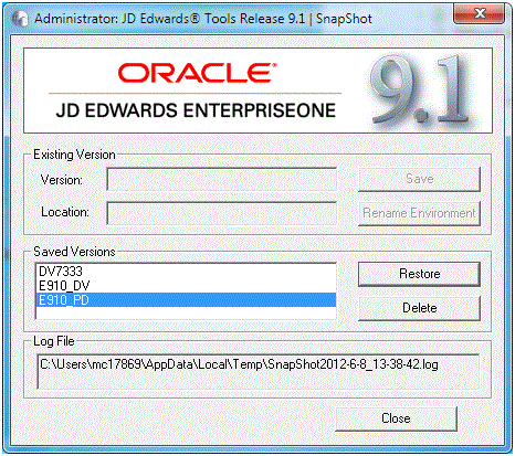

5.3.3 Restoring a SnapShot
To restore a SnapShot:
  1. On the main SnapShot window and in the Saved Versions section, highlight the saved instance that you want to restore.
  2. Click the Restore button.
    SnapShot restores the selected instance of JD Edwards EnterpriseOne and makes it active.

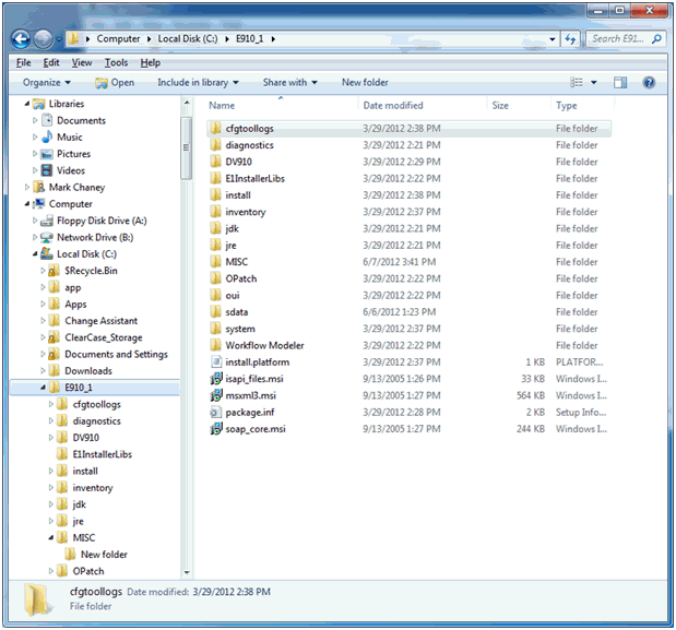

5.6.2.1 Examples of Healthy Environments
This section illustrates a healthy JD Edwards EnterpriseOne installation and saved snapshot directories and registry settings.
Surrounding text describes healthy_snap_dir.gif.
The preceding shows the installation directory of a healthy JD Edwards EnterpriseOne instance.
